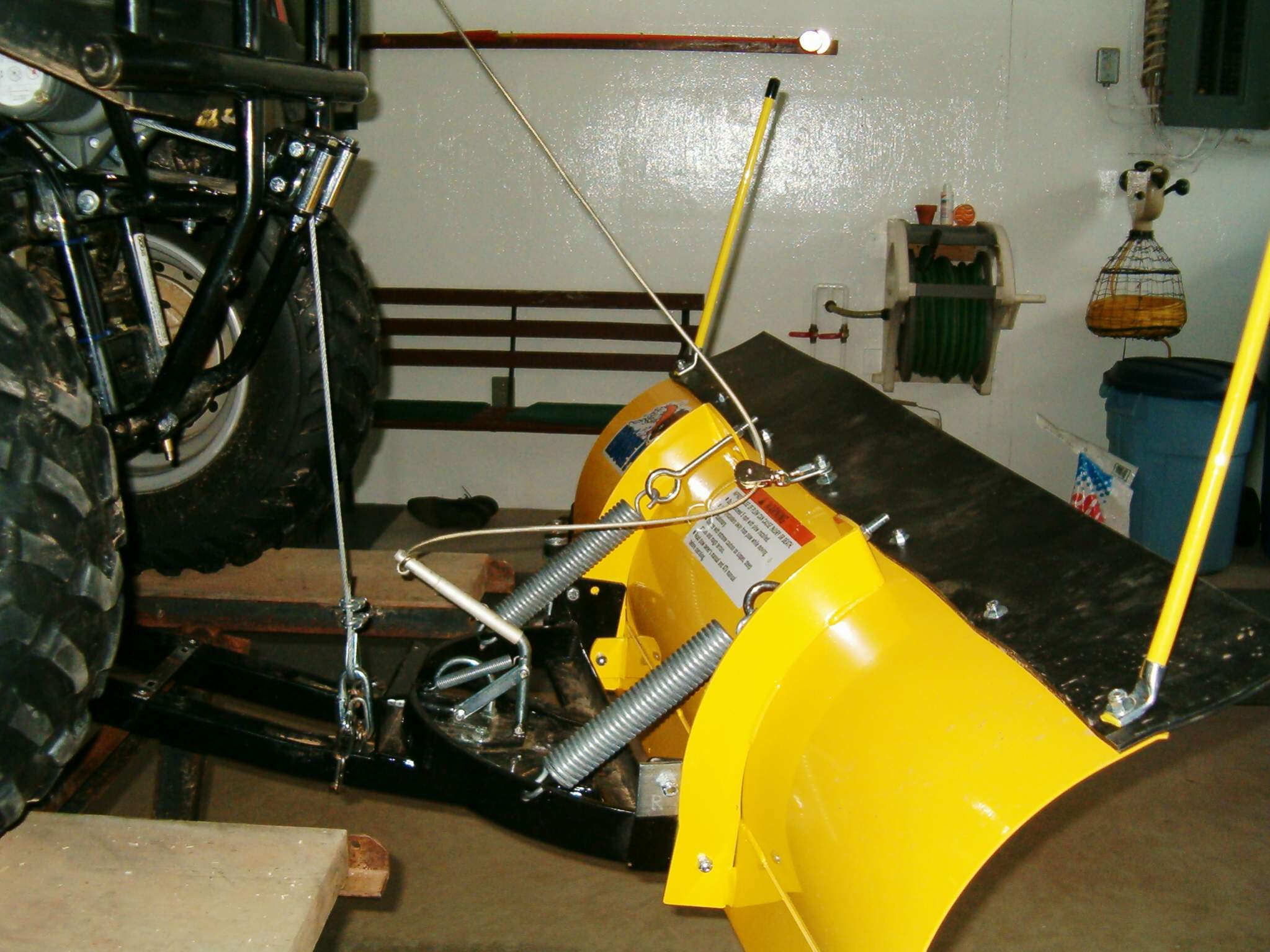

Yes I like that idea of a short cable. That 50' cable will soon get bunched up on the winch spool after a month of use. Then it binds on the cross bolts that hold the winch together making it very hard to get free. Been there done that.
That, or get a piece of heavy strap and use that in the winch (much like a boat trailer winch).
And here is a 2004 picture of my Honda 450 with a Moose snowplow. Rubber flap keeps snow from blowing back. And the extra cable you see is a clothesline cable used to remotely pull the locking pin so I could bump the corner of the plow against the snow bank to change the angle. Too lazy to get off and do it. ha ha ha

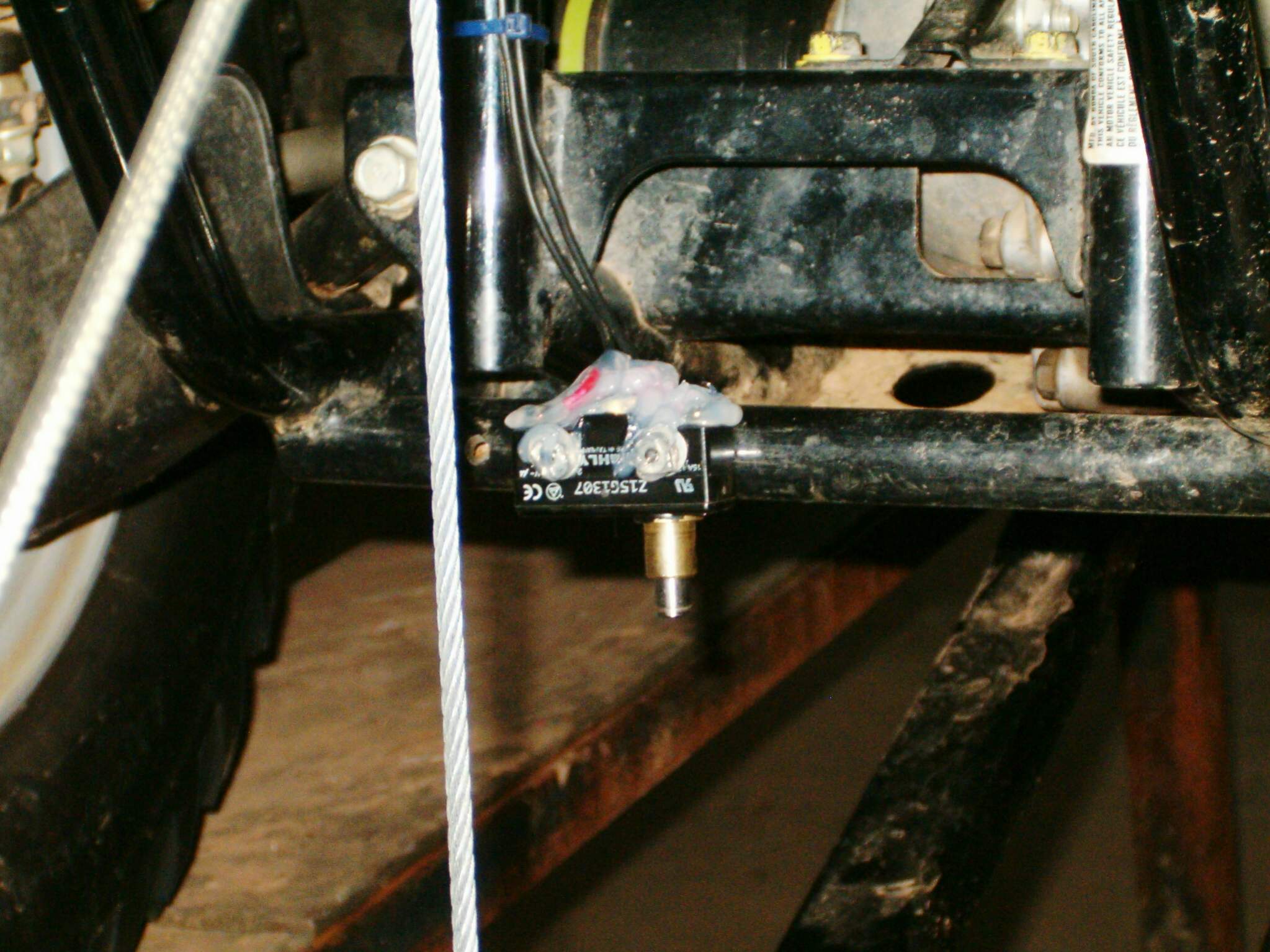

This switch cut the power to the lift side of the winch when the bar on the plow arm came into contact. I was bending winch mounting plates trying to lift the plow too high.
I may have to try those ideas if we end up putting a plow on the RTV...

Aaron, remember to leave extra clothesline if you go with the remote pivot locking pin. When the blade snaps forward after hitting an unmoveable object the line snaps forward as well. First time or tow it's a big surprise.
   / Warn plow conversion from ATV to RTV #23
Good point. That wouldn't be any fun.
You didn't have the locking-pin lanyard secured to your coffee mug did you?:laughing::laughing::laughing:
   / Warn plow conversion from ATV to RTV #25
No, but I had a sore hand. :D
