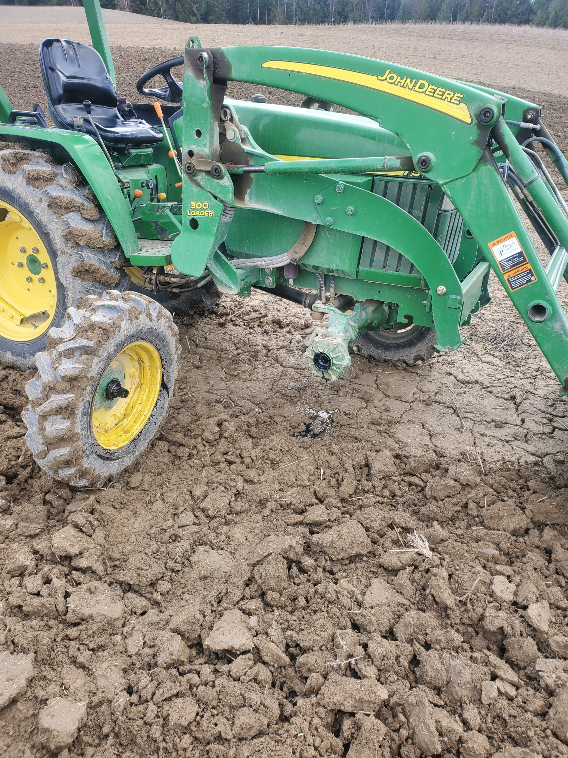

Was able to do some cultivating today. Weather was stellar, soil is getting workable on the flats but still pretty soft in the draws.
The 790 was pulling threw everything like a hot knife threw butter just a little tire spin threw the mucky draws. Then something happened....
It was my bad, I replaced the drive gears in both sides last fall. After 15 years of use the left side failed. I pressed off one of the bad gears from the 'shaft' or wheel flange and fouled up the groove of the snap ring on the splined 'shaft'... I re-used the shaft and that was not a good idea.

Sorry to see the "oops" on the Deere. At least, you know exactly what needs to be done.

The reviews of the 790 on this website indicate this is a common problem. Sad to hear.
This 790 made it 15 years. I was careful but used the heck out of it being it was my only tractor... lucky I guess.
Used full synthetic gear oil from the first change also, but the gears still lost teeth.
