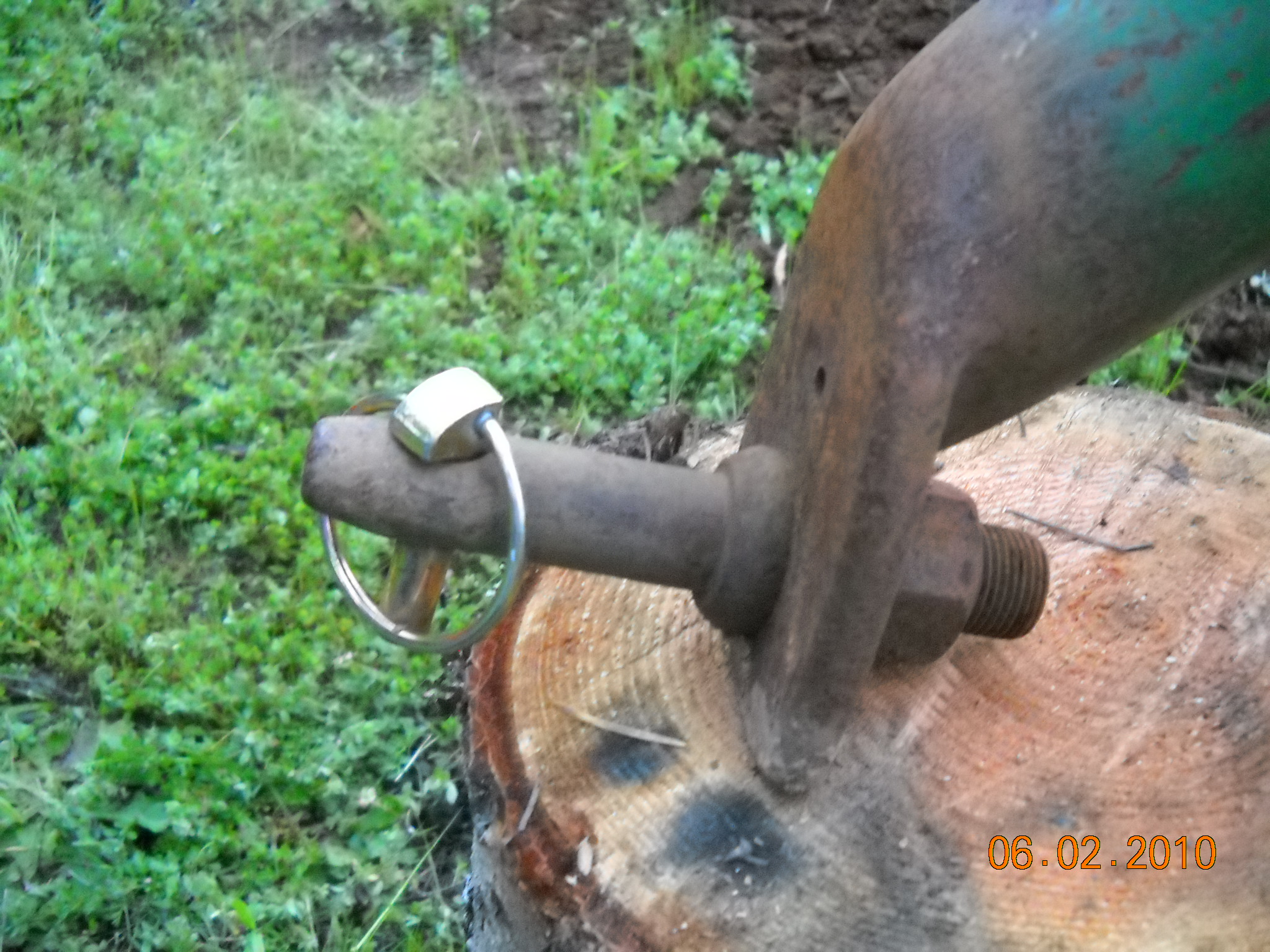

I have always used these pins for my implements. I ocassionally loose one on the lower lift arms holding them to the tractor since i mow in heavy brush but I usually restock whenever im down to 4. I use cotter pins for things like the pins that hold the teeth to the boxblade and for the top pins on the 3 point set ups. All i can say is it works for me.

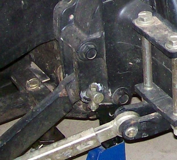

Early on, I lost some lynch pins to the brush devils. The potential unfortunate results of an implement dropping off on one side, or a lift arm dropping off, is inviting a broken casting (which is very expensive to fix).
Since going with a quick hitch (iMatch), I secure all pins with bolts and lock nuts. They won't snag and allow the arms to become disconnected. My Deere even had lynch pins where the 3 pt arms attach at the axle pivot points. No earthly reason for having them under there ( and I did lose one, but no broken castings).
This pic shows the bolt and lock nut, in place of the factory-supplied lynch pin.
