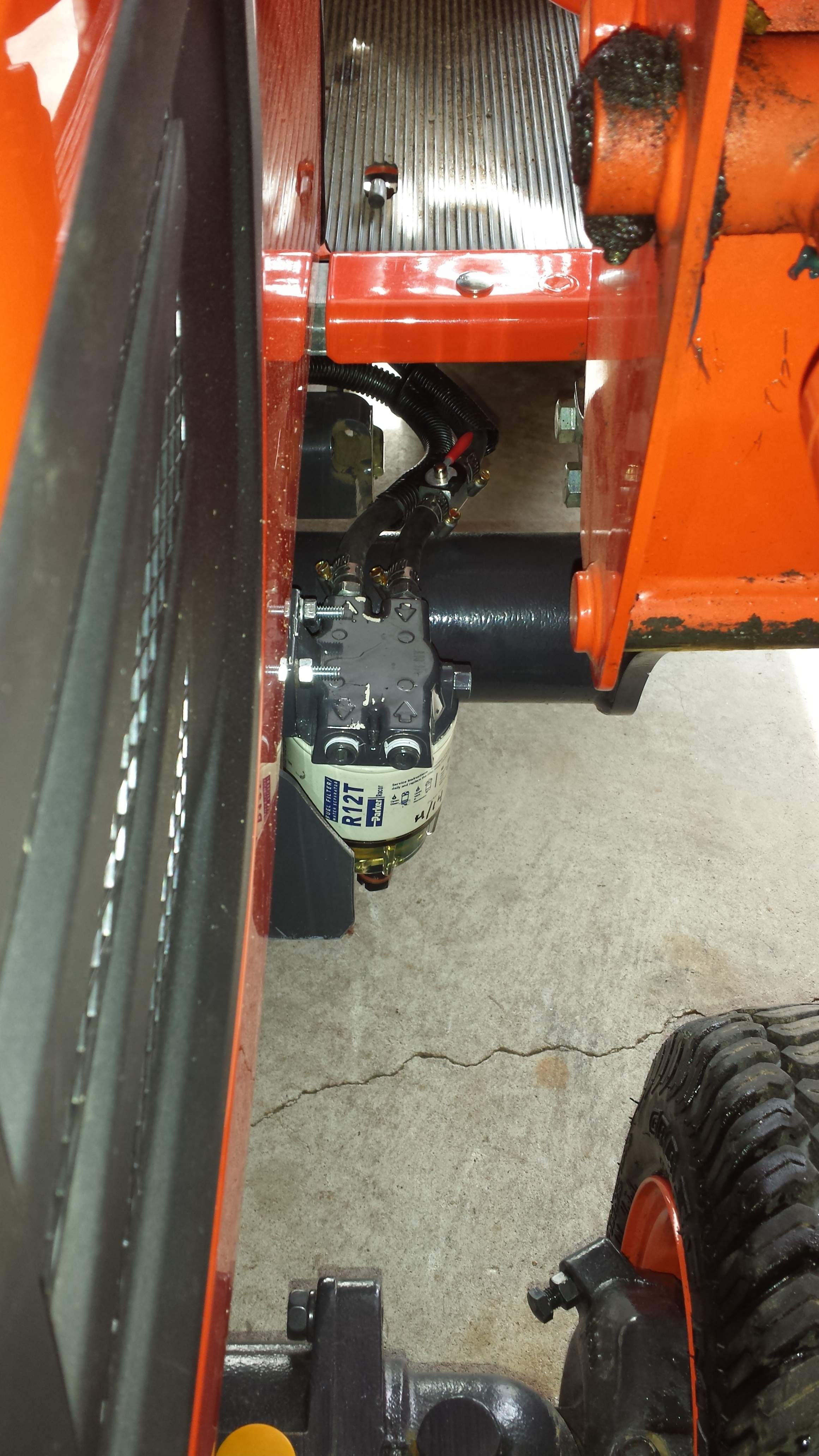

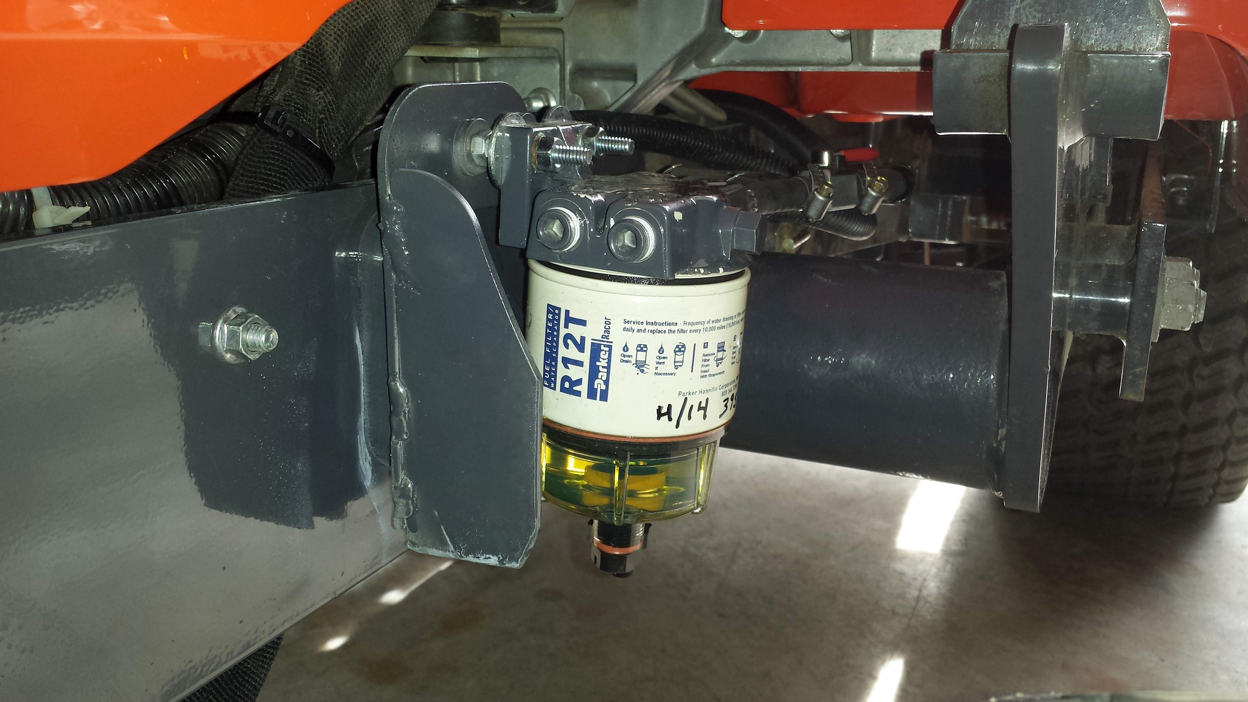

   / Was moving snow banks and then... #15
Your story is exactly why I replaced that first filter with a Racor water-separating filter in a location where I can see it and change it easily. Plus I added a fuel shut off valve to avoid the diesel shower - took one of those myself when replacing that first filter. Like Dodge Man said, do a search and you'll find one or two threads on how to make the change. Wasn't that hard and well worth it to avoid what you just went through.
