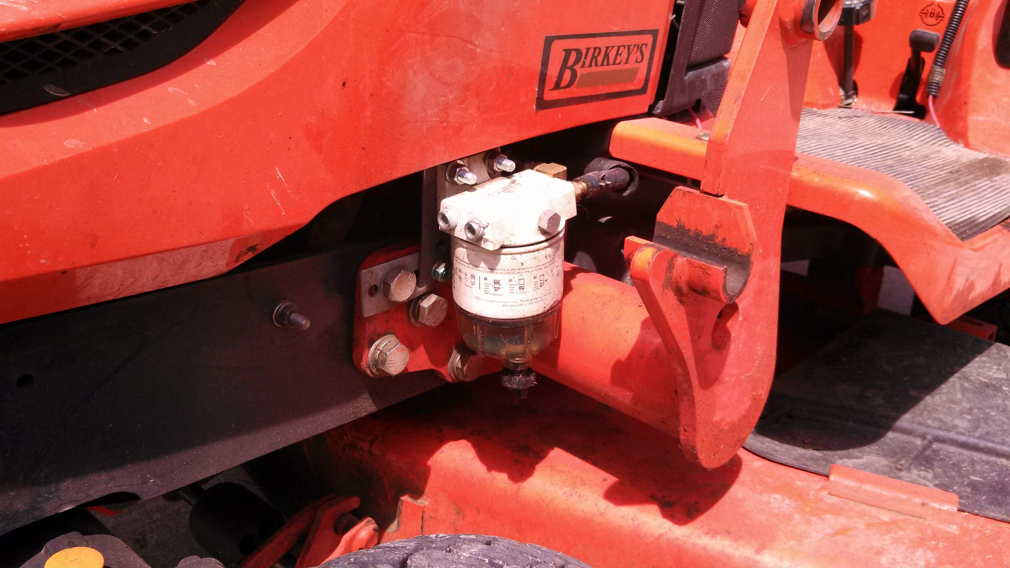

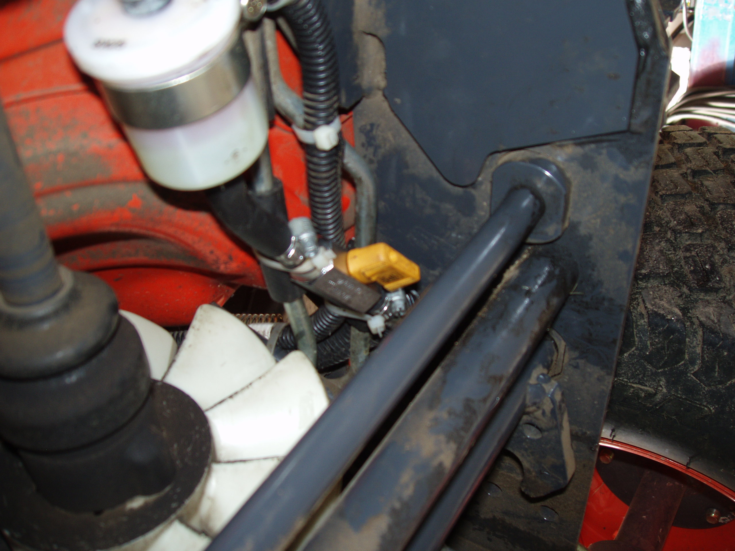

Your story is exactly why I replaced that first filter with a Racor water-separating filter in a location where I can see it and change it easily. Plus I added a fuel shut off valve to avoid the diesel shower - took one of those myself when replacing that first filter. Like Dodge Man said, do a search and you'll find one or two threads on how to make the change. Wasn't that hard and well worth it to avoid what you just went through.
Wish I knew how to fabricate! That would be a no brainer!

To the OP, as far as adding a different filter, I cant fabricate either very well but got it done. I used what is flat metal that has holes drilled in it about every inch or so. You can by the stuff at most hardware stores. I mounted it in about the same place as the pics someone posted. If I had a welder and could weld it would have been much easier. My problem is I mounted it in about 3 different places before I got it where the front wheel wouldn't hit it.
