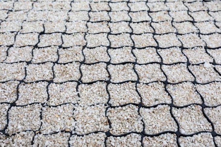

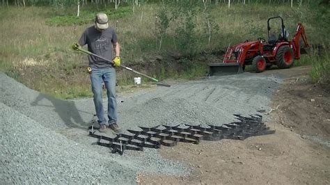

Got a box blade with rippers? Or a ripper bar? Then come back over it after several ripper passes with a straight blade at an angle.
On the Kubota forum, this guy laid down iron grates and then filled the gravel over it.
More solutions are like this. Mainly a flexible chain-link fence on the ground. It follows curves and can track well down or up slopes.
If you can not afford the grids to lay under the gravel, others have added a layer of black cinders. Once you drive for a few months with the cinders, a resin can be added over the top. This will make the cinders tightly strong like a 2-inch layer of concrete.
