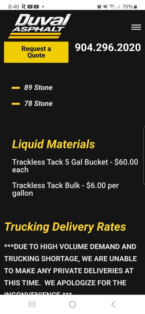

I did just look at a product called Gravel Lok, it's about $100/gallon, and it covers about 80-100 sq ft per gallon. No way is that a real option. We would be at about $15,000. You could probably have the entire 1500 ft drive chip sealed for less than that, or atleast in the same ball park, for a proven, widely used, good product
   / Washboarding on gravel drive #12
So, as an example, here is a North FLa based paving company/asphalt plant that Actually puts prices up. Now, as a background, Trackless Tack is more money than what I like, Special MS, a medium set, asphalt emulsion prime/tack. Track less has a wax additive to avoid tracking, so Special MS is actually cheaper, and can be diluted (Nebraska DOT did a study, showing that diluted prime, if applied with a heavier total Gal/SY did just as well, as less spread, higher concentration), would do a very good job of binding your gravel. The struggle is finding a company that does priming/tacking/chip seal. But $6/gal for a known product vs $100/gal for some magic in a bucket resin...
   / Washboarding on gravel drive #13
You could probably do something like a 0.15 gal/sy application of asphalt emulsion over your gravel (once graded), and sand the top, and be pretty happy with the results.
This would Not restrict you being able to Pave or chip seal later if desired. Some of the polymer/resin products May. Oil or diesel sprayed would certainly.
