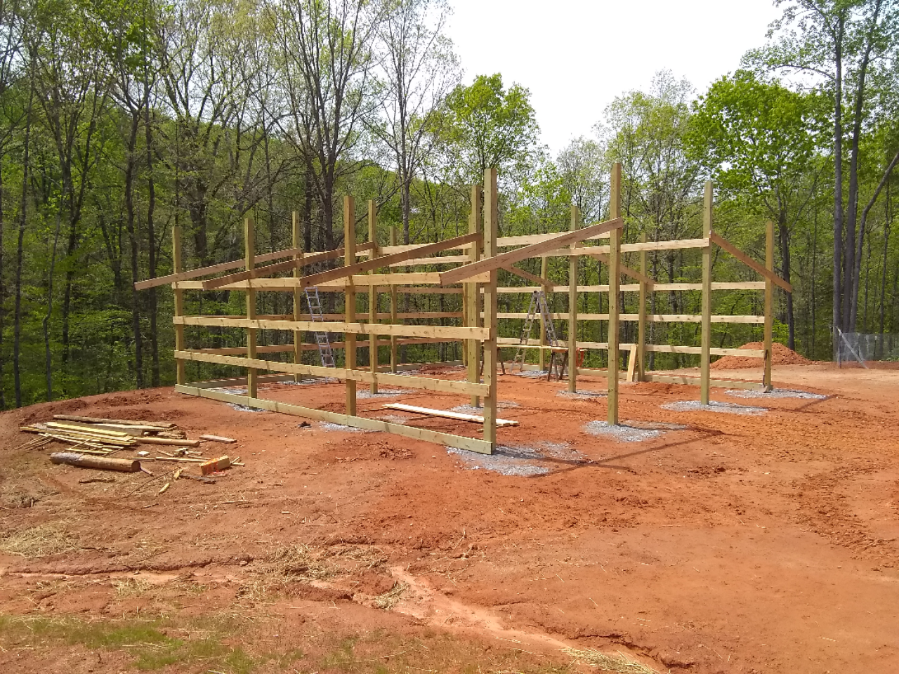

Gotcha, note that little detail that's just under the plate. I think their calling for a 2x6 vertically for basically more nailing or screwing opportunity to create an 1 1/2 bearing surface. That's in several locations, I'd recommend every post.
I still think that 5 perlins on those 9'6" walls @ 28.5 inches is the way I'd do it along with the diagonals from under the plate to the bottom of the next post in, nailed at every opportunity.

Yep, aware of the blocks.

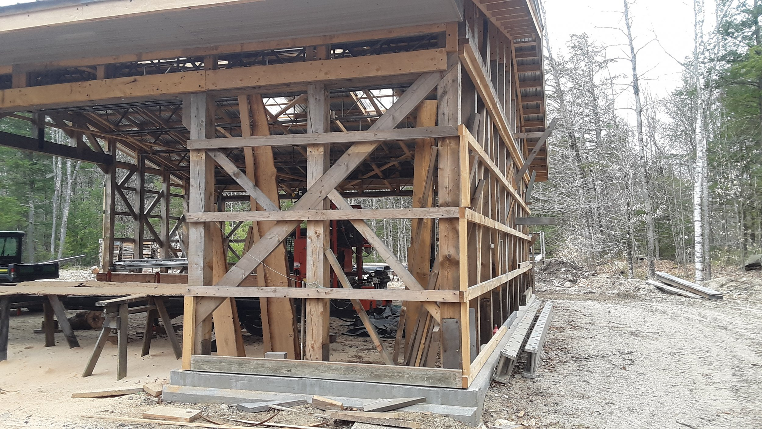

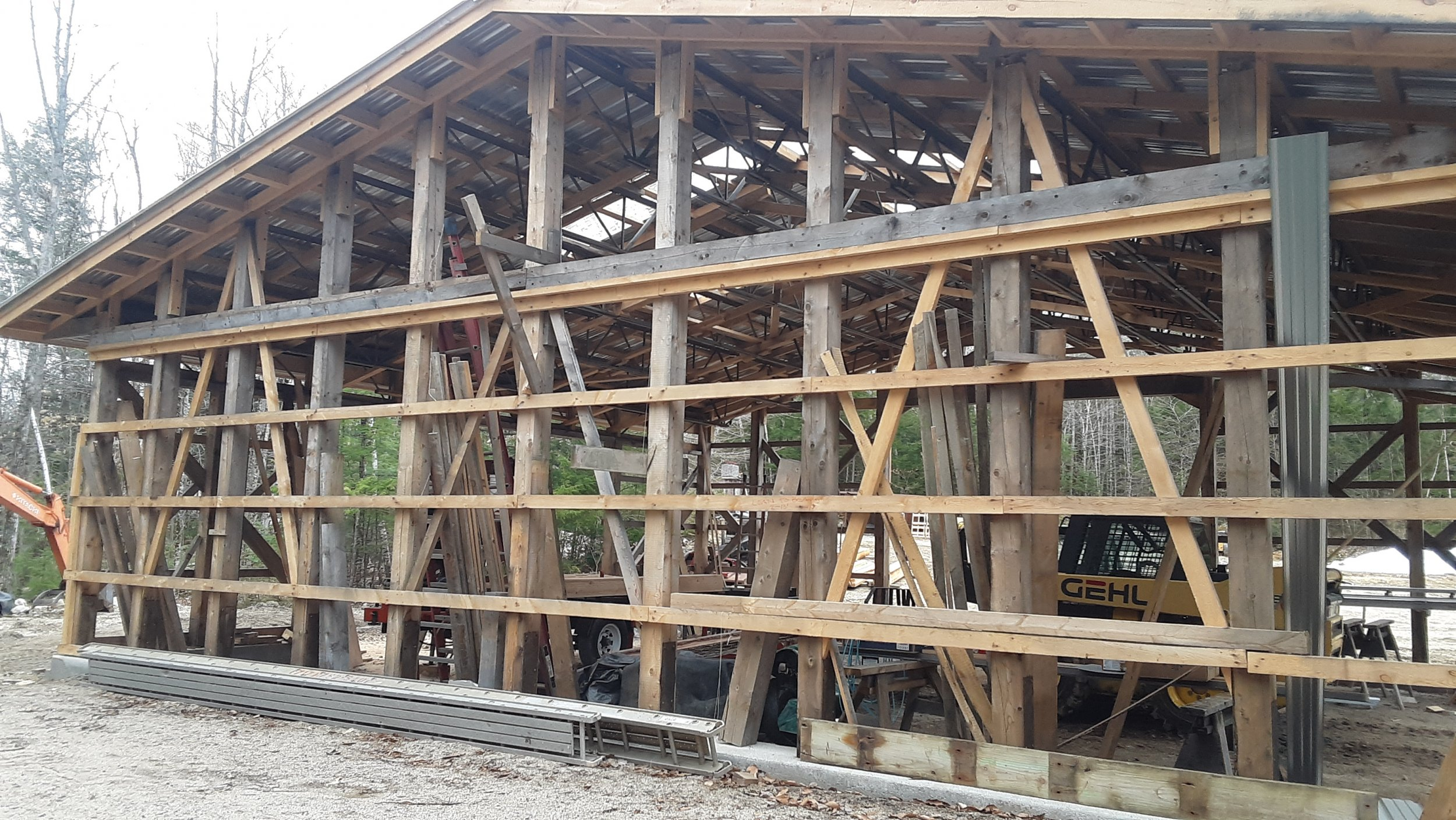

Standard for me is 2x4 wall girts 24" on center. Works well for both metal and wood siding. No need to go with wider girts really. The structural benefits of girts is having them create a grid structure spread over the wall, so you want as many girts as is feasible. I also run a diagonal 2x4 between posts and that gets nailed into the posts and the girts. Results in very good shear strength in the wall.
I have used 2x6 for the skirt board, but find 2x8 is a better size overall.

I think some of your terminology is different from mine. If I understand you, your "plate" is basically a tall wall girt or purl in and you'll have 2, one outside and the other inside. This is in effect the beam for the trusses. These sound small, are you using some type of "kit"?
As for the wall girts/purlins, I'd use something between 24"-32". Basically a length in that area that gives you a even nailing pattern for the siding. (Divide the wall height by X to get it in that 24-32" range. These are important beyond just holding the siding on and actually helping to "rack" the building and attach an actual diagonal brace to.
You need to visually separate all the other Lumber in these pictures, but look for the diagonals. VERY important to have at both sides of every corner if possible.
What's your post spacing and how long are the trusses?
Poured concrete foundation? Like it!
