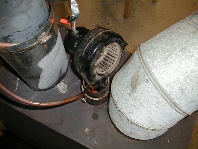

I found a old small fan, ran it on low speed and just put it in my air intake. Made a major differance in heat output and cleaner burn. photos attached show its results in stove. Can open stove with no smoke coming out. This is a draft induced burner. Will do some fabricating this week to make it look better. Also need to beaf up burner with thicker material.
Will keep everyone informed.

   / Waste oil furnaces #14
Here is one with the fan, sorry about the first photo, forgot to turn it.

ealasimi:
The squirrel cage on that blower looks like it came from our house, full of lint and possibly cat hair.
I am following this thread closely.

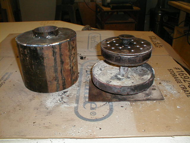

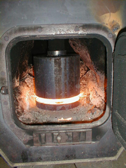

Here are some pics of my new burner. I used 8 inch steel pipe with a steel plate welded on top to make the funnel/cover. In place of the cast iron pans I made a dish out of 6 inch pipe with a plate welded to it. I drilled 3/8 holes in it instead of 1/4 inch. Below that is the 1 inch spacer and another plate as per the MEN plan. The bottom is a ring of 8 inch pipe and bottom plate to replace the bottom fry pan. The second pic is of the burner in the stove with oil starting to burn. I still have the fan in the intake. Tried it out, seems to burn much cleaner and have no visable smoke. Most of the combustion seems to be contained inside the cover. This is probably the reason for the lack of smoke. Heat output is very good, will try it for the weekend.

Here is the pic of the burner in stove.

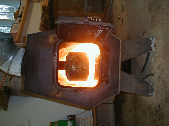

I have been using the new burner for about two weeks. By added the fan, the stove is producing much better heat. I replaced the steel pipe cover with a half of a freon tank as I had before. The steel pipe worked ok, but it was to heavy to move up and down when I needed to clean burner. I have built two extra burners, these should last me for the next two winters. I have no smoke coming from the chimney with the fan running. The inside of the stove and chimney are staying cleaner also with the fan running. I am using more oil when the fan was not installed, but I am producing much more heat. It has not been real cold (20 degrees), yet but I am having no problem getting my shop to 75 degrees. I have needed to shut down the stove because of over heating. The photo attached is showing the fan attached to the intake.
