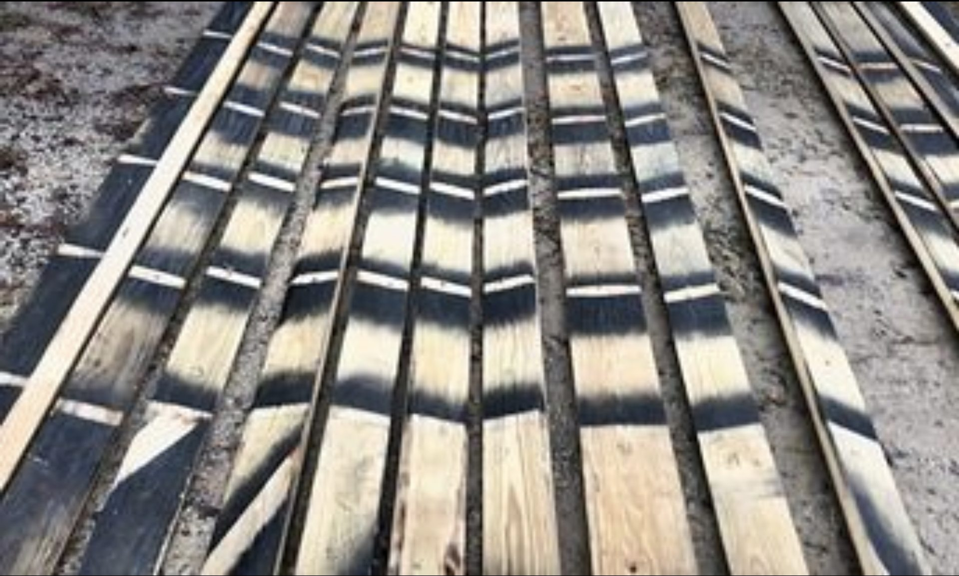

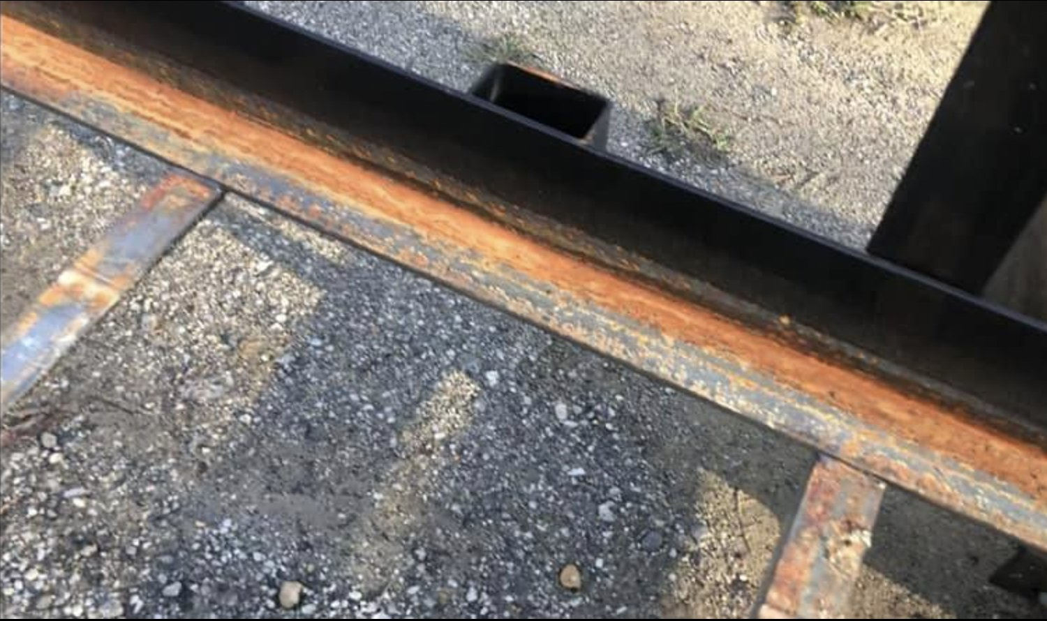

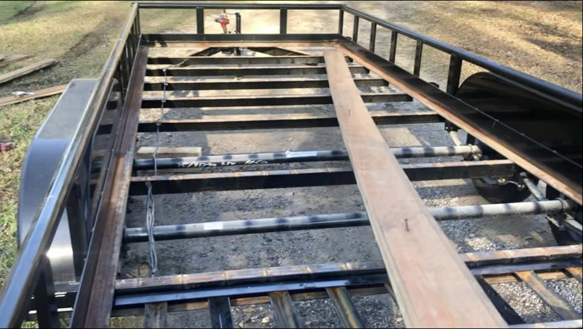

The steel framing and welds under the wood were not painted. Wood was not pressure treated. I removed the wood and corrected both issues. Video of me removing the wood to correct these issues was made and will be coming soon, but here are a few photos of the rust on a brand new trailer that was just 2 days old. Glad I noticed it before it had time to get worse.
Rust on the trailer under more visible after wood removed.
Rust surrounds the entire frame, on top of welds, including the hitch area.
Underside of wood shows white interior grade untreated pine...that was spayed only on the topside with a non-penetrating spray that apparently only made it appear similar to pressure treated wood.

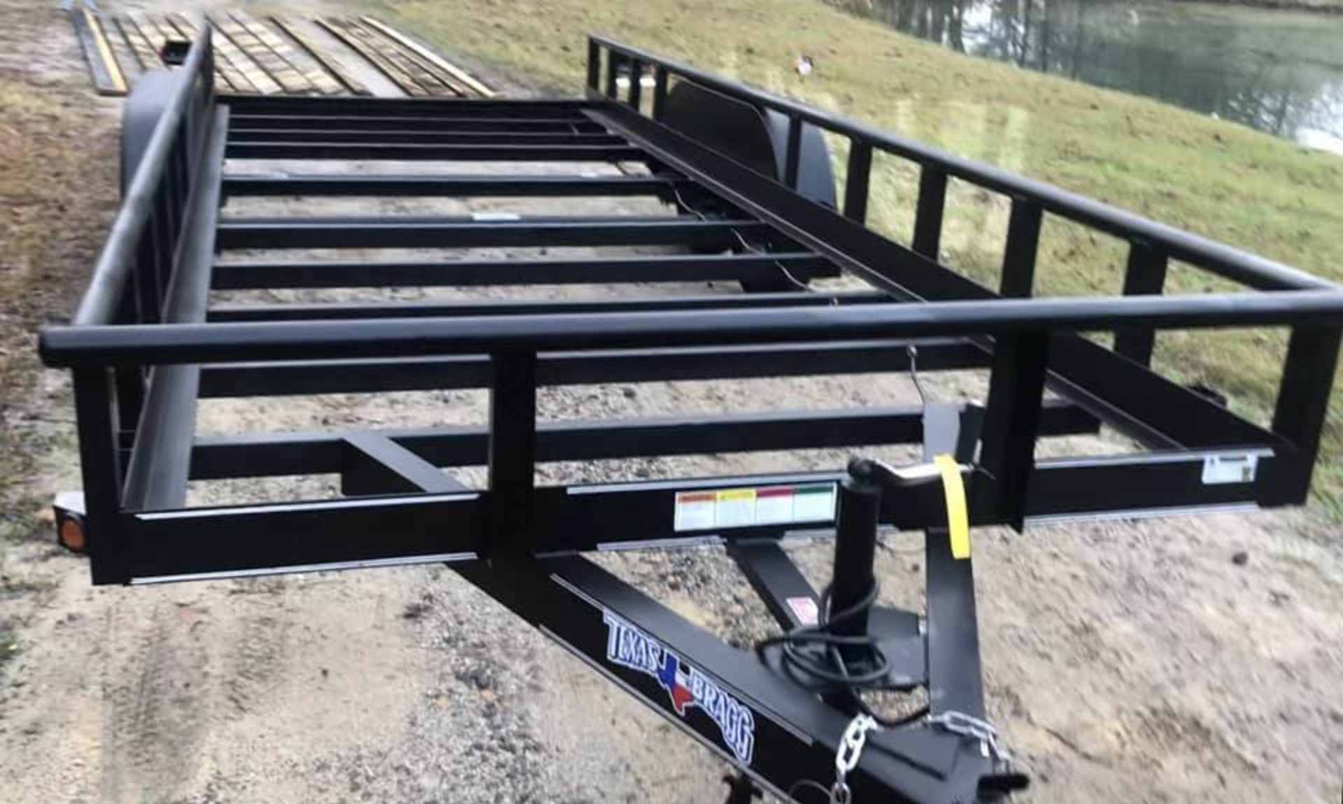

AFTER PAINTING IT...
After treating the wood with a diesel/oil mixture with three heavy coatings sprayed on both the top and bottom.
Hopefully this wood treatment will last as well as actual pressure treated lumber.
After correcting the issues, I imagine it will last fine now...but never-the-less, I will never purchase another Texas Bragg trailer. I was very happy with my Top Hat trailer, but unfortunately sold it years ago before buying my current compact tractor.

I made a mistake and assumed people gave a crap to do things right...it was a trailer, not a complex item...and it was raining and honestly...I never assumed someone would manufacture a trailer for external use that wasn't painted or used untreated wood. My fault for assuming people still cared to do right. lol
Texas Bragg is a popular brand around here so I just assumed it was a quality brand. After seeing this unpainted steel, I couldn't believe it. Then I noticed the wood had no real treatment either but was shot with some superficial spray on the top that didn't penetrate even a 1/16" (when a splinter came off while removing a screw, it was white untreated pine under).
SO I hope the diesel x oil blend works. I used three heavy coats and will spray that again a few more times if it will help.
I couldn't believe standards were low enough for a company so well known to not put basic paint on the framing and welds. Glad I caught it on day 2.
