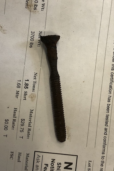

When I re-decked a trailer a couple of years ago, whatever paint had been on the frame in contact with the pressure treated wood was in poor shape. I had to sand it off, then apply rust converter, then brush on some oily metal paint. For good measure, I laid down strips of roofing felt under the new lumber where it rested on the frame.
By the way, this is what the trailer decking screws looked like after about 8 years, from contact with treated lumber:

I think they should use ceramic coated or SS screws

One should use appropriately treated screws as well. They are cheap considering a trailer only has a few dozen of them in it.
