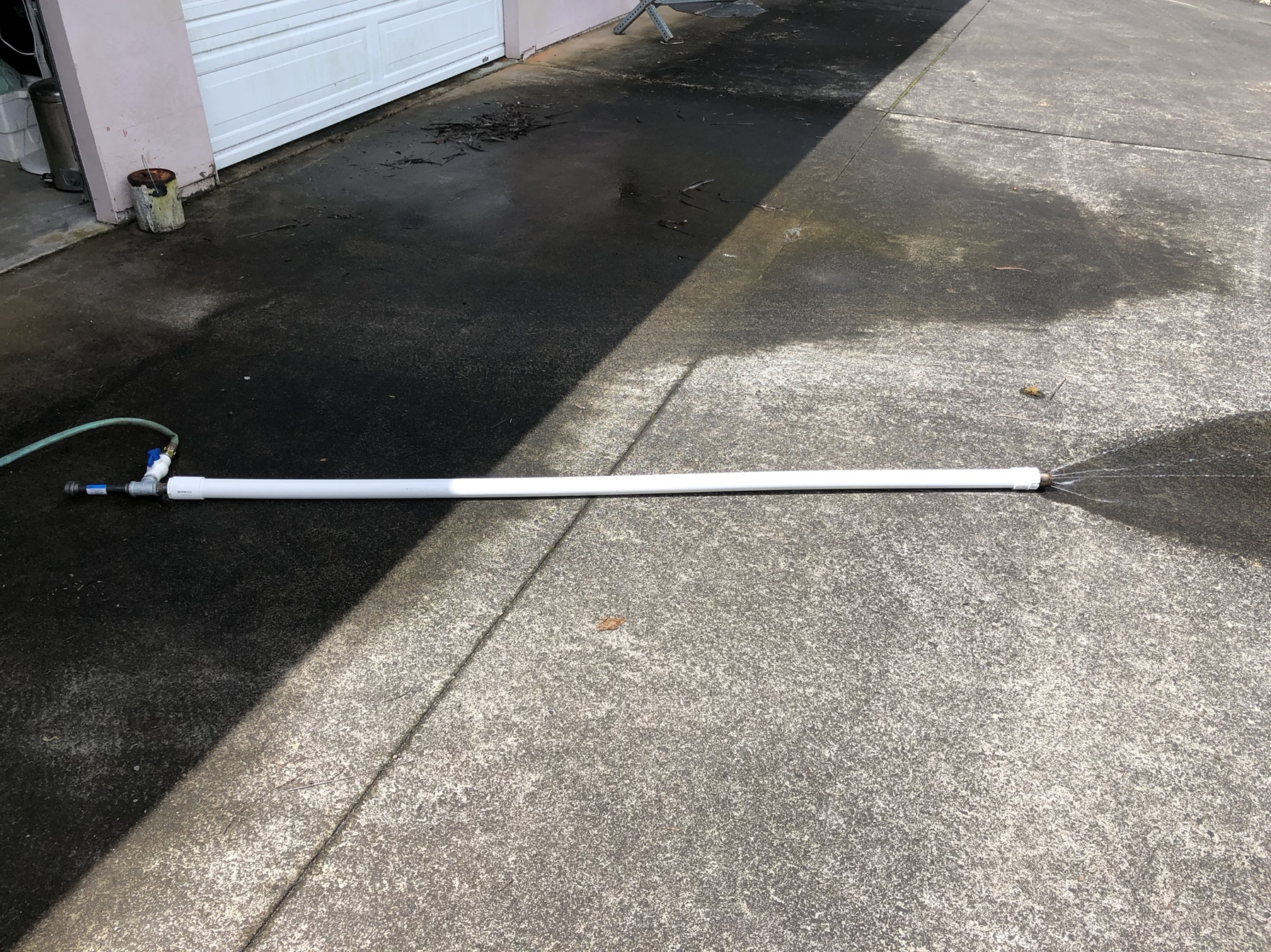

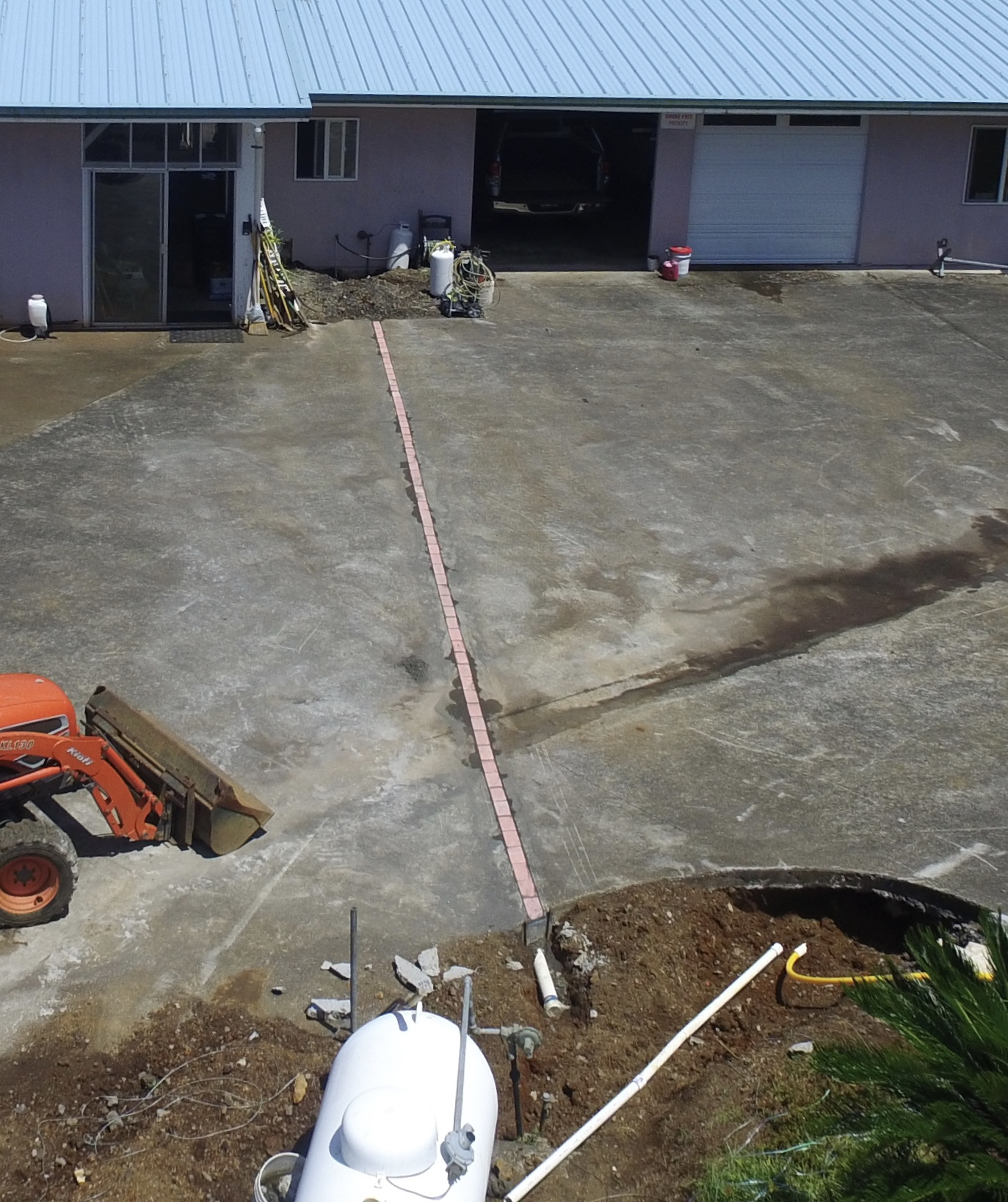

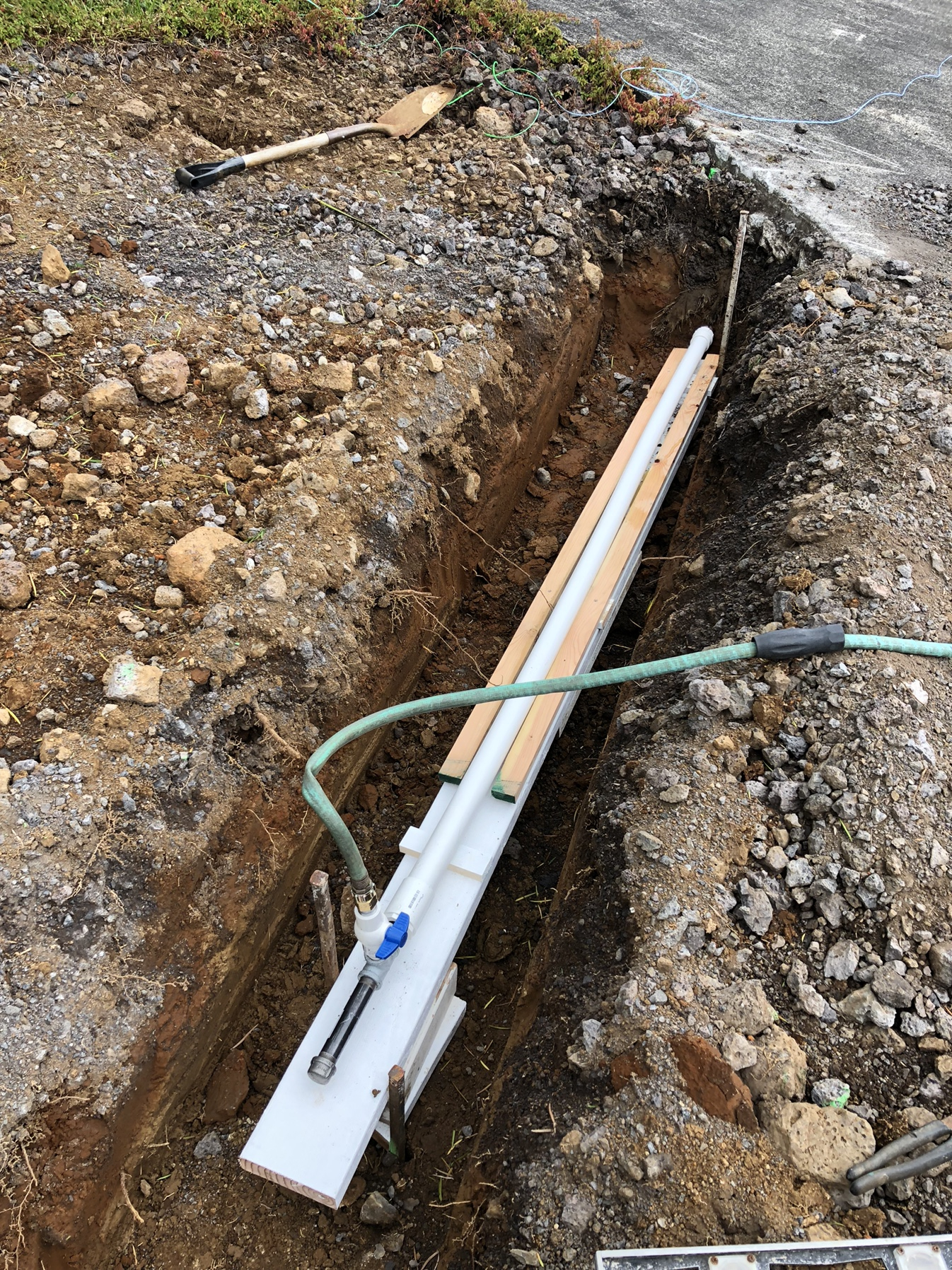

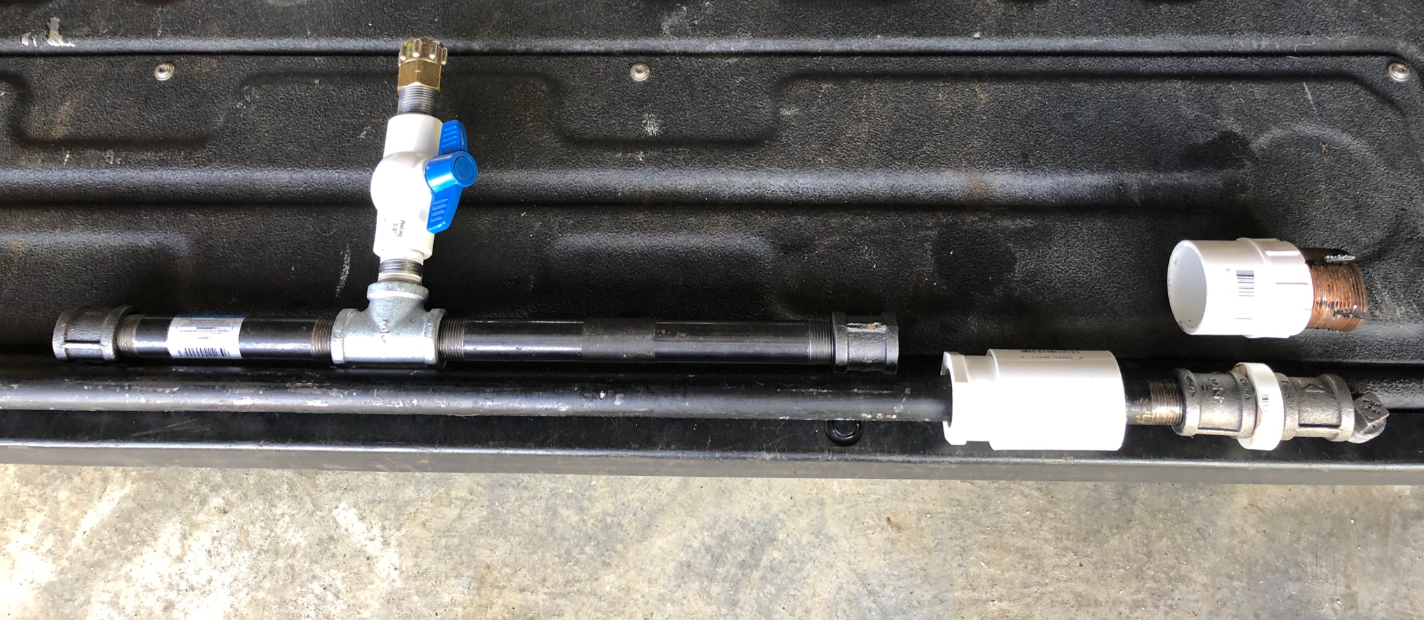

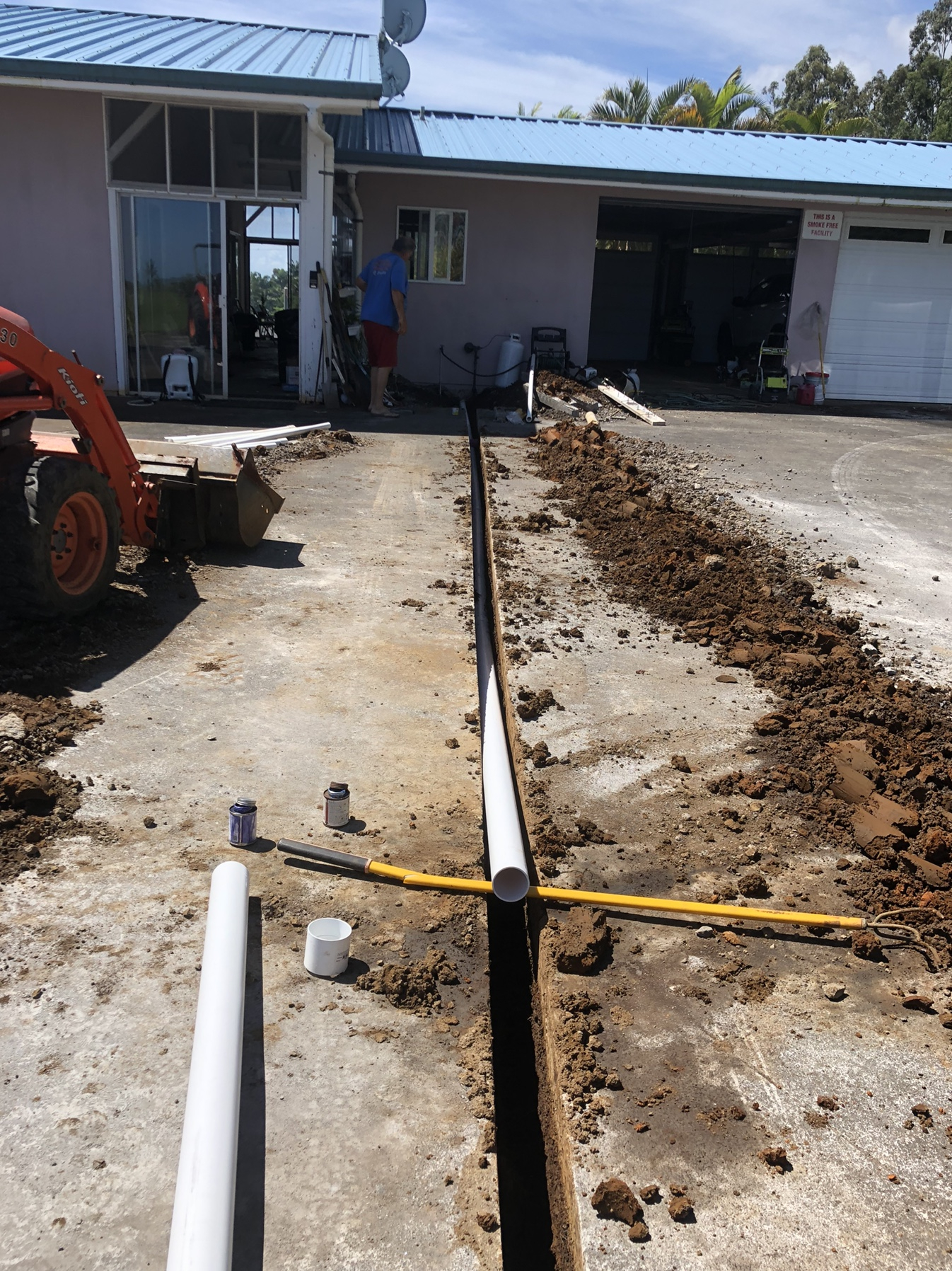

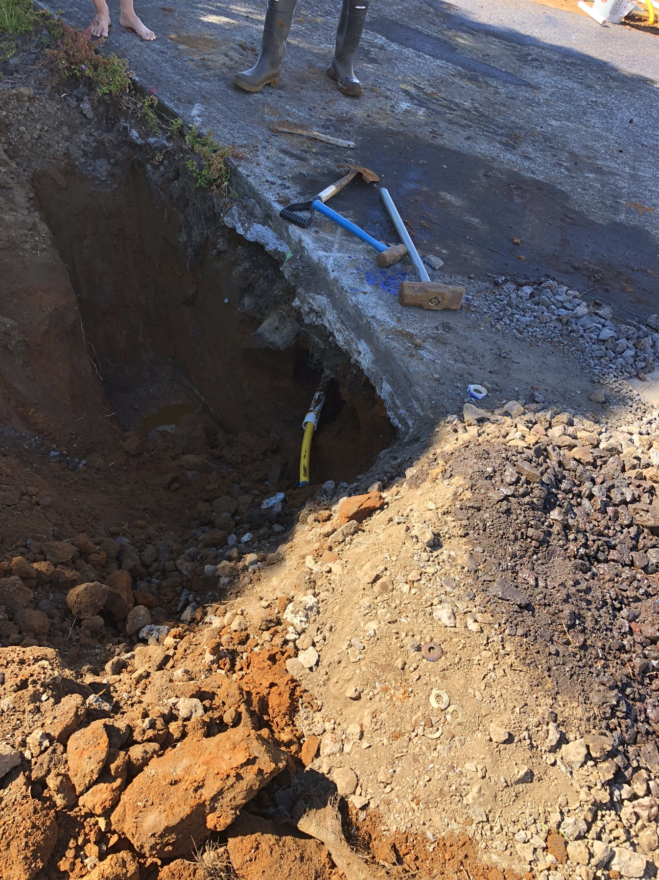

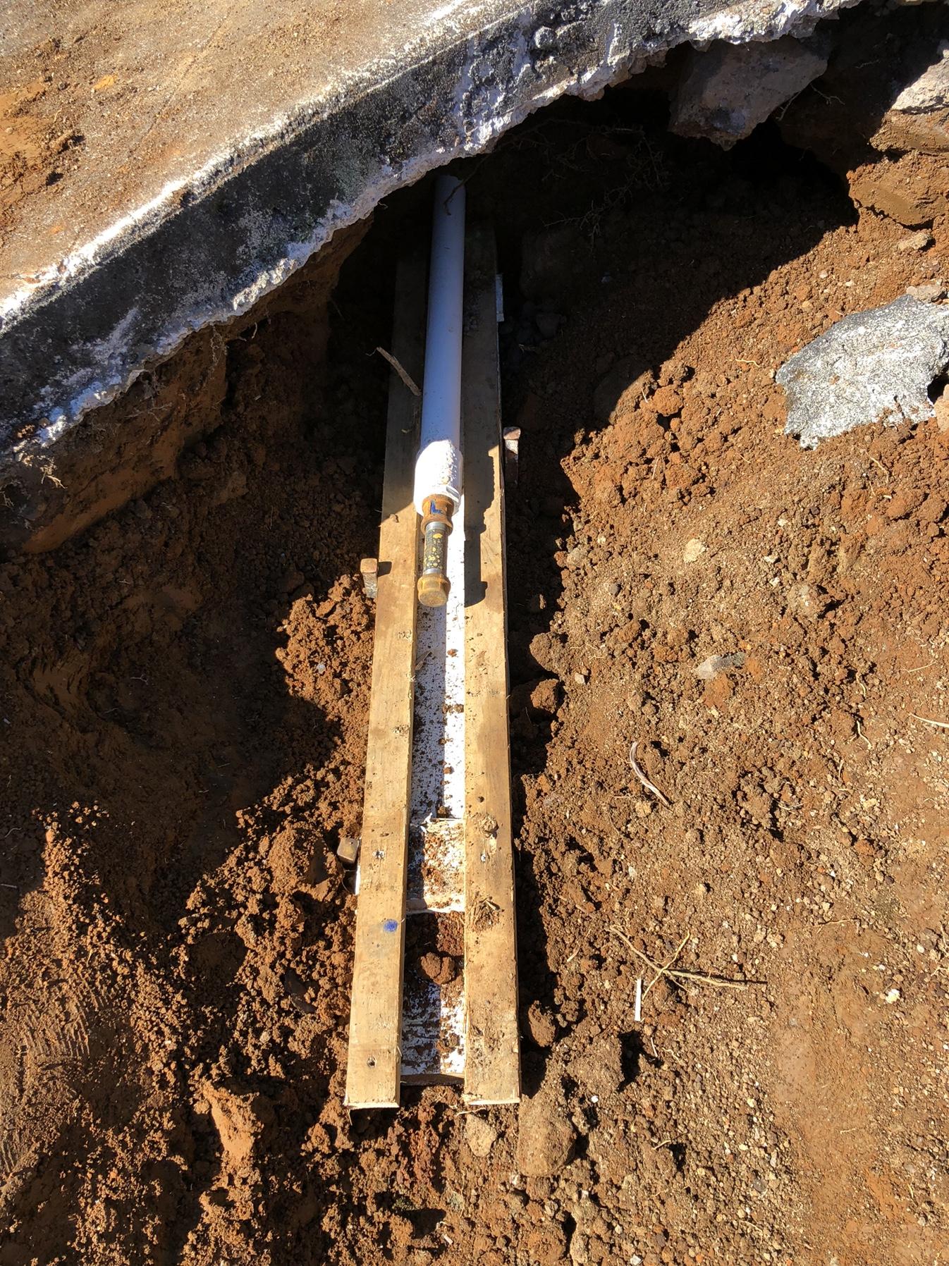

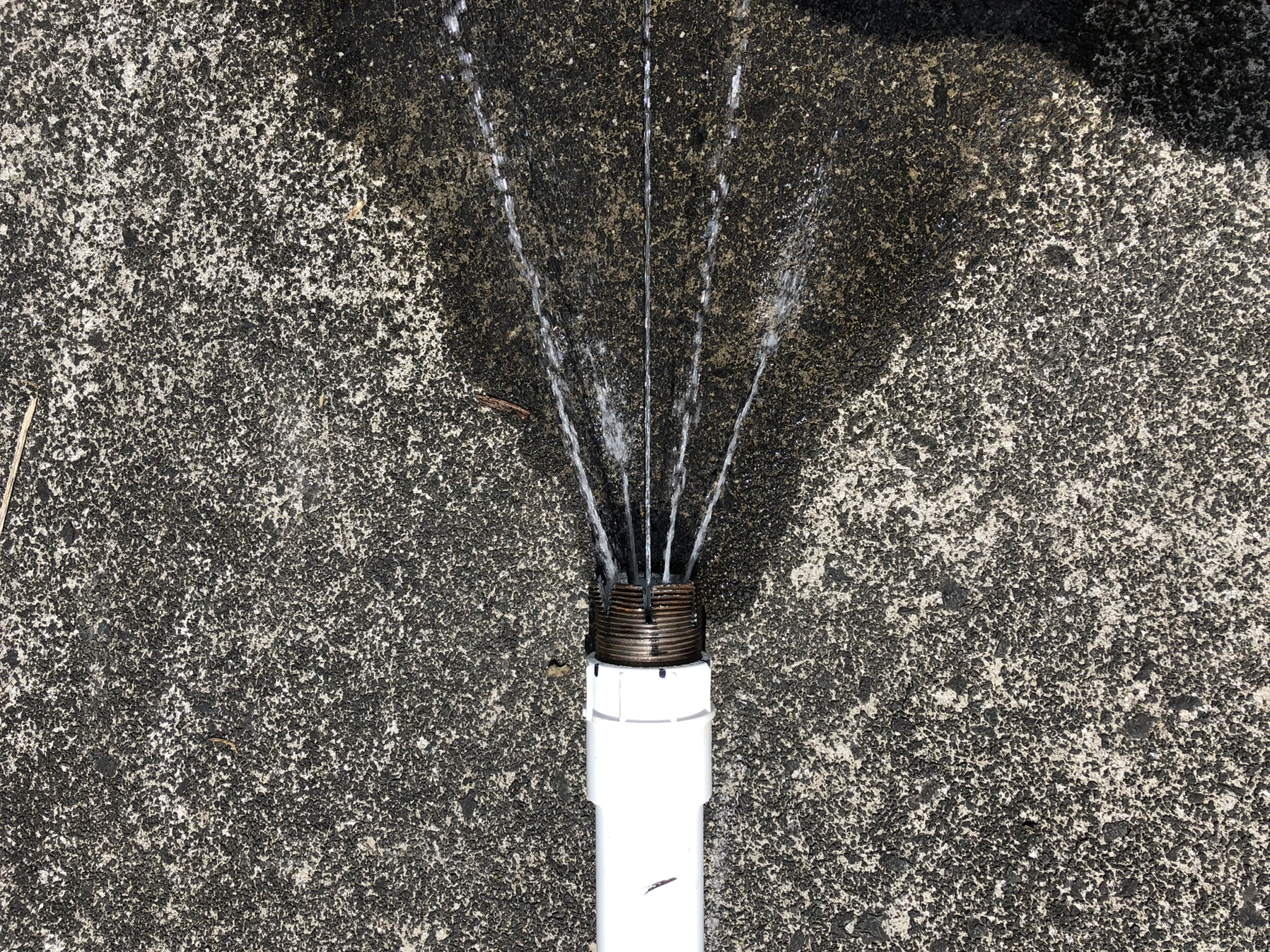

If you look at my pic going under drive you’ll see I used 3/4 pipe inside the 1 1/2 pvc. The white 2x was a sled to attempt at maintaining direction and level. While I did start using a hammer to drive, I found using the backhoe to pull worked quite well. When finished, I put an eye on the iron pipe to extract.
Note. I wasn’t entirely successful and made several attempts. One that almost worked was using a nozzle on one end and a fitting before the hammer end that allowed me to hook up my hose. This worked well except the tool apparently took a dive as I could never find the end even though I was beyond distance required.
The BH method was my last, but I did without the water.
Here are some pics
Strange, app wouldn’t allow me to include in this post and not access more than 1, so had to post individually. Hope someone in charge notices.
I’m thinking a 4ft section might be fun.
Maybe you could use 1/2 pipe, but it might require 1 1/14 pvc then connect your 1 inch with adapters.

/ water drill #28
Basics
Homemade nozzle
/ water drill #29
Homemade nozzle
/ water drill #31
In place
I don’t have a pic with the 5ft extension that allowed me to get full distance. Might have found the end had I kept digging, but was concerned I didnt want to disturb under the driveway too much. This is also the good possibility I miss calculated the angle.
