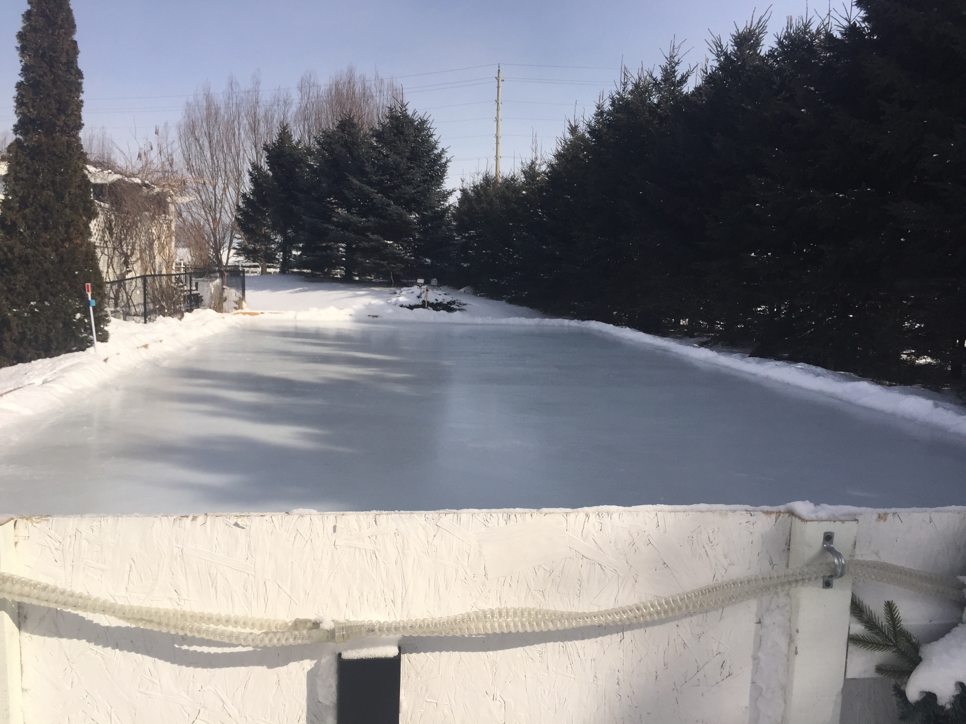

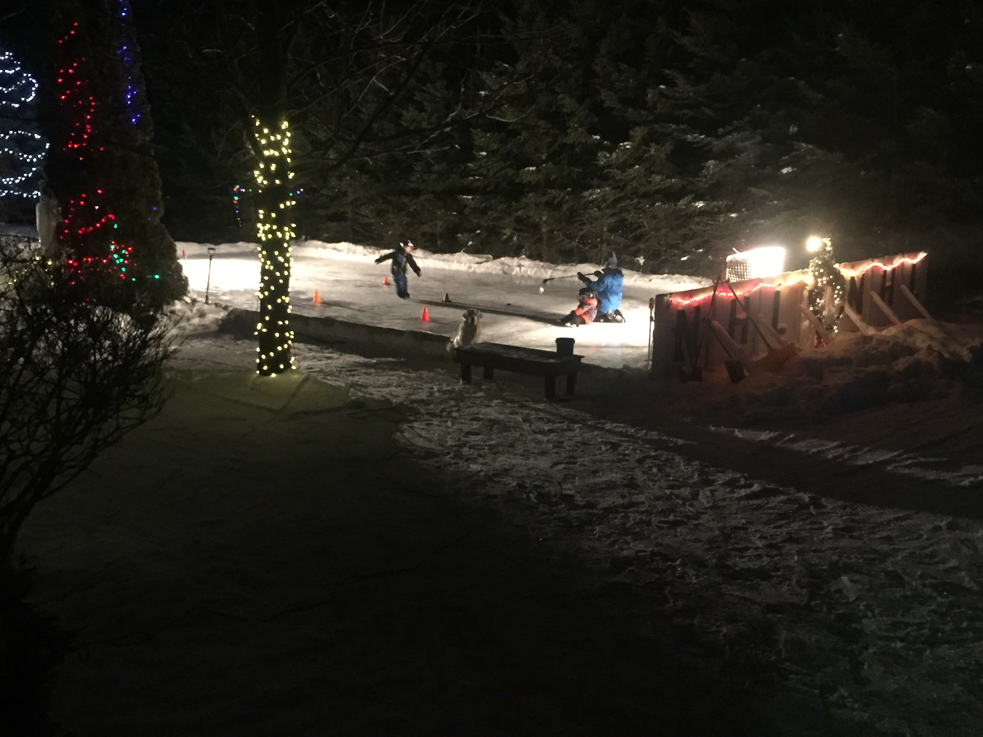

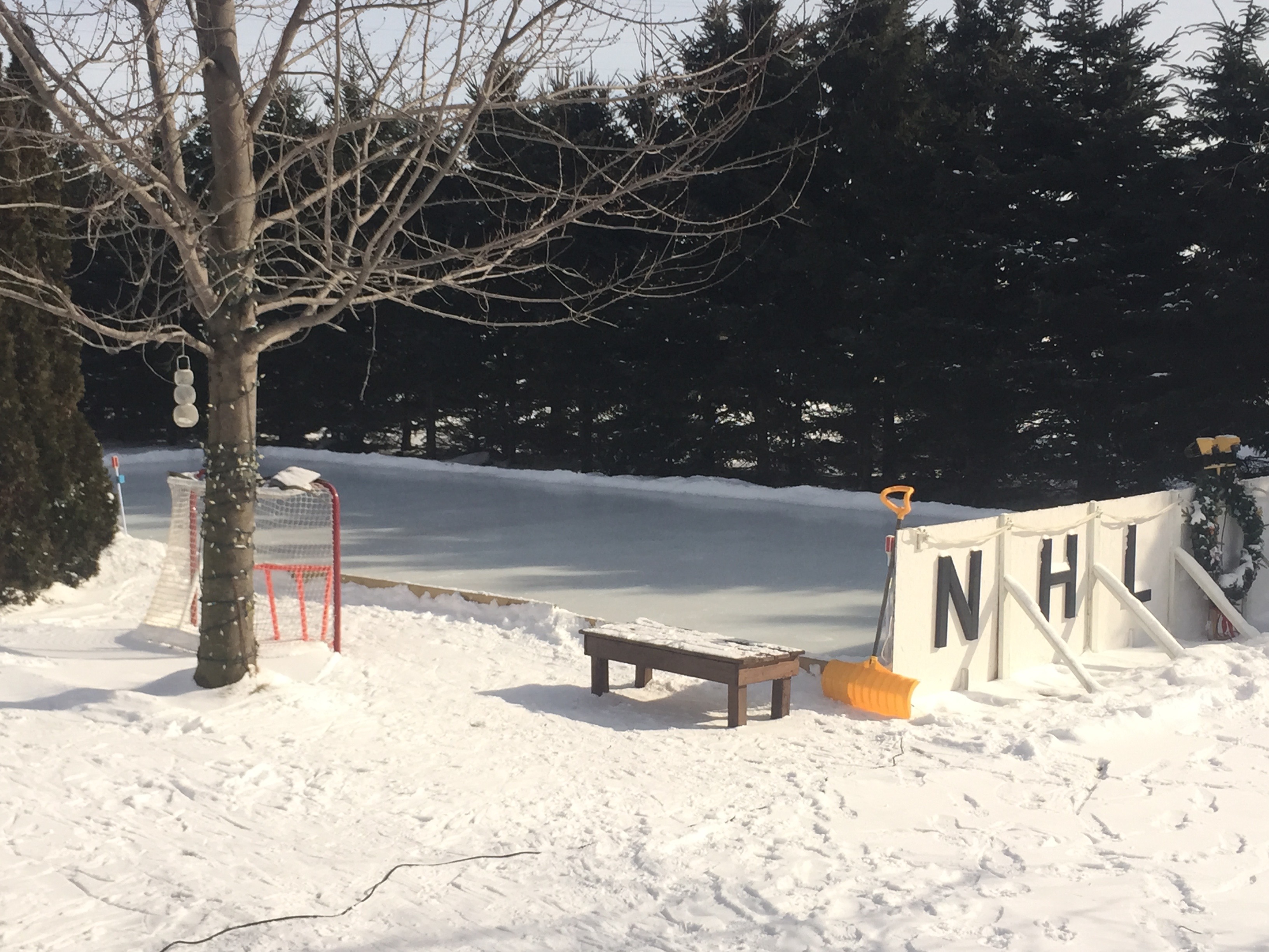

I usually set up at 30x60 rink using tarps and using 2x10 as the boards. Right now I am using multiple garden hoses. Some of the ones that expand to get to the rink now. The initial fill does take some time, but I use the hoses for that. I was looking at more of the resurfacing idea. I connect it to a PVC pipe with a towel on the end which smooths the ice out.
The hoses are the pain though, especially if I would like to make the rink larger and move it away from the house. There would be a significant amount of trenching that would need to occur around trees in order to get out there. There is no power out there either if I move it. I could however solve that by using the PTO generator.
Thanks for the suggestions

Wow, those are great pictures gogojuice. I had a rink when the kids were young and we had many great days and nights out there. Ours was 75 feet from the house so I used a hose run into the basement spigot for warm days on weekends. The hose always came back inside. During the week while they were in school it did not get beat up to bad. On those nights I would fill a hand pump sprayer with hot water and do touch up only. The hot water acted as a force multiplier as is melted some choppy ice as it went down adding more water to the equation. The rink lasted maybe four years. After that the beavers came in and built us a pond right on the edge of the property.
