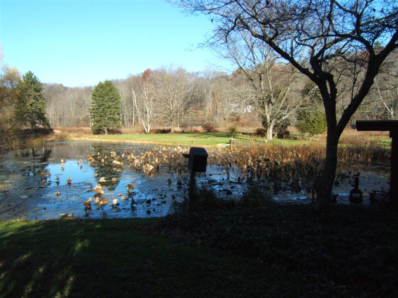

I was thinking about koi or goldfish to control lotus that have taken over my pond. Just pulling them up doesn't seem to work. (Massachusetts doesn't allow grasscarp.) Think they'd adapt to this half acre pond? Thats the desicated lotus sticking up ut of the water.

Koi would thrive in that pond. My dad started out with five 8" inch Koi. Within 5 years those 5 were 30" and there were hundreds of smaller Koi of all sizes
   / Water Garden/Coi Pond #18
Koi wont have any effect on you plants because you have a dirt bottom. Unlike an ornamental pond with a liner, the fish have the entire pond bottom to tear up, not just a pot that holds a plant.
Lotus drop thousands of seeds and once established will require poison to get rid of. You don't just poison the pond, but you have to get the plants at a certain time of the year. I'm guessing spring, but I'm not positive. Nor do I know the names of effective poisons.
Another more expensive and dificult solution is to drain the pond and remove the bottom foot or two of soil. You have to either kill the plants, or remove them and there seeds.
Good luck,
Eddie
