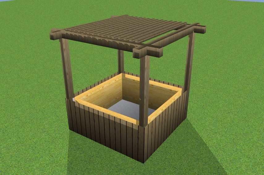

I plan to try my hand at koi next year. But my pond is much less ambitious than yours.
It's just a box with inside dimensions 7'x7'x3' deep (about 2000 gallons) framed using 2x6 redwood. Inner walls are 3/4" P.T. plywood, outer wall is redwood planking with foam insulation between.
It has a 5'x5'x18" deep hole centered on the box with a bottom drain installed. I'll use a butyl liner and hide the edges with trim boards. It'll have a simple pergola to shade the fishies and provide attach points for netting to keep the predatory waterfowl away.

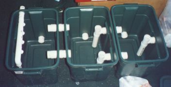

There's a simple 3-chamber filter design on KoiKorner
