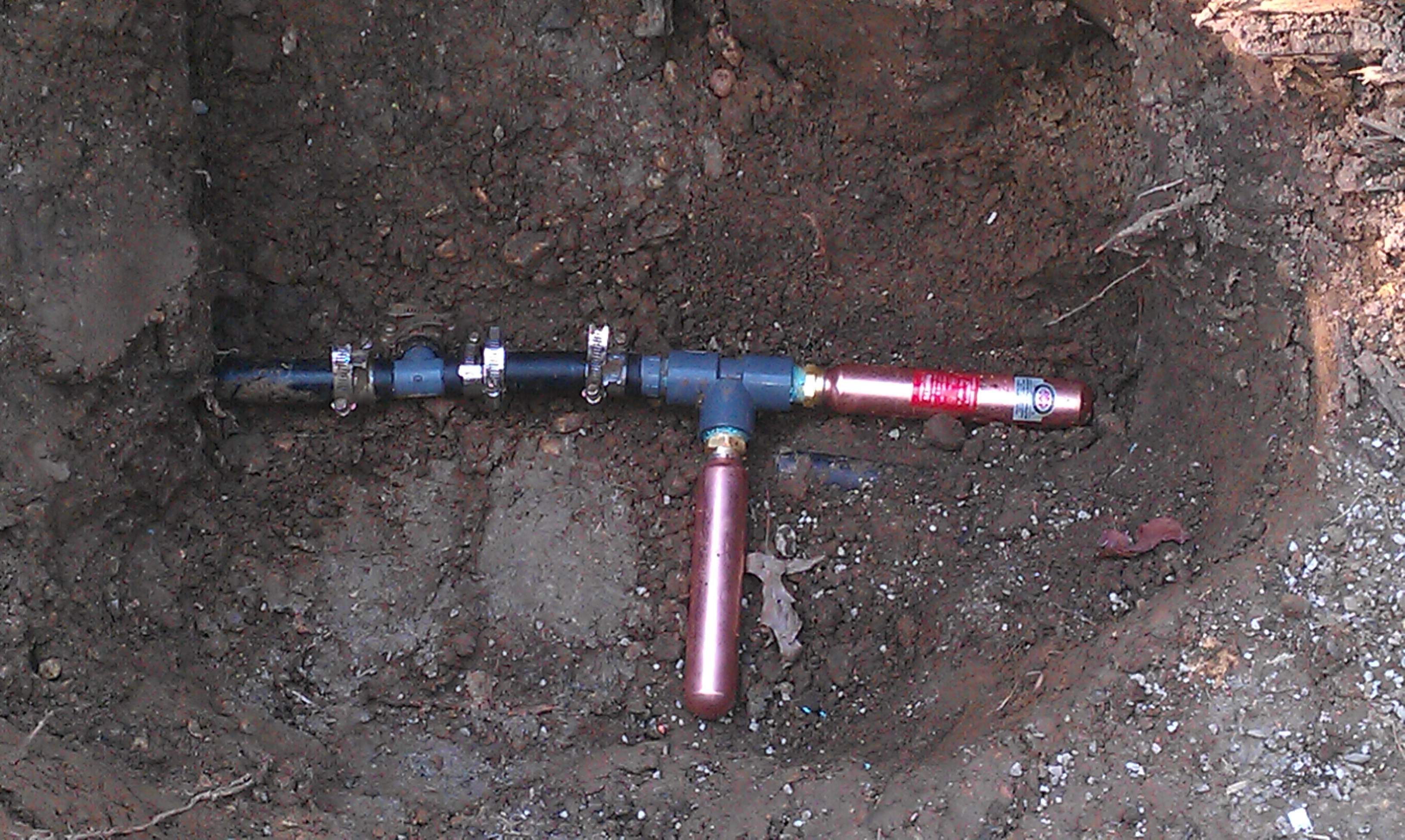

I've had a bad water hammer problem since I installed a few automatic horse waterers that have spring actuated valves. I have a 200' run of 1" plastic water line out to the barn, this has caused a really bad water hammer problem in the house every time the horse takes a drink. When the horse finishes drinking, the valve snaps shut and causes a pressure wave that creates water hammer.
So I gritted my teeth and did what I should have done when I installed them and installed two water hammer arrestors at the end of the 200' line. Of course this required digging a hole big enough to bury the horse in. Either arrestor is sized to take the whole pressure wave, if one fails the other one will be adequate. They cost about $45 each. After installation I can't hear anything in the house when the valves are actuated by the horses, so mission accomplished. In the attached photo the water hammer arrestors are the copper things on the right, the 200' line exits to the left in the photo and goes up to the water source at the house.

I thought they had to be vertical so the air stayed trapped?
Not being picky so please don't take offense :) If they're buried, I would have put them in some kind of sump to keep the earth off the copper. My not be necessary but.....Mike
/ Water Hammer Arrestor
These have a piston in them, the air is in a sealed chamber, so they can be installed in any position. That's why they're so expensive.
Copper is fine underground as long as the proper backfill is used around it to exclude organics and differential contact with corrosive soils. I plan to use washed sand.

I have risers in the house too, but that's at the wrong end of the line in this case. When the water is traveling down that line to the barn and suddenly stops, the energy needs to be absorbed at the far end of the line. Other problem with putting a traditional riser on this line is the end of it is at the low end of the system, so there's no way to drain it if it ever gets water logged.

You won't have hammer with a manually operated valve because it closes so slowly (relatively speaking). I'm not familiar with Ritchie units, but if it has a spring or solenoid operated valve, you'll need an arrestor. The issue is how fast the valve closes: if it closes really fast then it creates a shock wave that causes the hammering. If you're T'ing off an existing line, I'd put one larger arrestor at the end of your longest run, and a smaller arrestor at the end of the run for the waterer. The issue is that the column of water moving down that long length of pipe has to stop suddenly so the best place to absorb that shock is at the end of the long run. If you can't get to the end of the longer run, just put a large one by the arrestor and hope that does the trick. I chose to put in two instead of one because they're cheap compared to the labor of digging the whole thing up if one fails.

I bought commercial grade units from Watts, hopefully they'll last longer than the stuff they sell at the big box stores. If you're replacing them every 2 years they might be getting damaged by soldering heat during installation, or if they're even slightly dented or deformed it doesn't allow the piston and oring to seal properly.
