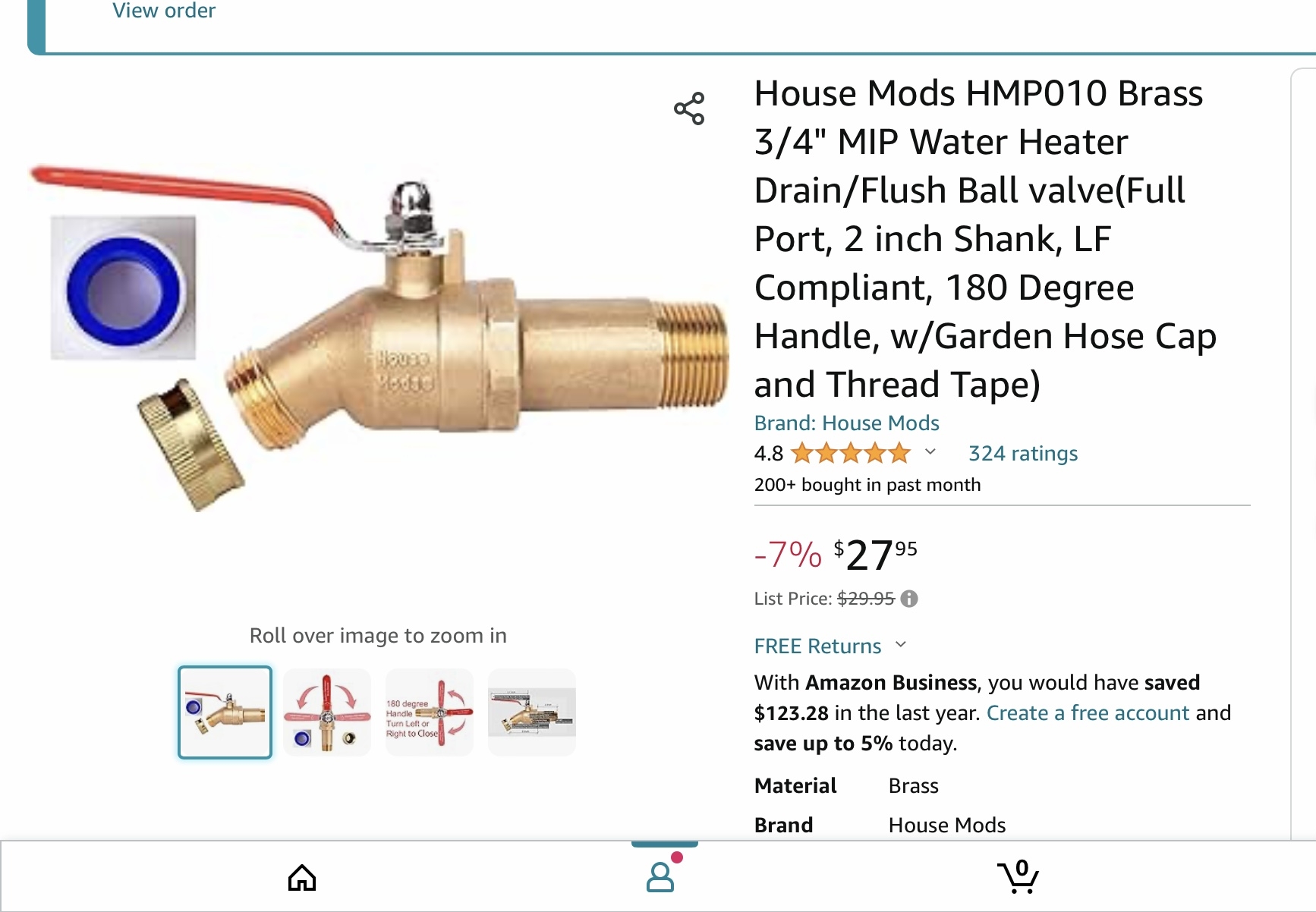

This thread got me off my lazy winter butt. I ordered and installed 2 full port drain valves to replace the crappy drains that come with the Raheem units. Now, when I flush the waterheater the water and crud blows out of the unit. Amazing difference.
