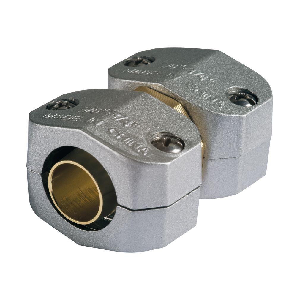

I have lots of garden water hose in need of repair. And with our recent cold spell there will probably be more. What product do you find to be best for these repairs. I have tried different types from big box stores, but would like to settle on a type that works without leaking.

I have used these to repair hoses with a cut or split. Big box stores also have repair fittings for the male or female ends.
   / Water Hose/Garden Hose Repair #4
I like the ones pictured above. If I keep repairing, I'll have more money in splices than I paid for the hose.
I agree. I usually fix a hose once or twice. (usually damaged by me driving over an end fitting or crushing the hose on a sharp rock). After that I break down and buy a new hose.
   / Water Hose/Garden Hose Repair #7
Agreed, I fix too much hose. Have found all fixes leak sooner or later. I like brass fittings...others seem to come apart much sooner. Pricey, however. I fix to save time. A few small water leaks are no big deal.
   / Water Hose/Garden Hose Repair #8
I've had terrible luck with the plastic type of screw together ends, they tend to pull apart as I drag the hoze. The copper looking ones have been worth the extra cost, for me.
