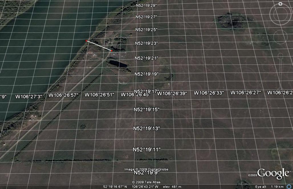

We are located beside a large river - about 100 miles upstream there is a major dam that releases water - the low is around 10,000 gallons per second (reported as 50 Cubic Meters per second); high is around 50,000 gps. At our home the river is about 300 yards across, the main current is 25 feet from our shore line.
Our cost this year for power was about $4,500.
I'm trying to figure out whether a hydro project might be worthwhile.
Our government owned hydro company has recently allowed net metering. I have not asked but I think we could earn about $0.07 per KWH.
The Regulators will not allow any diversion of the river but I think I will be able to place things in the river and along the shoreline (crown land up to the high water line). Our fisheries department will want to ensure the fish are not affected. Coast Guard will have some rules about equipment in the river as it is considered navigationable.
The river bank is about 50 feet to nice prairie land (I suppose nice to someone from the Prairies).
My unknowledgeable theory thinks if I could put a turbine in the river either with some type of anchor or attached onto a dock then somehow move the energy to a generator that would produce 120 volts.
Any suggestions?

Current on both points.
I need to get below the ice - haven't asked the local ice fisherman yet but likely 3 to 4 feet deep. The channel will likely be 25 feet. My hopes is that the turbine would be under water with cabling coming up through the ice.
The Dam is a good thing - we do not get ice jams or the such. Red River is causing all kinds of damage in North Dakota and Manitoba where we have a nice melt happening.
A lot of good energy there.

How fast is the flow along your portion of river? Since you can't divert any flow to build pressure and concentrate the water force, you are left with harvesting the energy from the moving water. kind of like harvesting the energy from the wind. To do this in any quantity, you will need surface area to resist the flow, like large blades on a large wind turbine. Small diameter turbines are not very efficient in this type slow speed application application. It is like the difference between a vertical takeoff jet aircraft and a helicopter. One is considerably more efficient at hovering than the other. Small diameter turbines need a high speed flow to generate any useable speed and torque.
Since it dosn't appear from the photo to be a roaring rapid of a river, I am thinking you are going to need a lot of blade surface area to generate any useable torque to turn a generator. The first thing that comes to mind is a paddle wheel as this would give you the largest blade area for a given depth. A paddle wheel would also allow you to have a long moment arm and make the most torque from a slow moving water flow. Unfortunatly the ice would probably kill it, so it would be a seasonal generator.
Good Luck

Google Kaplan turbine. If I do it I would place the turbine on a boat anchored in the river. That way the generator will be in dry place. Instead of controling speed of the trubine I would let it freewheel and I would use an inverter to get 60Hz. It would take care of the synchronizing, power delivery control as well as disconnect when the power grid goes down.
Here are few equations to get an idea how big it should be.
The energy available from kinetic systems can be expressed as:
キ P = Cp x 0.5 x ρ x A x Vウ
where:
Cp is the turbine coefficient of performance
P = the power generated (in watts)
ρ = the density of the water (water is 1000 kg/mウ)
A = the sweep area of the turbine (in mイ)
Vウ = the velocity of the flow cubed (i.e. V x V x V)
Relative to an open turbine in free stream, shrouded turbines are capable of efficiencies as much as 3 to 4 times the power of the same turbine in open flow.
