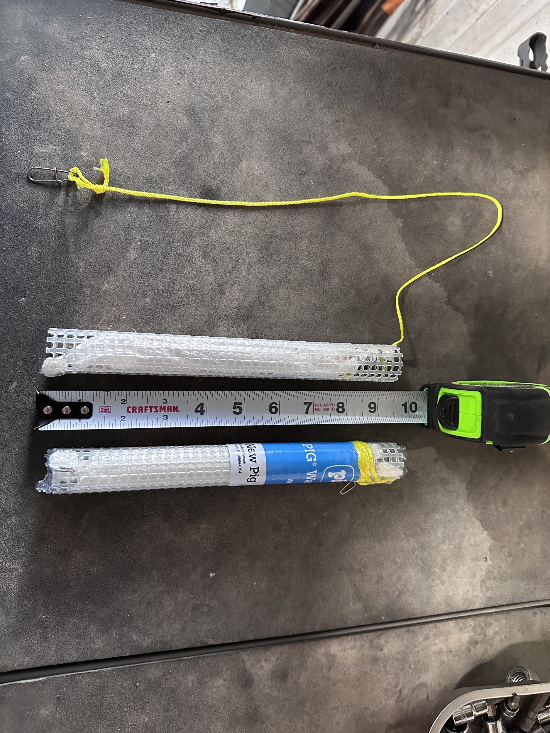

I ordered 2 of these tampons to put in my tank. They are smaller than I expected. The second pic is of one that has been in the tank for about 6 hours. Looks to be a couple of dark spots that may be water. The tank has not moved for at least a week.

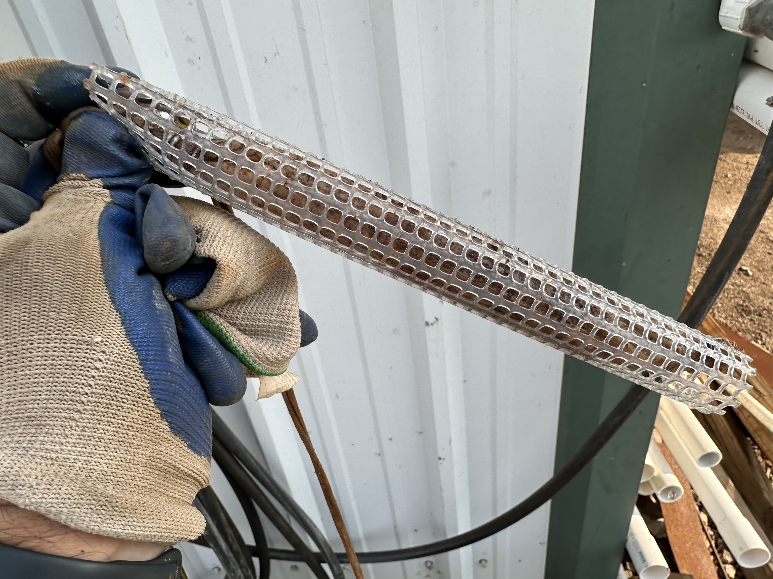

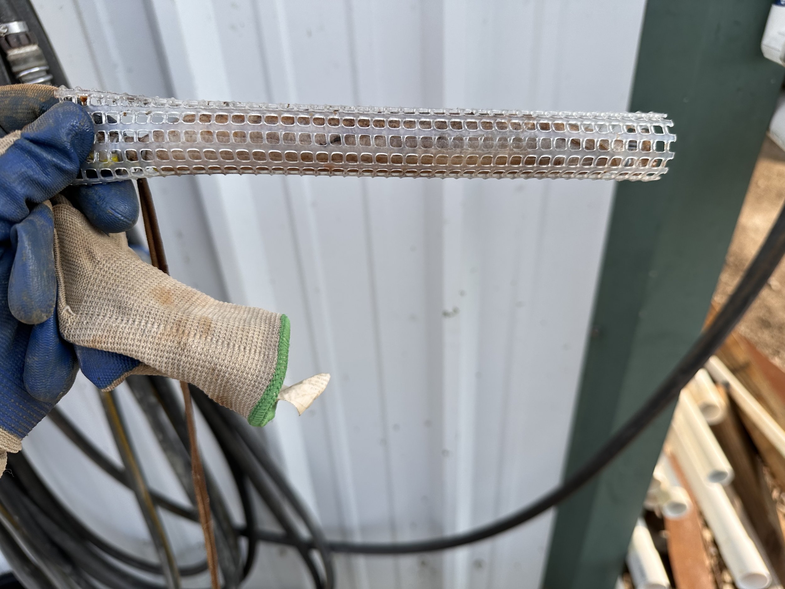

I put this in my tank on Feb 22 and removed it today on June 3. I put a new one in today. It looks really dirty after about 100 days.
   / Water in fuel causes $10,000 damage to my Kubota Grand L6060 #166
Appears to be collecting rust too.
