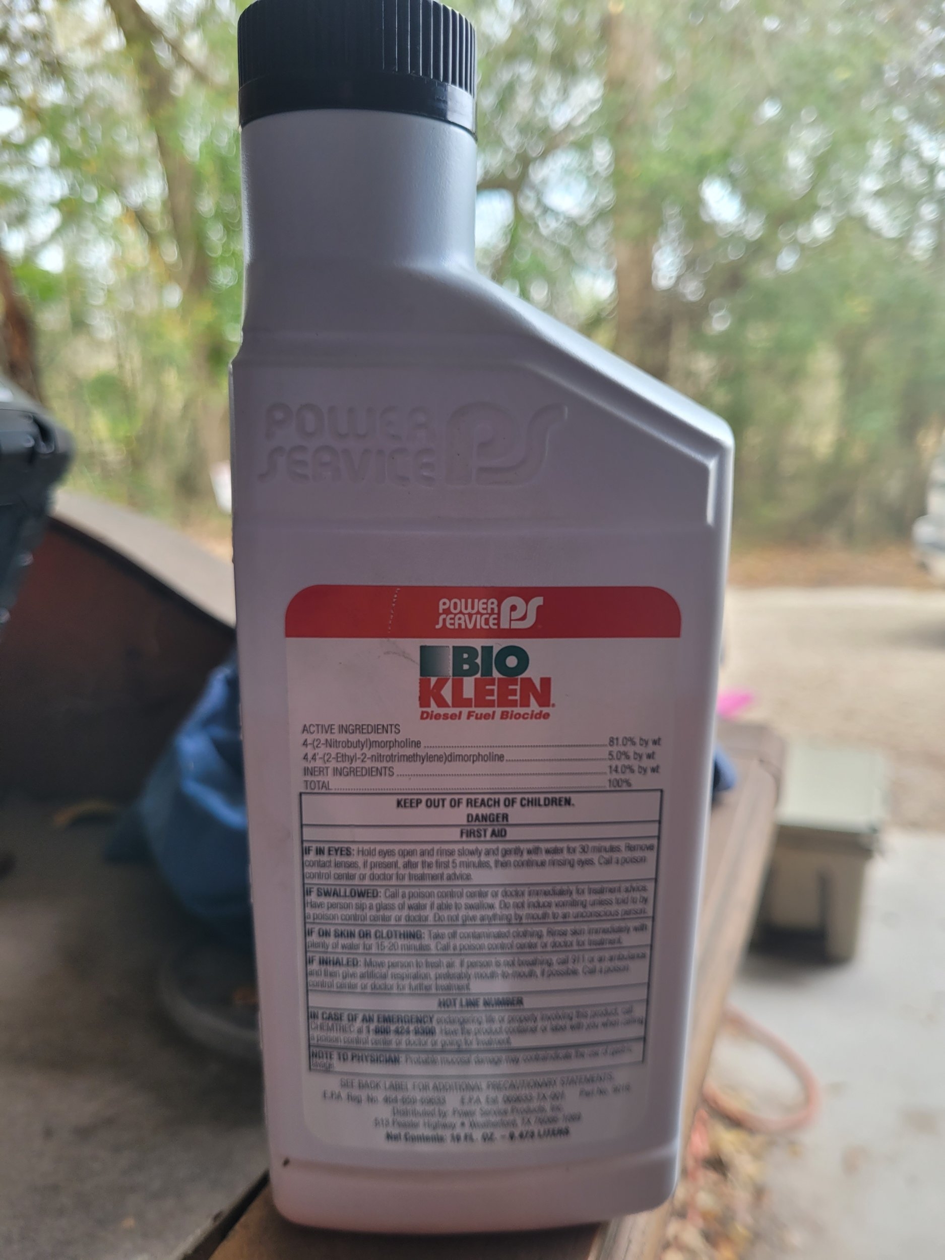

I do also use a biocide.

Did you add a Racor prefilter on your tractor? If not, I would do it now. They are available in models with clear lower bowls that have a drain and a hookup for a water in fuel sensor.
I think that you need to stop, drain your nurse tank, and have your local radiator shop steam clean it out. I then would be tempted to take it to a welder and get a drain put in, and perhaps two upper access ports, one for a breather, and one to return fuel. (See below)
I would then check all the fuel caps to see what could be replaced / improved. How much time does your tractor / tank spend in the rain? Getting pressure washed?
Then change your diesel buying habits and stick to a major brand (Shell /Chevron) for a while (six months / a couple of years) to see if that eliminates your issues. On your first couple of fills in your shiny newly clean tank, I would be adding biocide to every fueling. I wouldn't be adding water emulsifiers as they shift the water in the fuel farther into your engine which is not very tolerant of water. I would then change the Racor and Kubota filters preemptively and at the same time with fresh filters, with no prefilling the filters.
