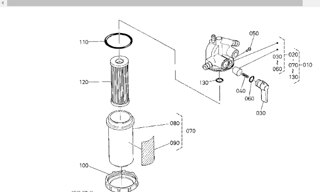

I have an '02 Kubota B2710, and my mechanic friend says I should put a water separator in the fuel line or with the fuel filter, since I seem to have a lot of water in the fuel I buy. Looking for recommendations. Preferably with a link to order.

I'm surprised that your tractor didnt come with one. Carrying fuel in cans is a PITA. To help keep the water from getting into your fuel in the first place try a Mr Funnel Home. You also might consider adding some biocide to your fuel. Bio Kleen Diesel Fuel Biocide - Power Service Ijust spent 4 weekends cleaning the crap out of my tank and fuel lines, time that I should have spent doing other things.
/ Water in fuel? #4
IMHO if I was buying diesel fuel & it had water in it I would not buy any more diesel from that fuel supplier. According to Kubota parts your tractor came from factory with a water separator filter very similar to my M7040

Since the fuel is free, I'm ok with a little water if I can keep it out of the engine. I think my filter does separate the water, since the water stays in the bottom of the filer bowl, just no way of draining it without tearing it a part
Getting a Mr funnel will help tremendously.
/ Water in fuel? #6
Do you fill from 5gal jugs or something more like a transfer pump? Golden rod makes a water blocking filter for transfer pumps. Mr funnel should work but is slow and can only take so much water.
I do think you should br trying to remove all of the crap/water in the fuel before it goes in your tractor.
Or you could just drain your fuel/water separator more often.
