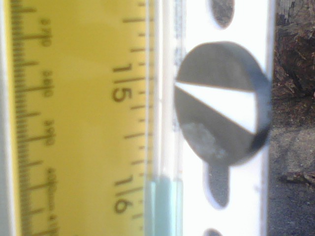

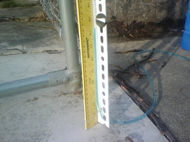

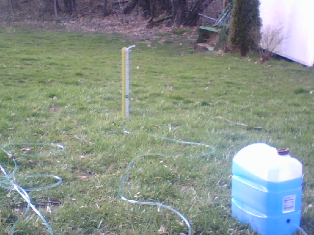

I have to lay about 300' of drain lines on my property to address some surface water pooling problems. My problem was how to accurately measure the slope of the drain lines to ensure the water would go where I wanted. Too cheap to buy a laser or transit; too lazy to use a string level; I instead built a water level to make sure my drain lines were right.
The concept is to use the water in a hose to show the proper common points for leveling most anything. Gravity basically forces the water in the tube to always be at a constant level (relative to the tank), so every measurement taken against that reference point is really VERY accurate.
Setup requires a tank/jug with some clear tubing. I added a yardstick and some angle iron to mount everything. Then I added a magnet to use as a sliding pointer to show the water level. I also added some food coloring to the water so its shows up better. Each measurement moving down the trench allows me to see if the pipe is sloped correctly to my 1/8" per foot target. One of the pictures shows the magnet pointer and the blue water with a 1" difference in readings which correllates to the change in depth of the pipe over an eight foot long section (1/8" per foot x 8' = 1" drop).
Hopefully this makes sense. BTW - I also used this to measure my gutters to set the slope for proper flow where I was having problems.
Here are some pics of the setup.
