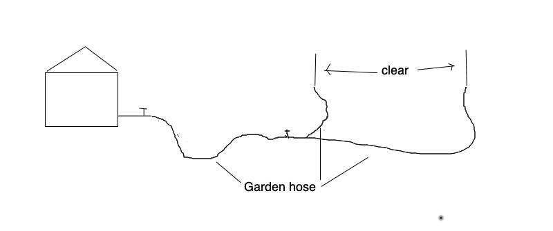

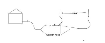

About the tubing for a water level: Instead of a very long clear tubing, get about 4-6 feet of 1/2 in clear, cut it in half, add a male hose fitting to one piece and a female to the other. Use one or more of your garden hoses in between. You can use more hoses with a valve and a garden hose Y to fill the water level from your house faucet after you get it into place.
Bruce
Bruce
(y)That's how mine is rigged!

I used a water level kit that's two clear tubes connected by garden hose. The nice thing about the garden hose is one can use a faucet to fill the hose with water. Let it run to get all the air out. Getting the air out is key to it's accuracy.
