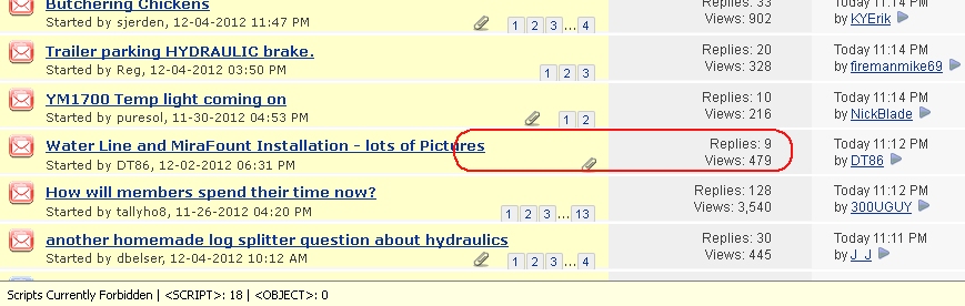

no one is watching this. :confused:
Your kidding right ?, almost 500 views.
OK, I've may have looked more than once or twice, so minus a few off the top. ;)

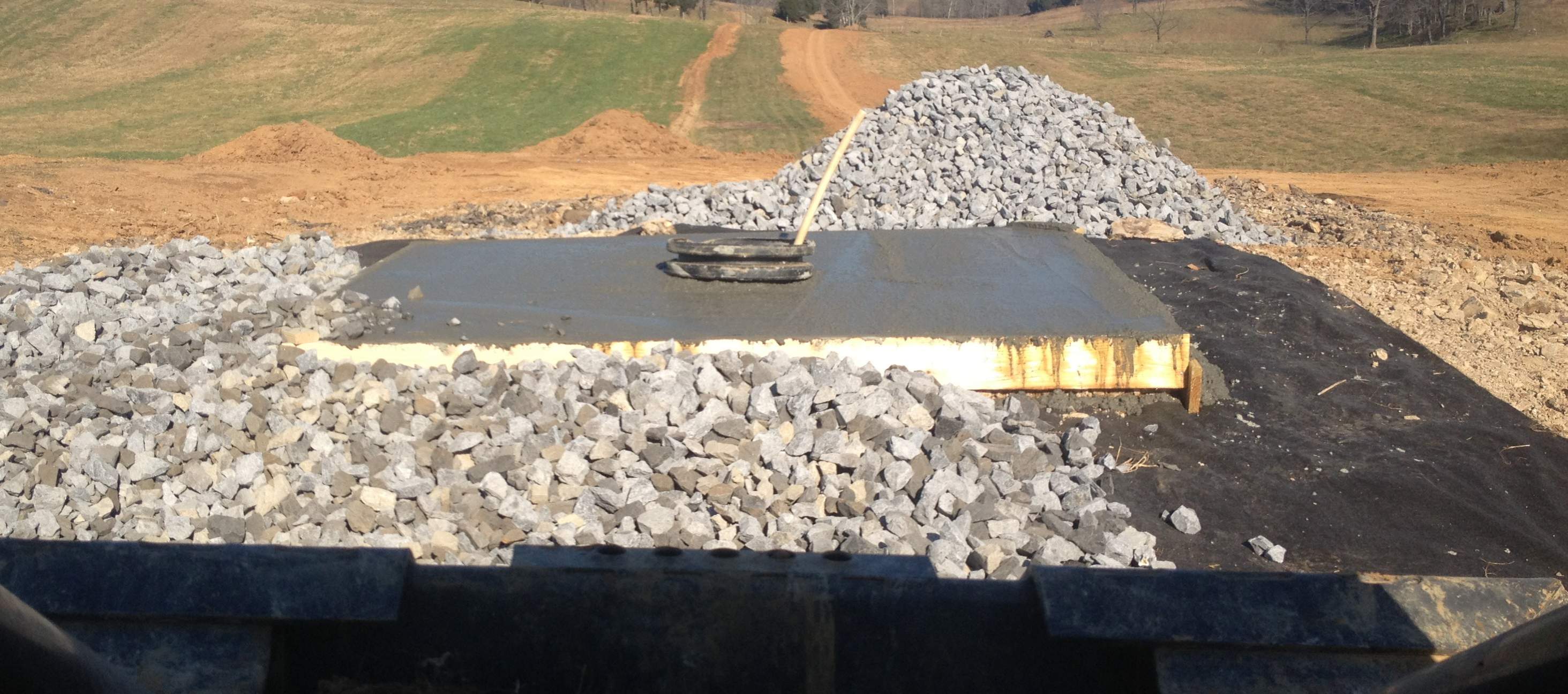

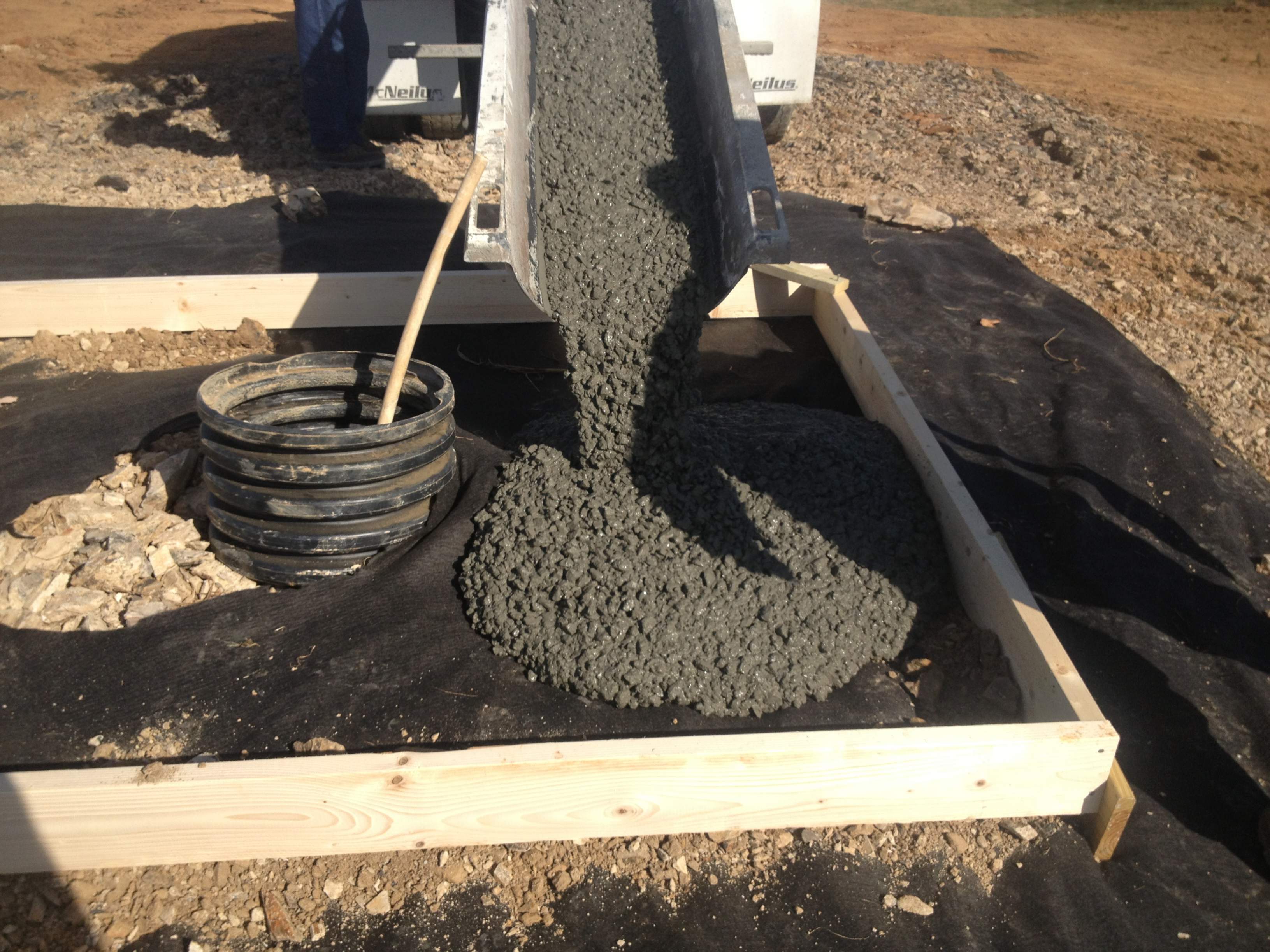

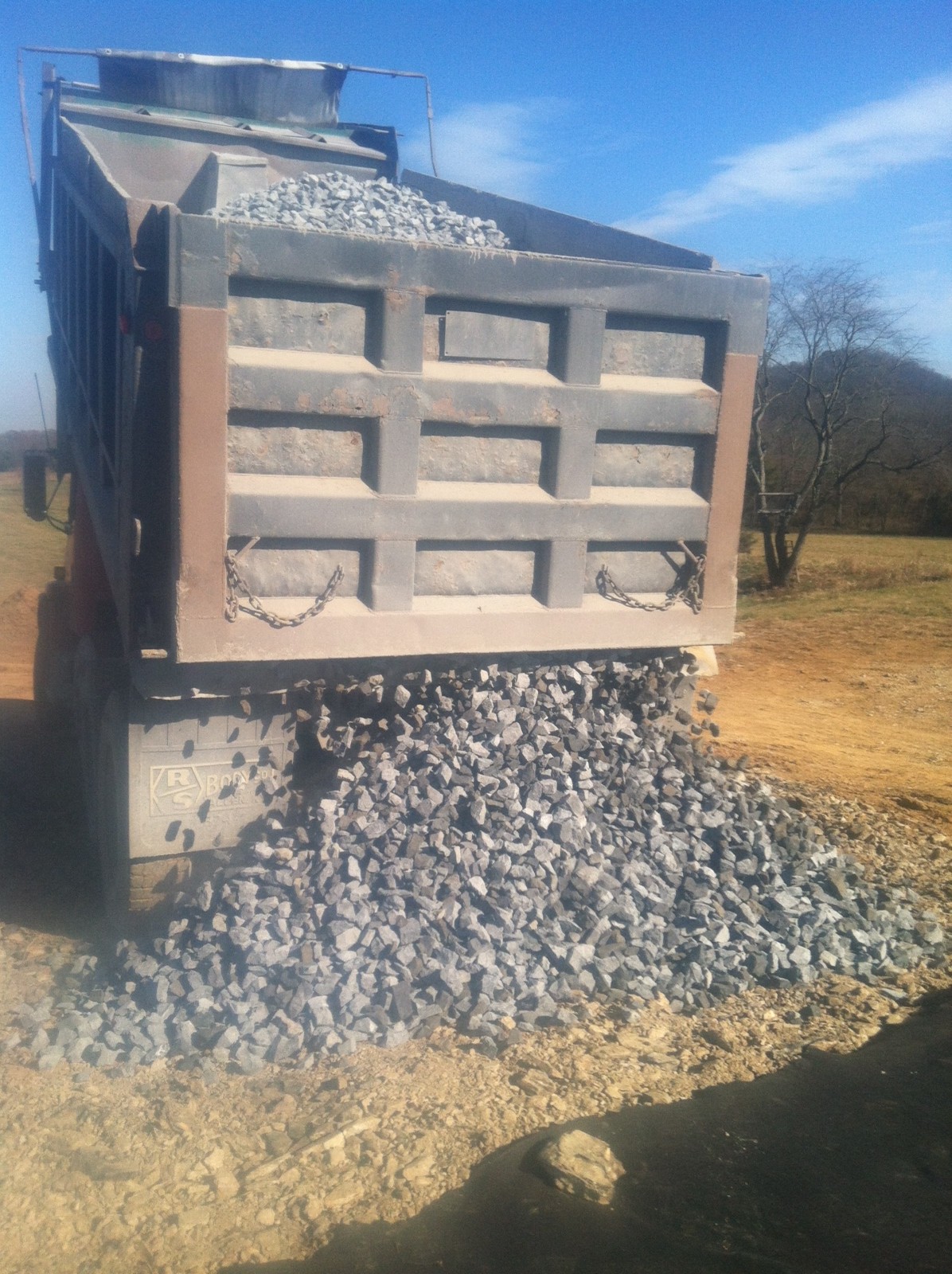

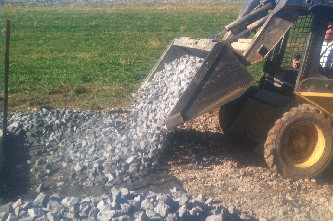

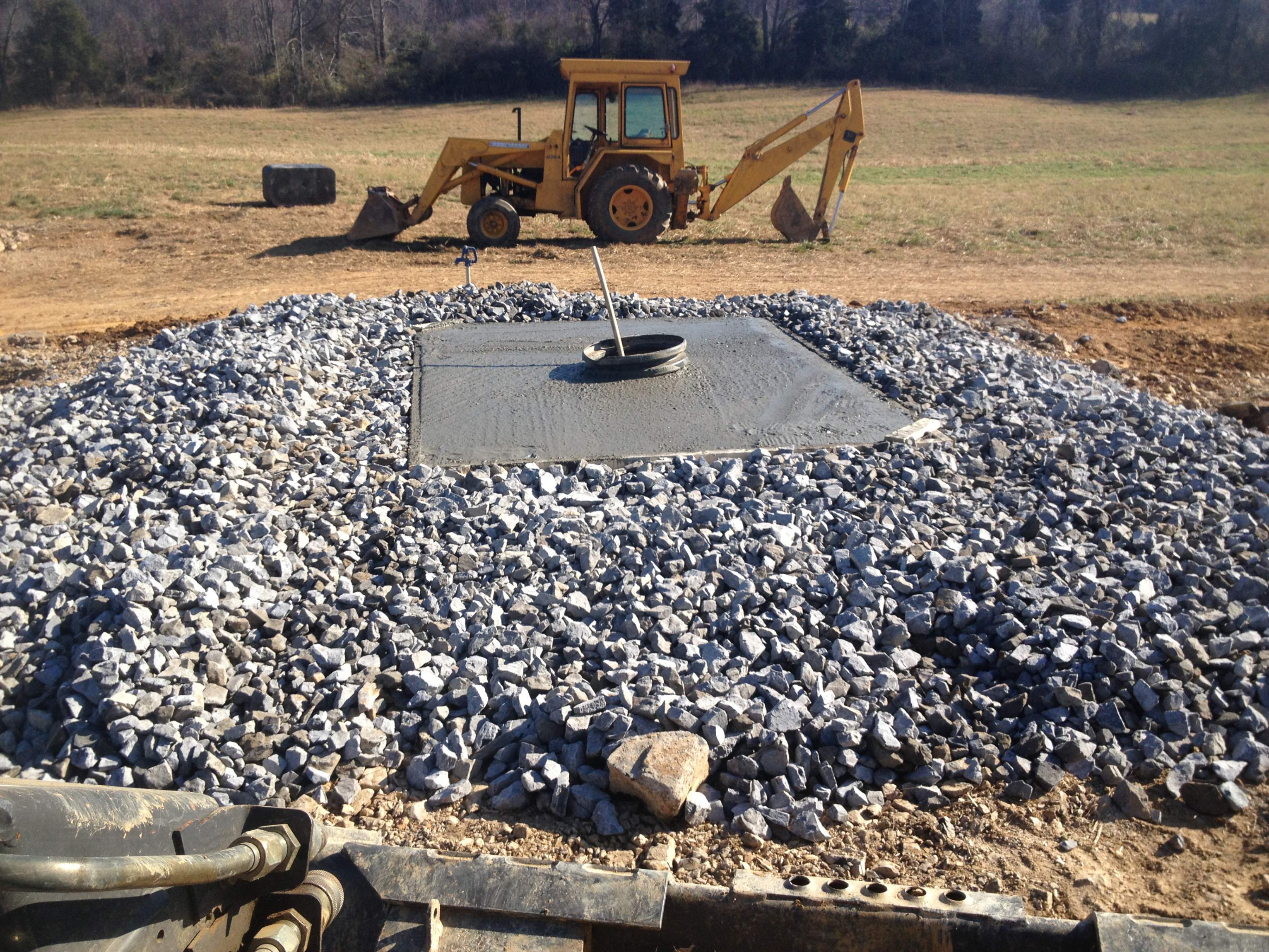

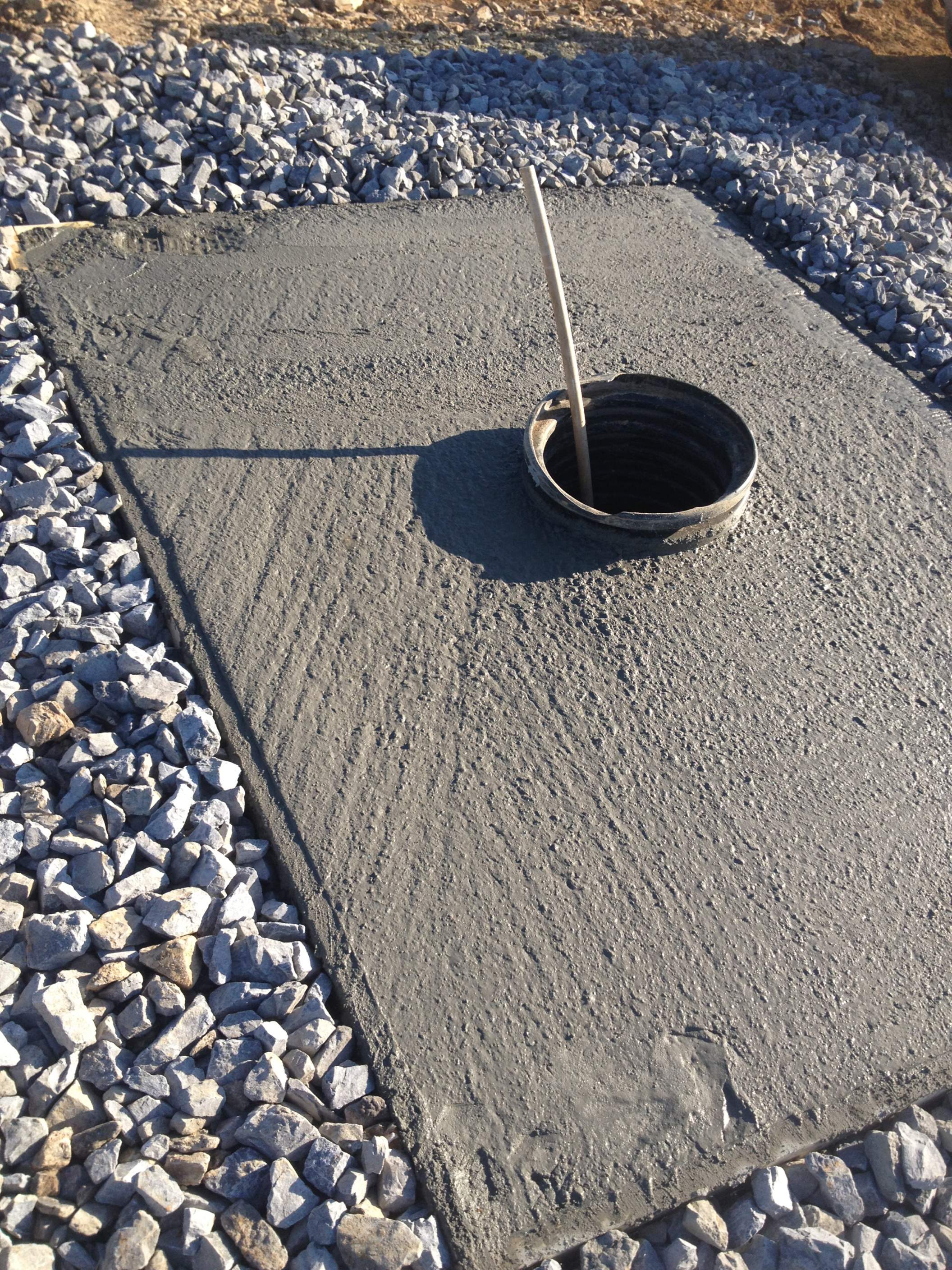

Just a few minutes after having my forms ready 2 yards of concrete arrived.
As soon as I had smoothed it out the way I wanted the truck load of 2" stone arrived. Almost like I had planned it that way.:rolleyes:
I spread the stone around with the skidsteer. These only show trough #1, but you get the point.
As I was about to quit for the day the "Inspector" shows up. It was a good thing he did. I can only imagine what a concrete mess he would made if I had forgot and left him in the field. I fed him a beer and he followed me out.

Looking good. I've installed many Ritchie brand fountains that work in a similar manner. We've had them operating down to -10* in strong wind without any trouble. A good deep heat well and keeping everything sealed is key as I'm sure you know. Glad to see you are using a decent sized pad. We used to put them on a pad just about 1' bigger than the fountain all the way around. However, even with large rock all around they quickly became a mess. The one I just put in has concrete 4' out on all sides, might even go bigger on the next one (so the animal is completely on the pad when drinking). Keep the pics coming. :thumbsup:
