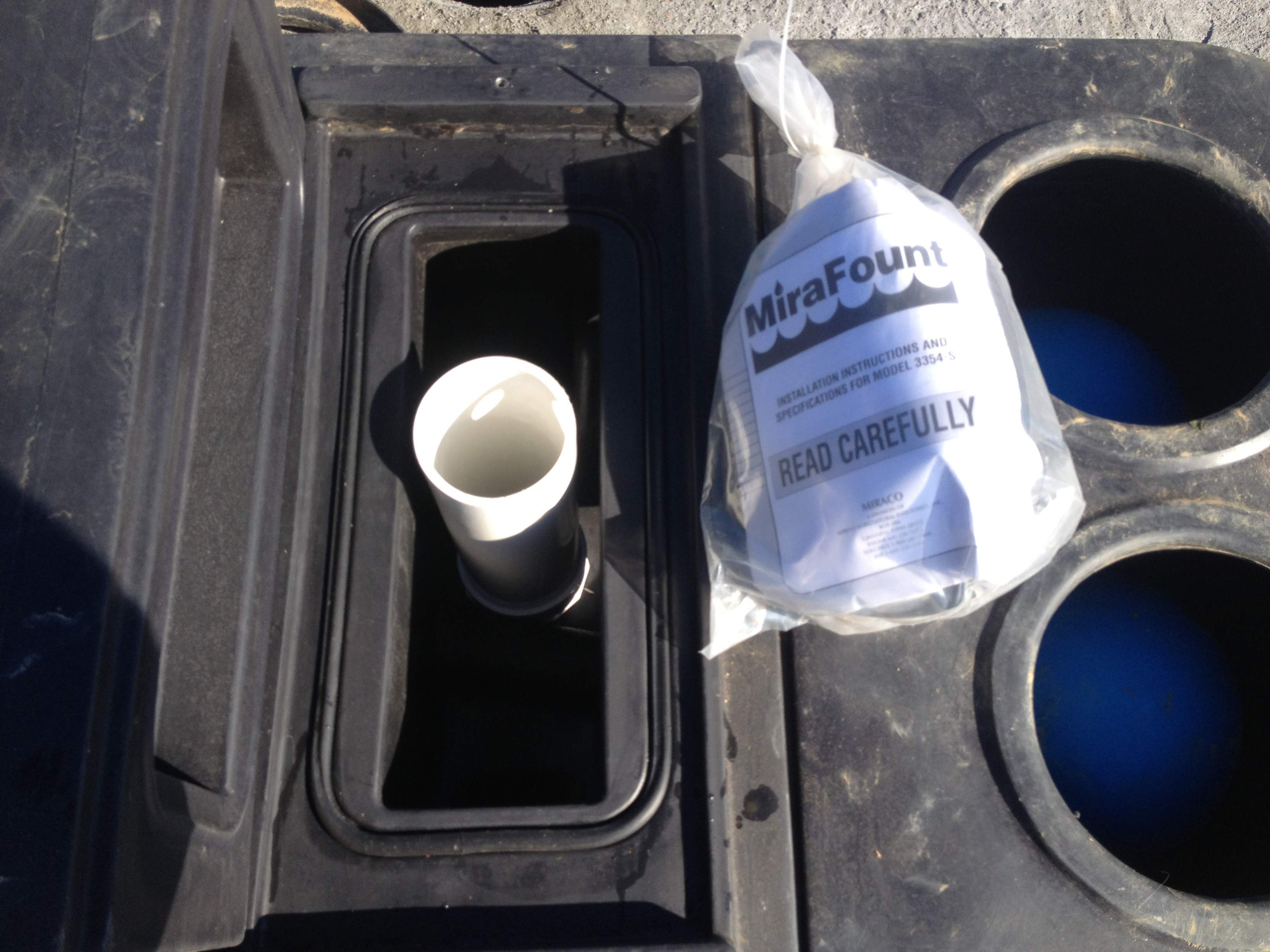

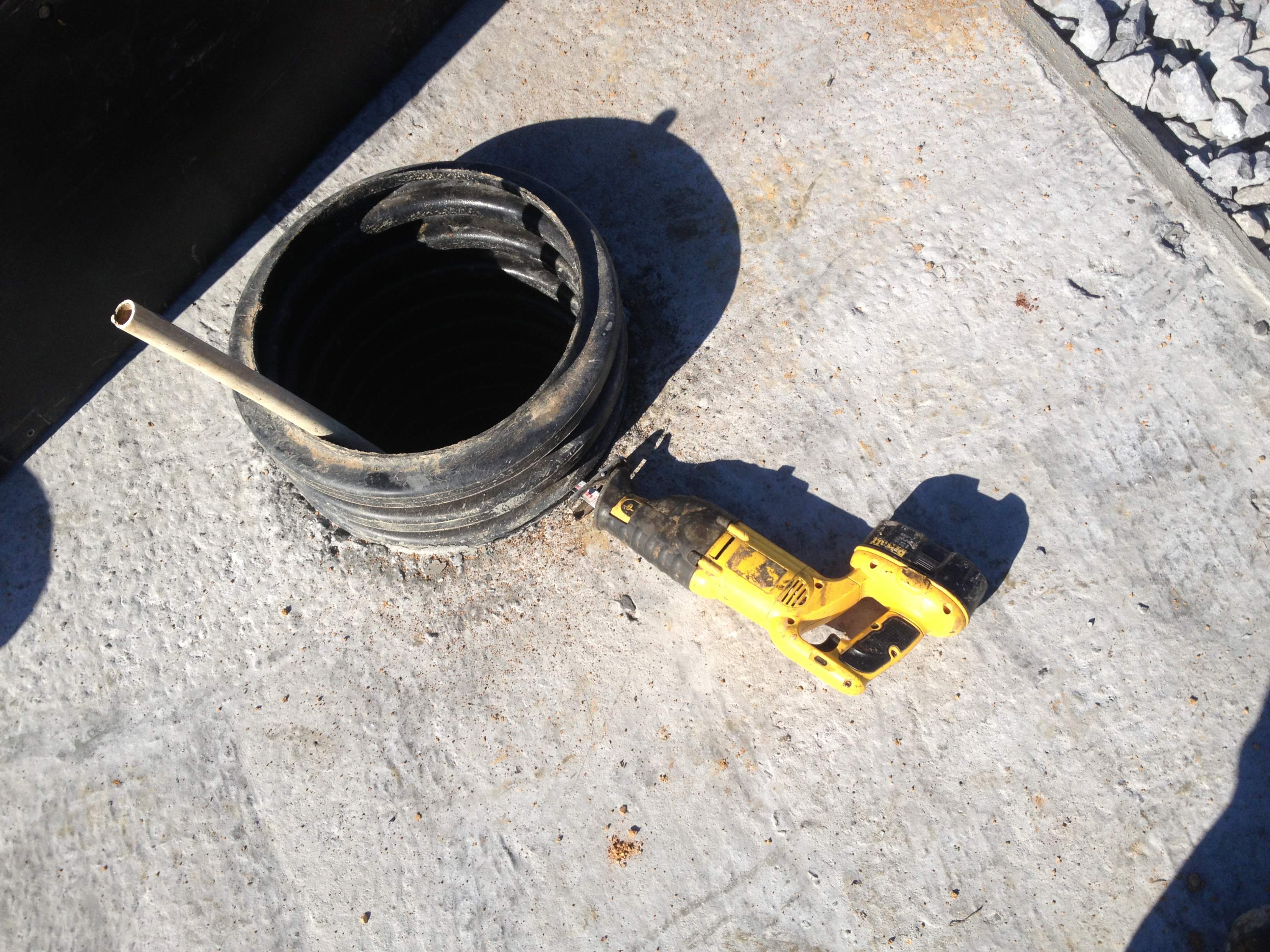

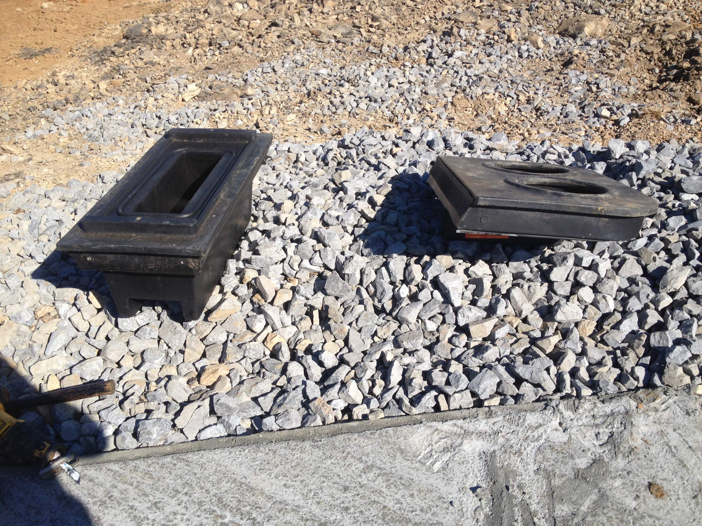

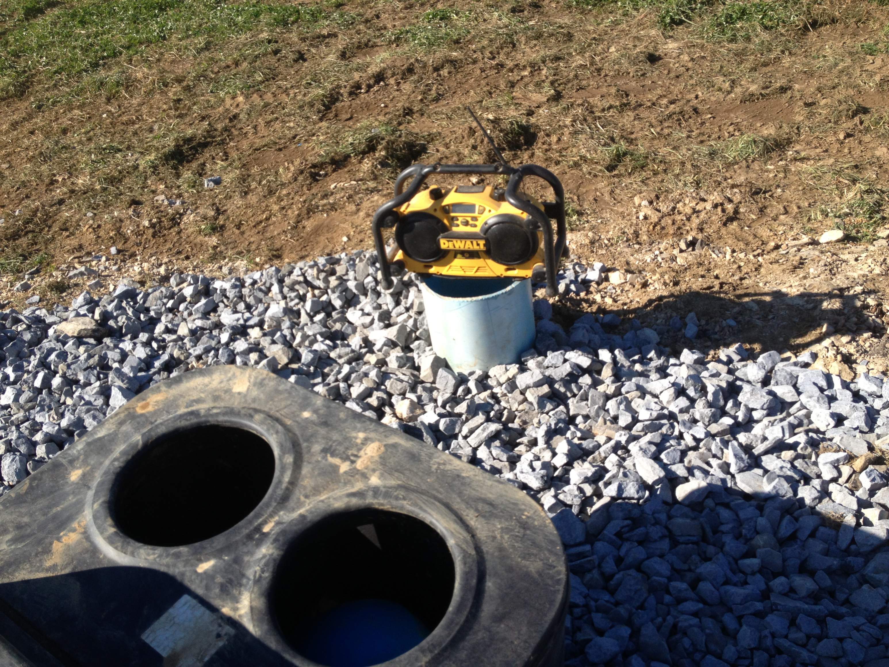

After letting the concrete dry over night it was time to install the troughs. Amazingly I brought all the tools I needed with me. They include a sawzall, pipe glue and primer, my special Mirafont tool, pliers, tape measure, rags, drill with concrete bit, small sledge hammer, Teflon tape and a few others I'm sure.
The following pictures were taken from both troughs but are combined as one to better show the steps taken in order.
The most important tool of all is a good radio. :thumbsup:
The first task is to cut the heat well pipe flush with the concrete. I use Lenox Fire and Rescue blades.

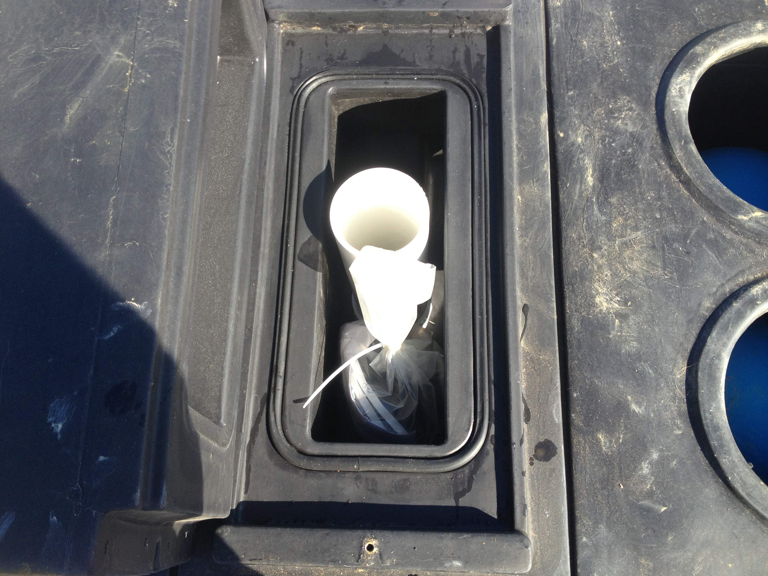

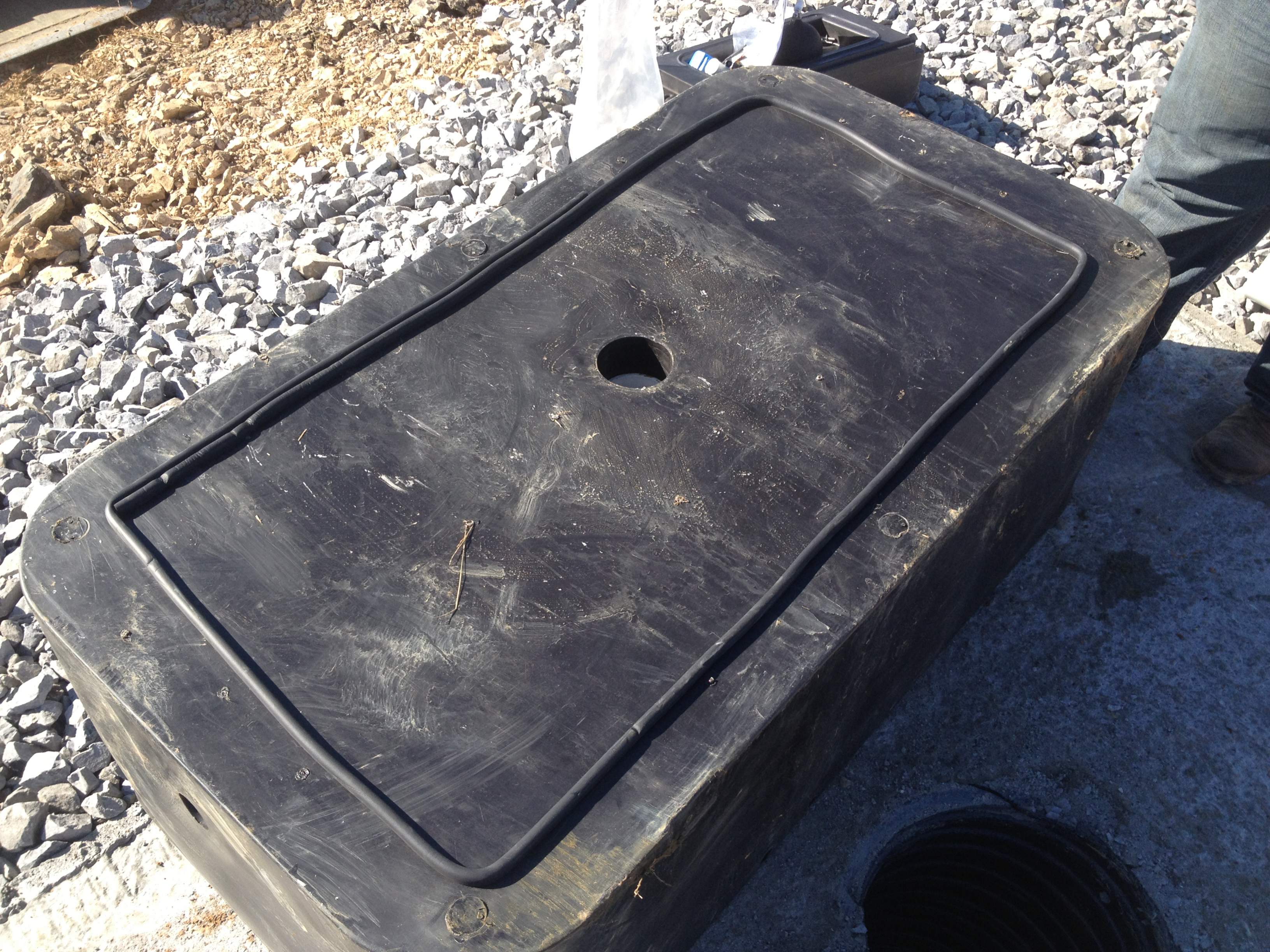

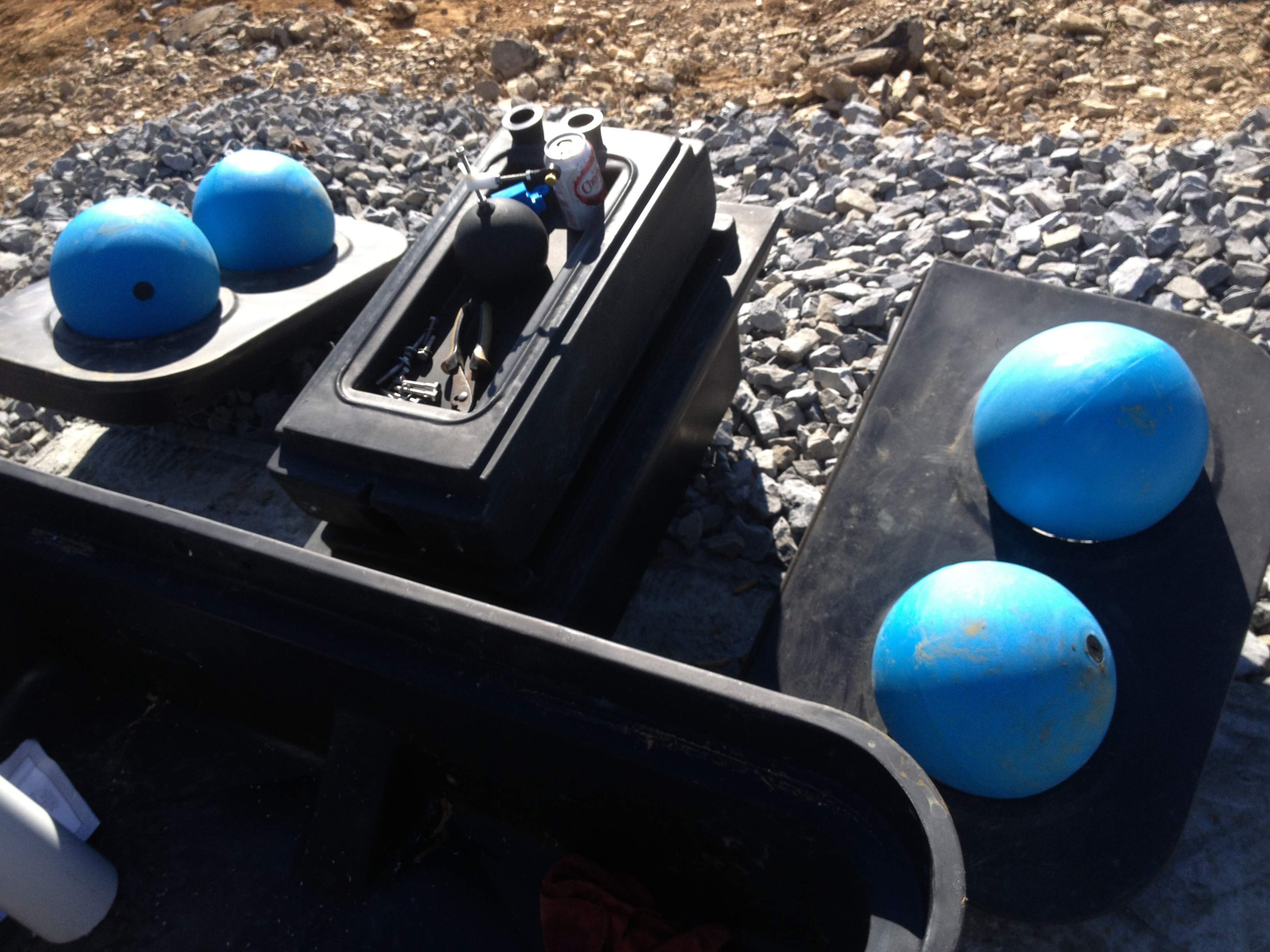

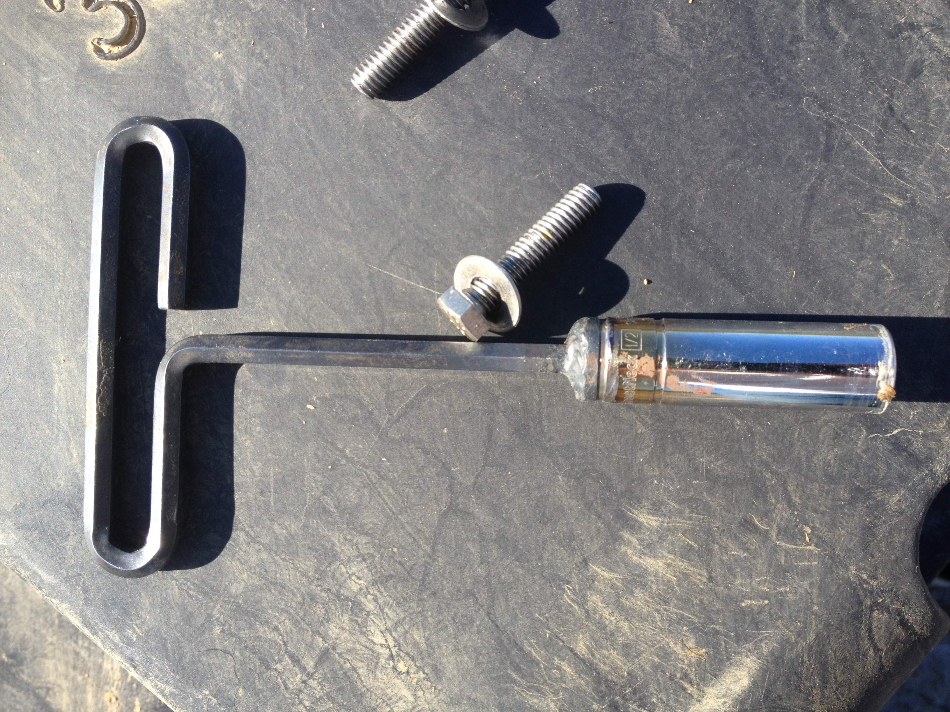

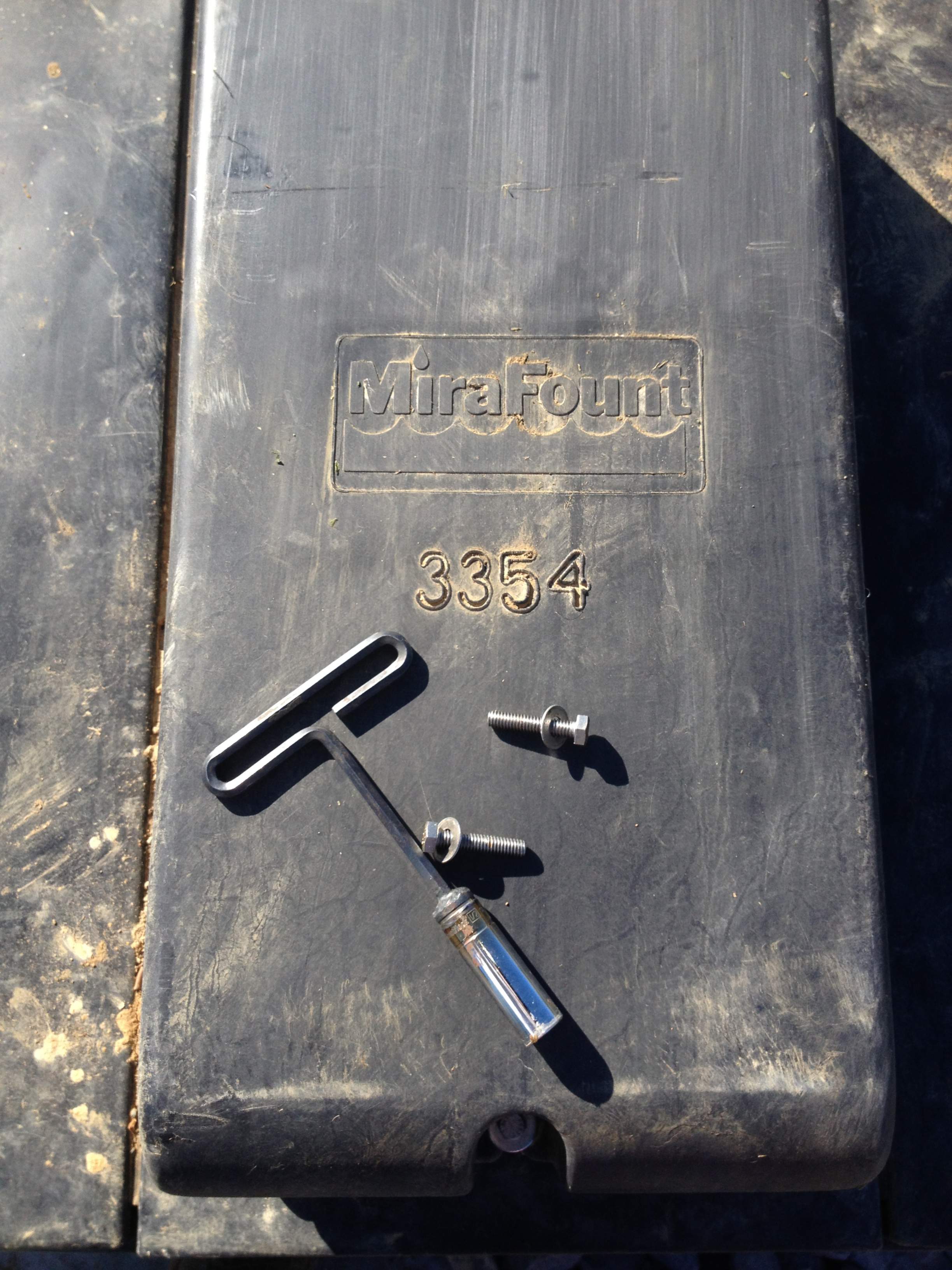

The next step is to remove the float cover (top center section) and retrieve the packet that contains the directions (which are terrible), and all the small pieces needed for installation. I use a special homemade tool that is just a 1/2" deep well socket welded to a T-handle allen wrench.
Then remove the three remaining sections of the lid and arrange everything close by.​

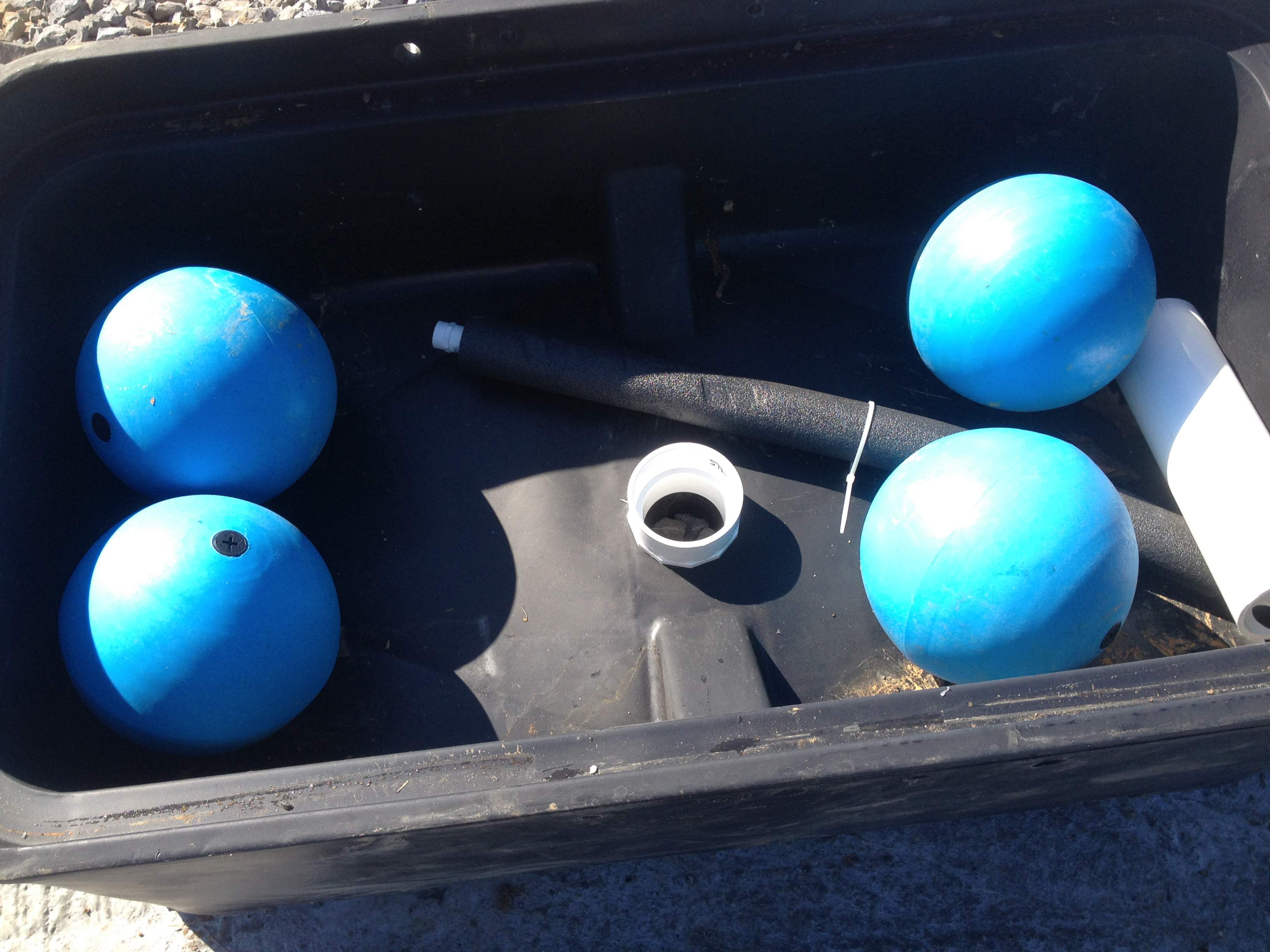

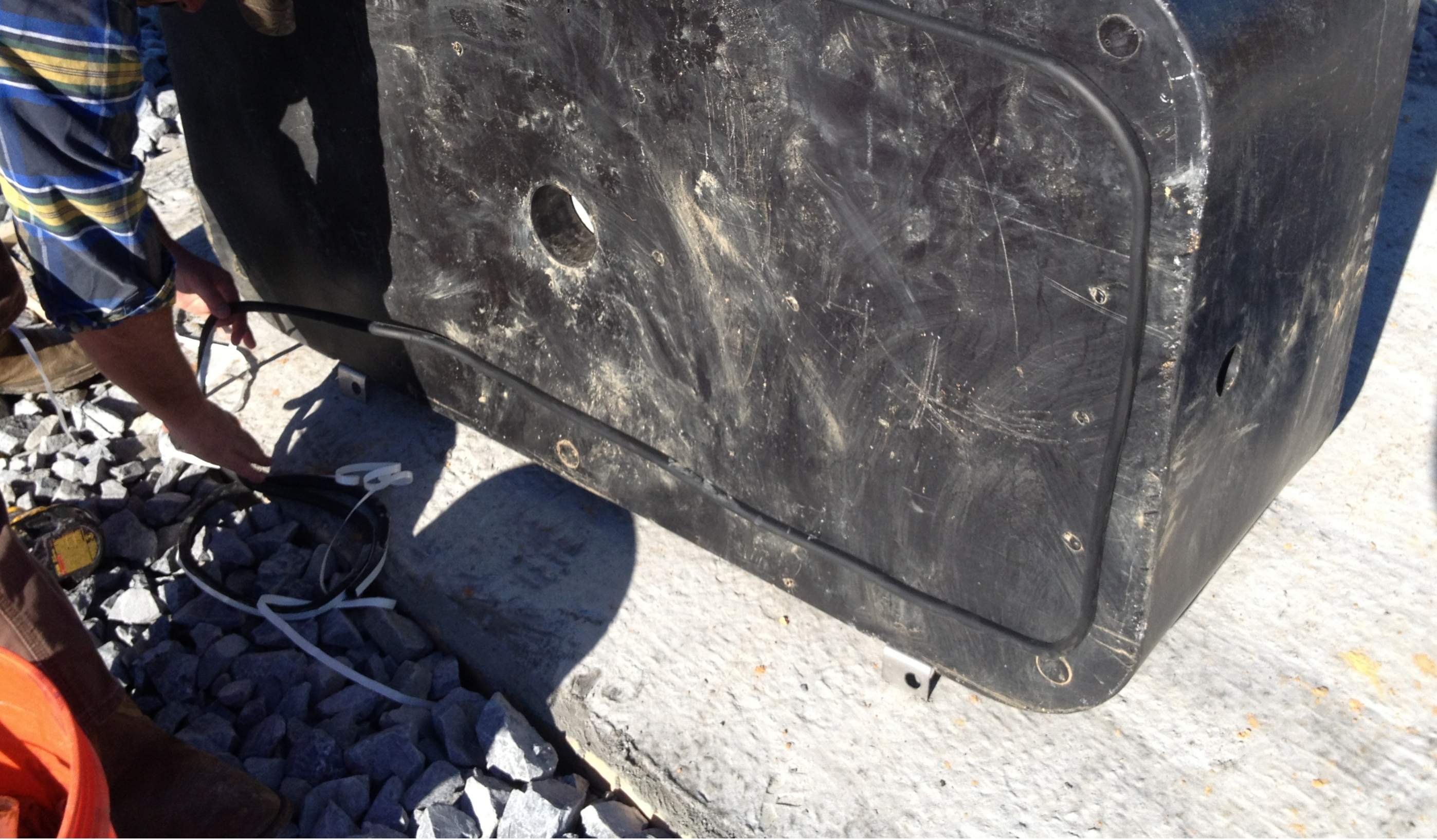

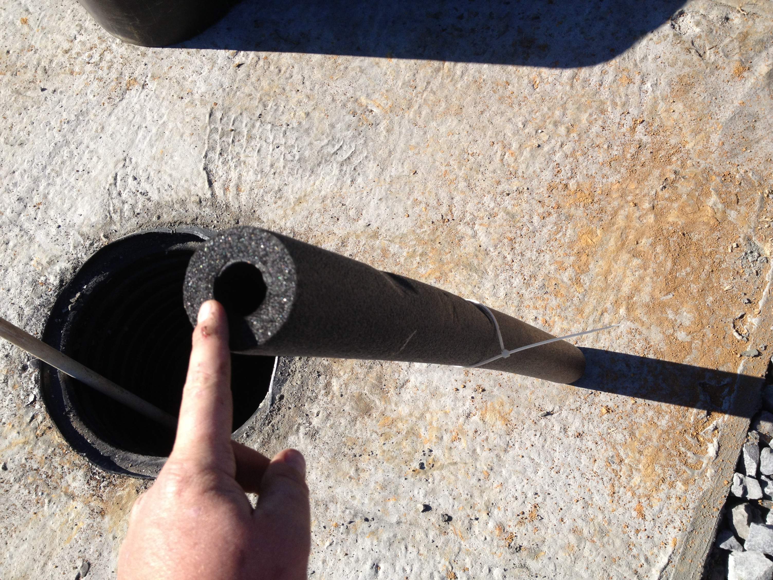

Now you open up the packet. In it are the directions, the float and valve, concrete anchors with brackets, insulation strip for the bottom of the trough, insulation for the 3/4" supply line and the drain plugs. All you need in addition are the tools, a Sharpie, pipe glue and Teflon tape.
Next I place the trough over the supply line and mark on the concrete pad where I want it to be with the Sharpie. NOTE: It is important that when complete the supply line does not touch the corrugated heat well, otherwise it could freeze.
Remove the trough and flip it on its side. Get the strip of insulation from the packet and install along the edges of the bottom of the through, it comes with a glued backer.
Next I loosely install the four angle brackets for the concrete anchors. This is the only picture I have. :(
Then you slide the insulation tube over the supply line, slightly above flush with the concrete. It is secured with a zip tie from the packet. Now replace the trough over the supply line and back onto your placement marks.​
