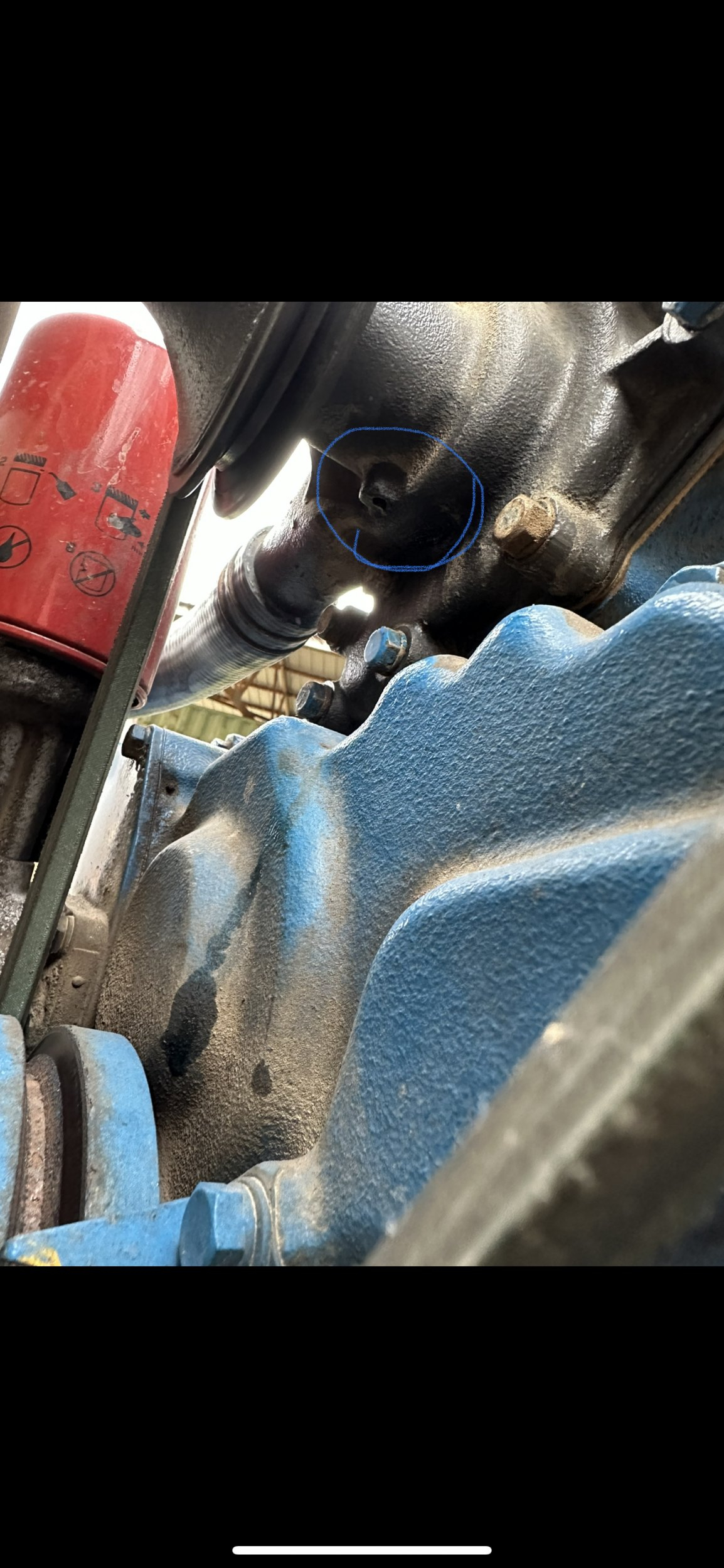

I changed the water pump on my ford 1910 this summer I’ve ran the tractor many hours since but when I used it today I noticed a little bit of coolant had leaked out it appears to have come from what I think may be some type of drain but I’m not sure any help would be appreciated

That would be the weep hole. which means that the seals are leaking and most likely has contaminated with the bearings which is most likely now damaged Or the bearing failed leading to the seal leaking. Either way will most likely call for replacing the water pump again.

What could cause it to fail so soon that pump only has maybe 10 hours on it

Potentially defective water pump would cause low hour seal - bearing failure. Does the pulley on the water pump wobble if you push or pull on it?

Another possible idea is the water pump was old new stock meaning it has been sitting on a shelf for 10 years and the seals dried out and hardened.

I would run it longer and check if it's not under warrenty.

I never worry about an occasional bit of fluid coming out of the weep hole. It could have been just how the shaft versus bearing and seal were sitting last time it was shut off.
I don't know for sure, but at one time I figured that some waterpump early failure was from having the fan belt too tight. Now most fan belts have non-adjustable string-loaded tensioner pulleys. You might want to check that belt tension if it doesn't have a spring loaded tensioner.

or, the OP bought an aftermarket water pump because it was cheaper and probably made across the pond (Chineseum). Had a buddy that bought one and the impeller was not on the shaft far enough and the impeller 'milled the front engine cover' and he had to replace that as well as buy an OEM pump.
Sometimes, buying cheaper costs way more then buying OEM.
