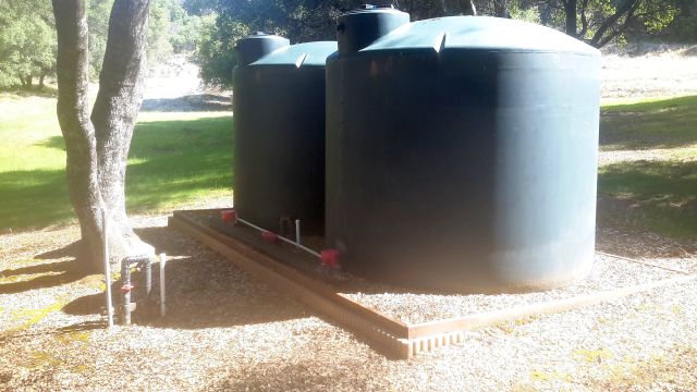

I installed two 2500 gallon tanks for my 5000 gallon standby... Green poly, and opaque....Think pricing came out to about 50 cents a gallon for tanks (memory a bit foggy on that one)...

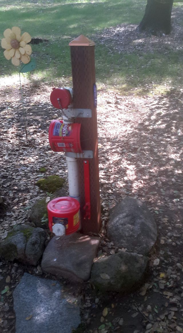

Bungs on tanks are 2 inch NPT.... Also installed a hydrant (2.5 inch NPTH) so if engine needs to connect for fire prevention ... I'm a little above you near Yosemite so fire is always in my thoughts... Most people seem to prefer plastic up here....
Red "coffee cans" protect plastic ball valves from UV radiation which will cause it to become brittle...
