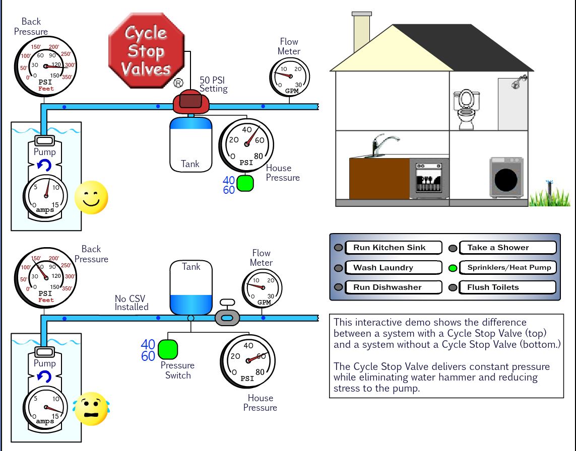

Hmmm, are the pumps variable? I was under the impression that it was either on or off. I guess some are variable, just not sure of whether mine is or not.
   / water well drilling info #25
The cycle stop valve sets the max pressure, the pump motor turns fast enough to supply the flow required: Cycle Stop Valves, Inc.

I install lawn sprinklers , I do a lot of well systems . When the customer has the constant pressure system , they work great . The customer can even shower while the irrigation is on with no pressure loss . Its the way to go
