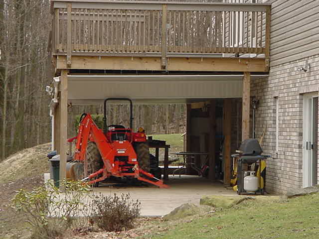

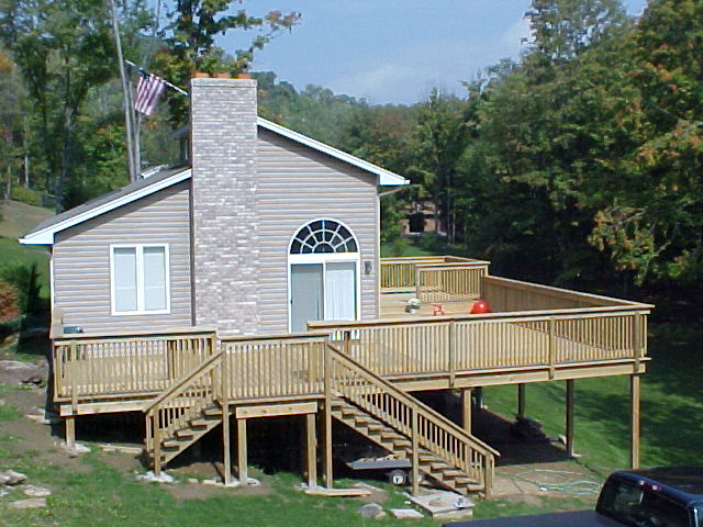

OK,
Here comes some pictures.
First one is a view of the deck from the side.
As pictured, everything from the chimney towards the back of the house (left) will be 2 story.
On the underside of the deck:
From the chimney to the rear of house will be a small workshop/storage room under the deck. Everything behind that (across the rear, 48' long) will be 2 story.

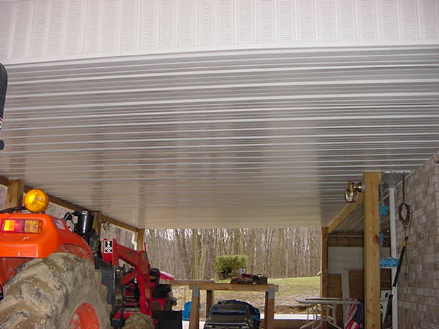

Next picture
Looking at a roofing material from the lower level of the deck.
   / waterproofing deck #10
Here's a picture from the side.
The tin is sloped towards the outside and the water is collected into the gutters
