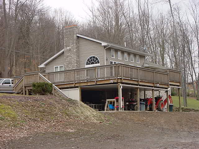

Last pic
A distance shot where you can get an idea of the 2 levels.
Obviously, the room, staining and landscaping aren't completed.

Wow! That's a great looking job. In my mind's eye, I had pictured a bare tin roof like you might find on a barn, but yours looks like it is painted. Is that metal siding or soffet material and is it tin or aluminium? Where did you get it?

thanks for the pics, that's slick. i was hoping to be a bit more lazy. i'd really like to use the upper deck as a roof for the lower rather than double my efforts through what looks like redundancy(is that tongue and groove 5/4?). question is how water proof can i get with the urethane (or?) on the upper deck.

</font><font color="blue" class="small">( Wow! That's a great looking job. In my mind's eye, I had pictured a bare tin roof like you might find on a barn, but yours looks like it is painted. Is that metal siding or soffet material and is it tin or aluminium? Where did you get it? )</font>
Dennis,
It's the neighbor's house/deck but let me see if I can answer correctly.
I believe the metal is tin and I think it's 28 gauge.
It came pre-painted from the factory.
He purchased it at Flexospan
On the vertical sections (e.g. where the deck changes level in the 3rd picture - next to the tractor ROPS), he used vented soffit.
Brian
