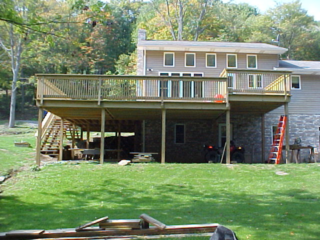

Brian,
Other than the length of post embedded in the ground, what is providing lateral stability if it's not attached to the house? You get some lateral stiffness from the area that changes elevation, but I would expect to see some diagonal bracing.
   / waterproofing deck #24
Mark,
In general, the thing is built like a brick sh**-house. The floor joists are 2x12's, 16" O/C. Around the perimeter, they're also doubled-up with 3/4" plywood glued between.
The "L" shape of the deck helped.
For the most part, it was just all those 6x6's in the ground. We brought in a concrete truck to fill the post holes. I think it took 3.5 yards.
Near the front of the house, the posts are only above ground a couple feet which makes them pretty tight.
When the whole thing was done, I believe he put a few 1/2" lag bolts through the deck joists into the same of the house.
Attached is the only pic I have that you can see some of the joist work
