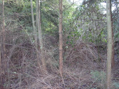

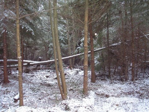

Did a little chipping this weekend and I can only say it is great to take the entire arsenal to the work area (versus draging debris to a burn area) and "git-er-done"
My efforts are to focus on "parking out" the south border with a road cut on the property line. I also needed more firewood due to some colder than normal temps this year and the SWBO's need for a warm (can you say 75º:() house when she comes in from tending the horses.
I knew the trees in the photos fell a couple years ago so I diverted from the SW corner where I started from to the SE corner. I just spread all the chips around to compost. Only got one tree out today but I'm not in any hurry. It was nice to buck-up the tree at chest level for the first 2/3 of the length.:)
