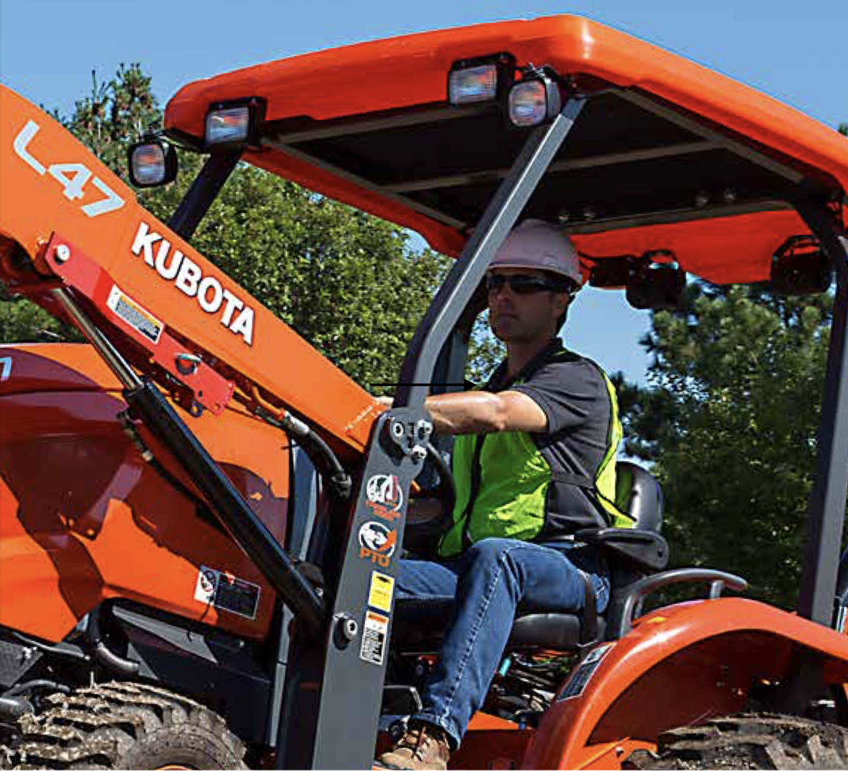

That's odd, I thought that all modern Front End Loaders were made with a safety latch on the FEL boom cylinders so that they could be locked in the Full Up position. But on the exploded diagram (Messicks) for that LA844 loader, I don't see a part to do that. Do some FELs not have the safety lock?
rScotty
I feel like I've never seen that feature on a modern CUT front loader.... Most have deployable stands built in for keeping the FEL up on the air for quick attach/detach. But I haven't seen a lock in "full up" option for the boom cyls.
   / We All Live In An Orange Submarine #42
Maybe it's an optional part. It fits on the pivot of one (not both) of the loader cylinders and then swings down into position to latch. Usually on the left side, so photos of the right side won't show it.
Anyway, because both of our new TLBs have it, I thought it was on everything now.
Our old Farm tractors didn't have it on their loaders - but they didn't have any safety equipment at all.
Now I wonder if it is a TLB thing?
rScotty
You can see it in the adv. photo here. It's the reddish/orange piece pinned to the LH front loader pvot right below the Kubota Label. Basically a heavy piece of steel in a tubular U configuration. Pull the pin and it swings down to latch around the cylinder rod. The basic idea is probably adaptable to any FEL - or maybe it is sold as a separate part. Might require some work if the cylinders are inverted with rod at the bottom.

Something like that would be easy enough to make, if one wanted to lock the loader in an up position.
My Unimogs with the Schmidt loaders have similar hinged setup (both sides) but much smaller.
On those they're only meant to keep the bucket from hitting the ground when going down the road.
   / We All Live In An Orange Submarine #44
My LA1065 loader has it.

My New Holland 50 doesn't have them but I bought a pair from Tractor Mike. Since I don't have the fabricating tools or skills, I thought $100 was worth it for safety.
