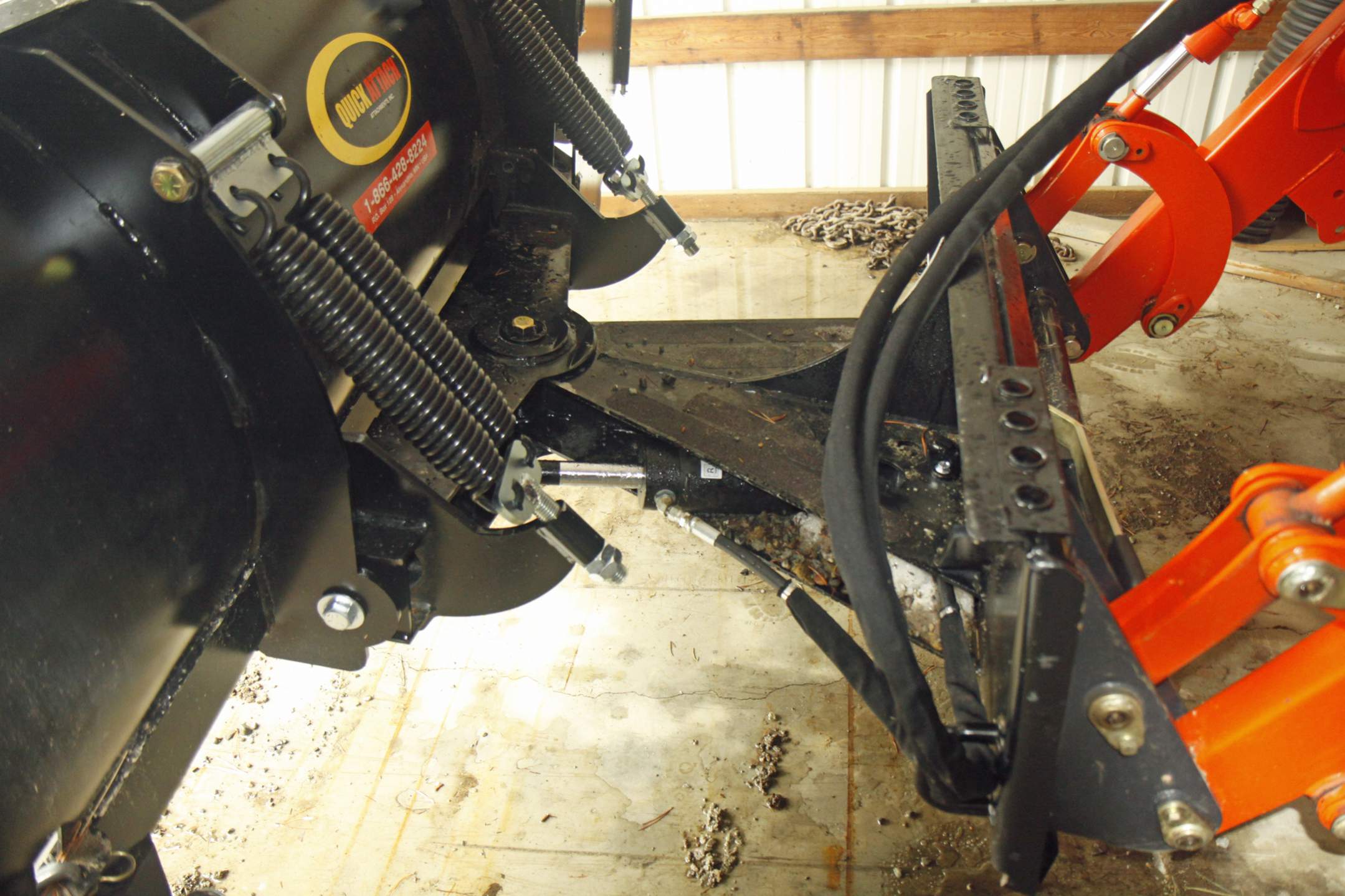

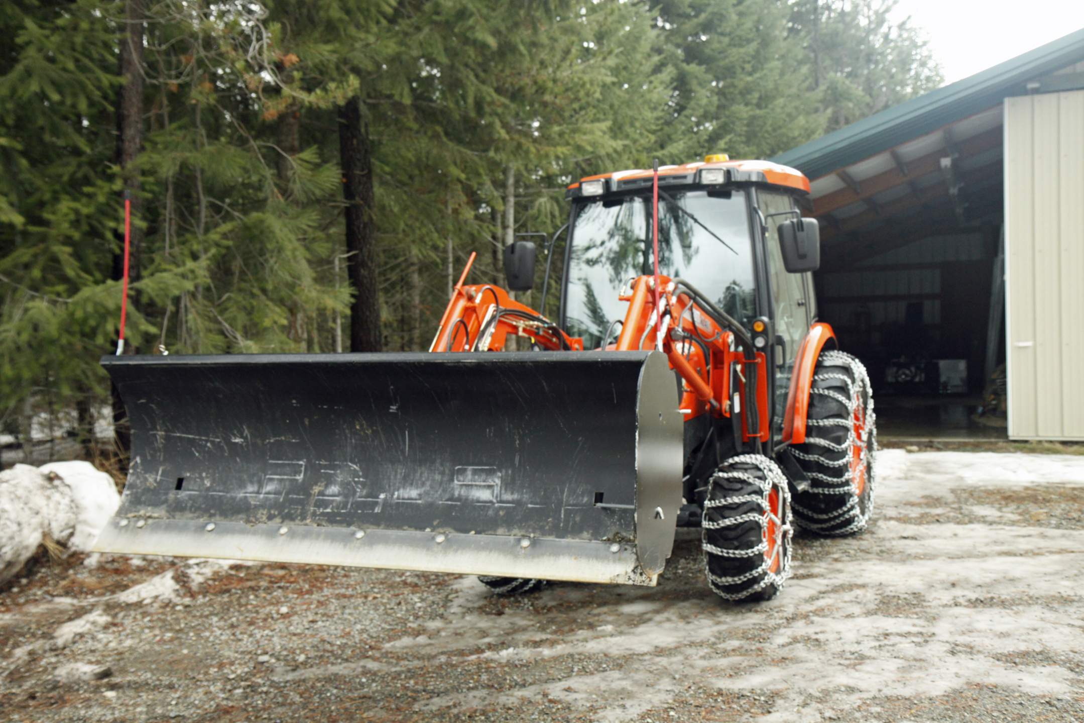

it takes about 2 minutes is all. They are both quick hitch units, and the plow plugs into my 3rd function valves installed by the dealer (though there actually just a set of hoses piped to my rear remotes). The blower plugs into the hydraulic lines that i piped over for winter use from the power pack and an electrical plug for hydraulic controls.
It takes me about 2-3 hours to install the powerpack and route hoses before the winter, then only seconds to attach or disconnect. Come spring ill remove the hoses and powerpack.
the 500# plus powerpack ads nice counterbalance to the blade also.
Oh, OK. So the big setup/removal is done at the beginning/end of winter.

yes, between the powerpack and lines and the chains....that is alot of prep work for one day.
After that its real easy.

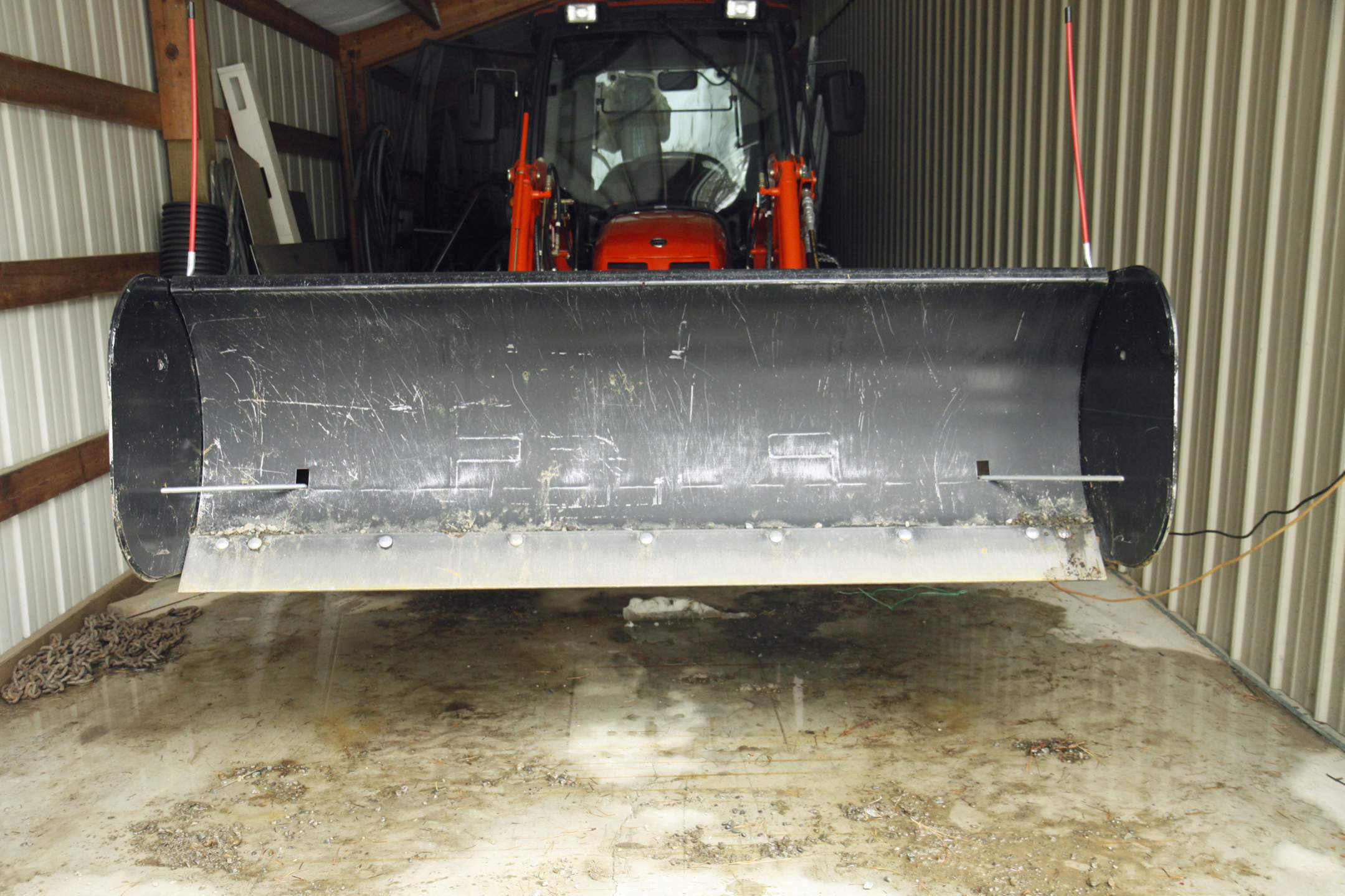

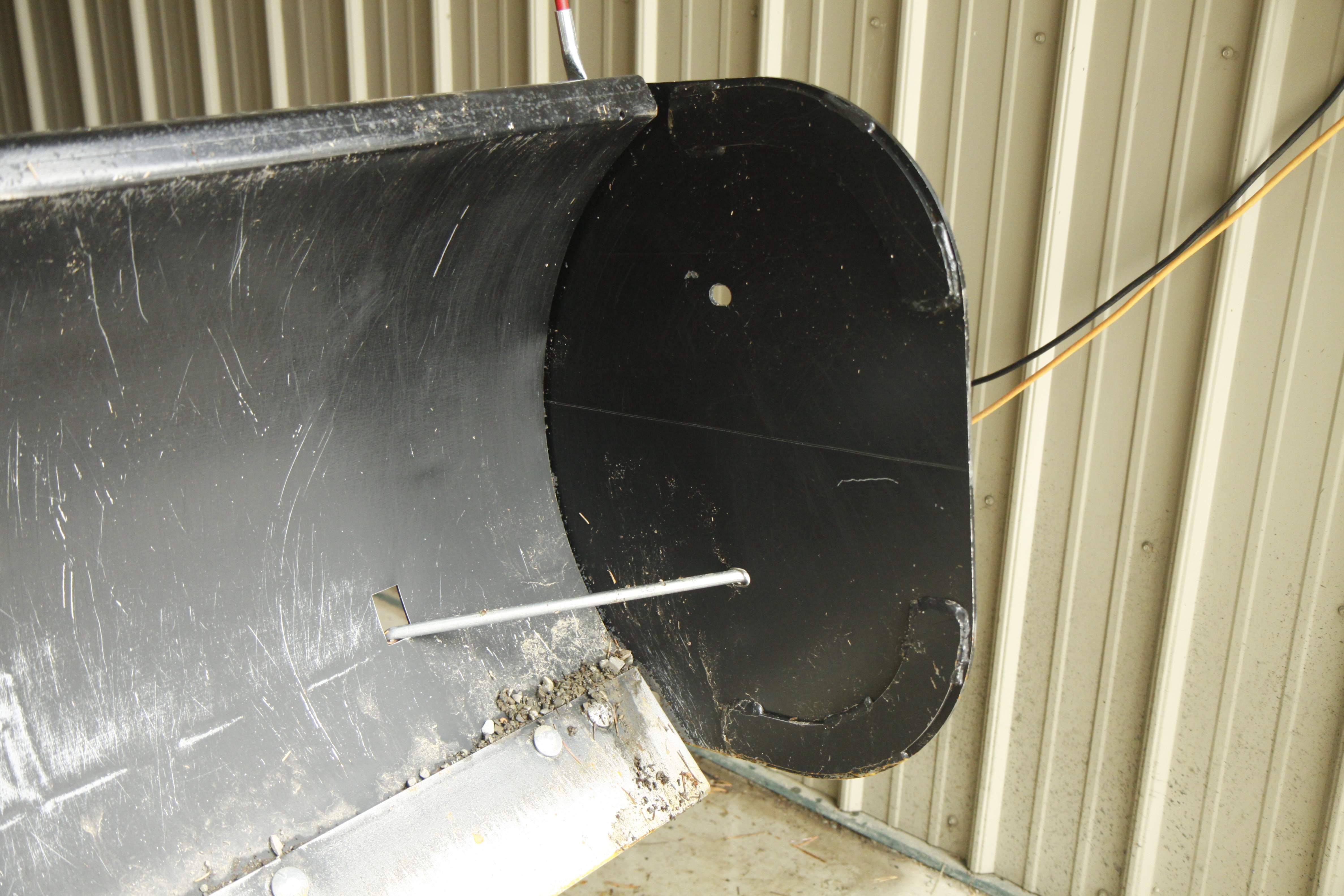

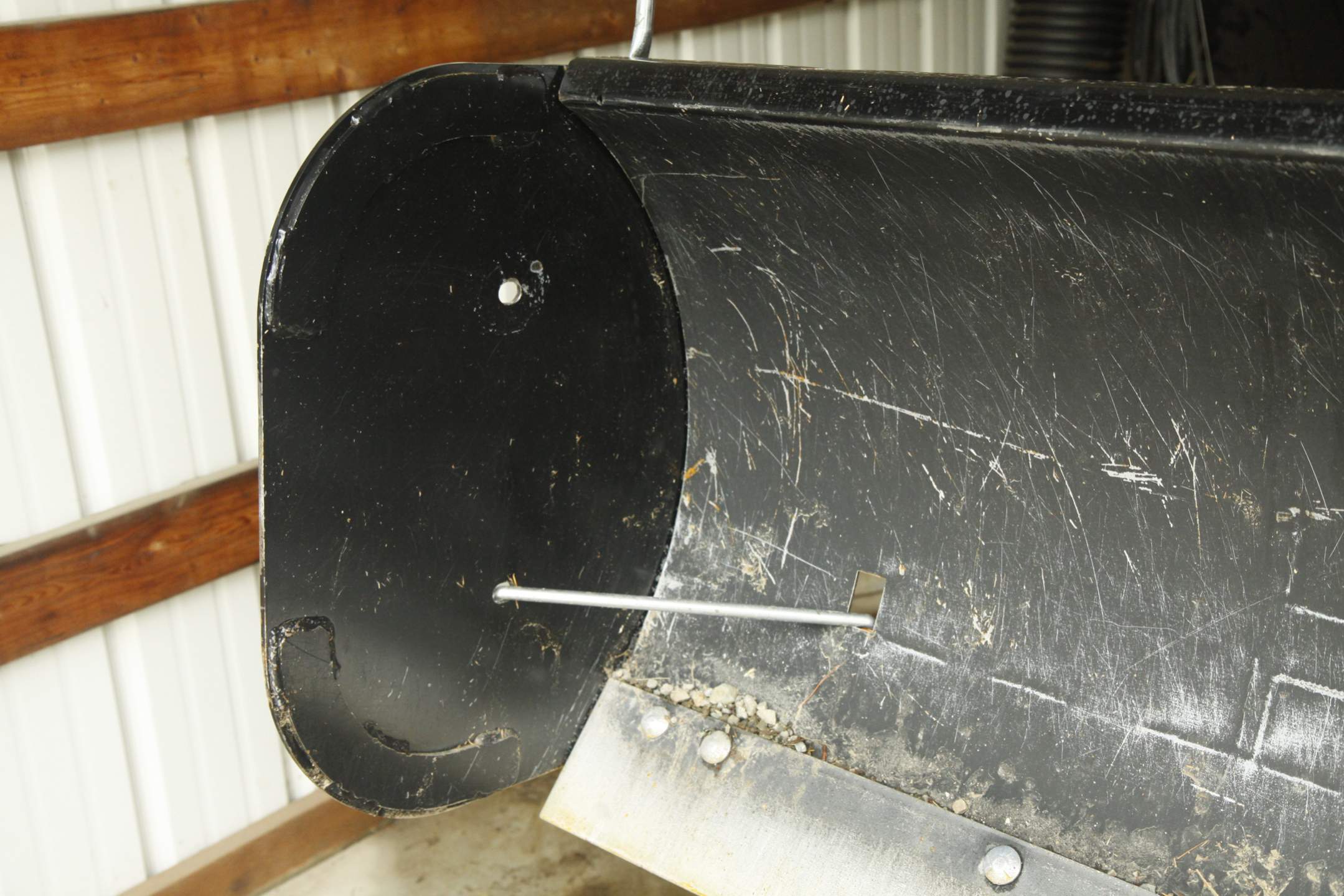

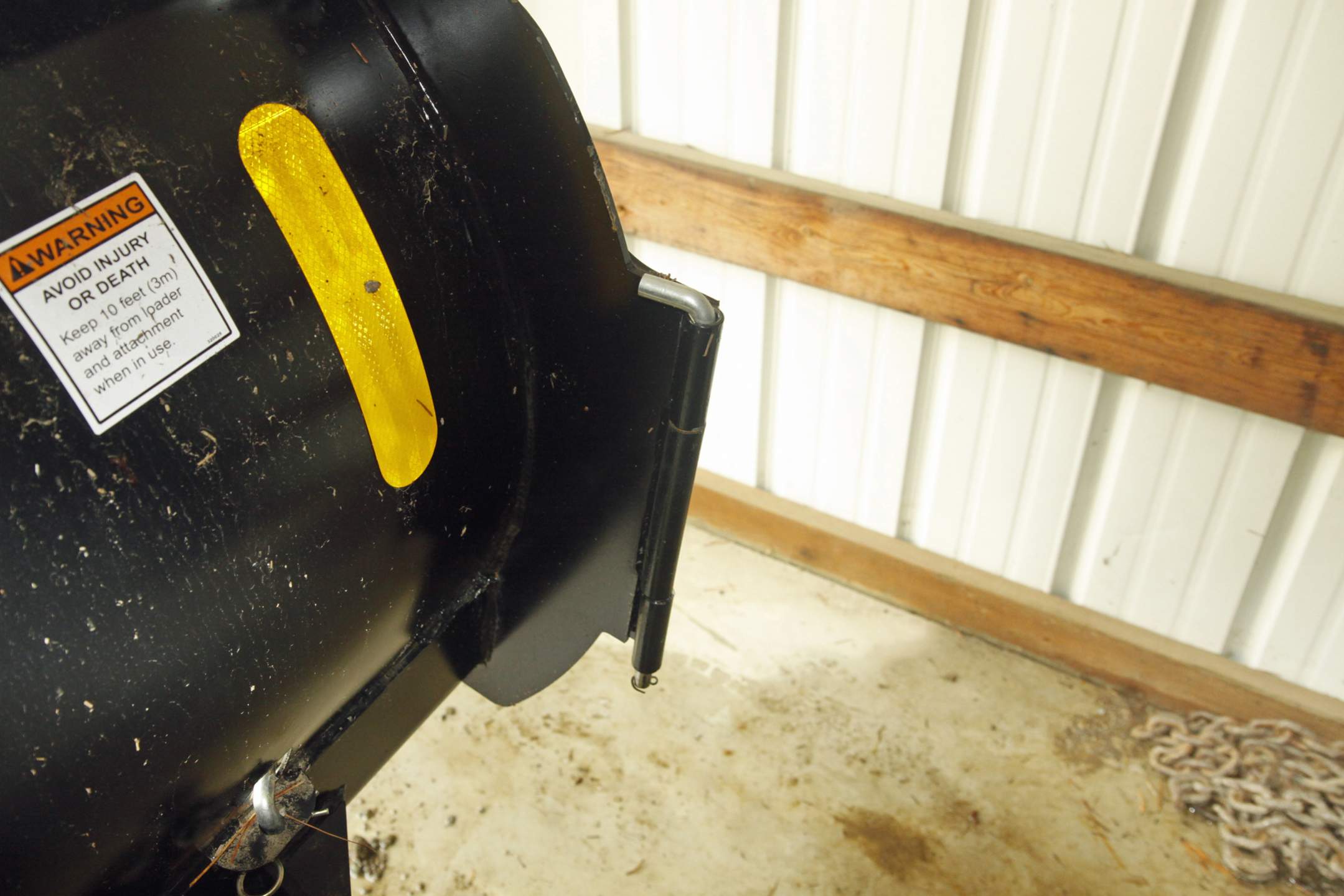

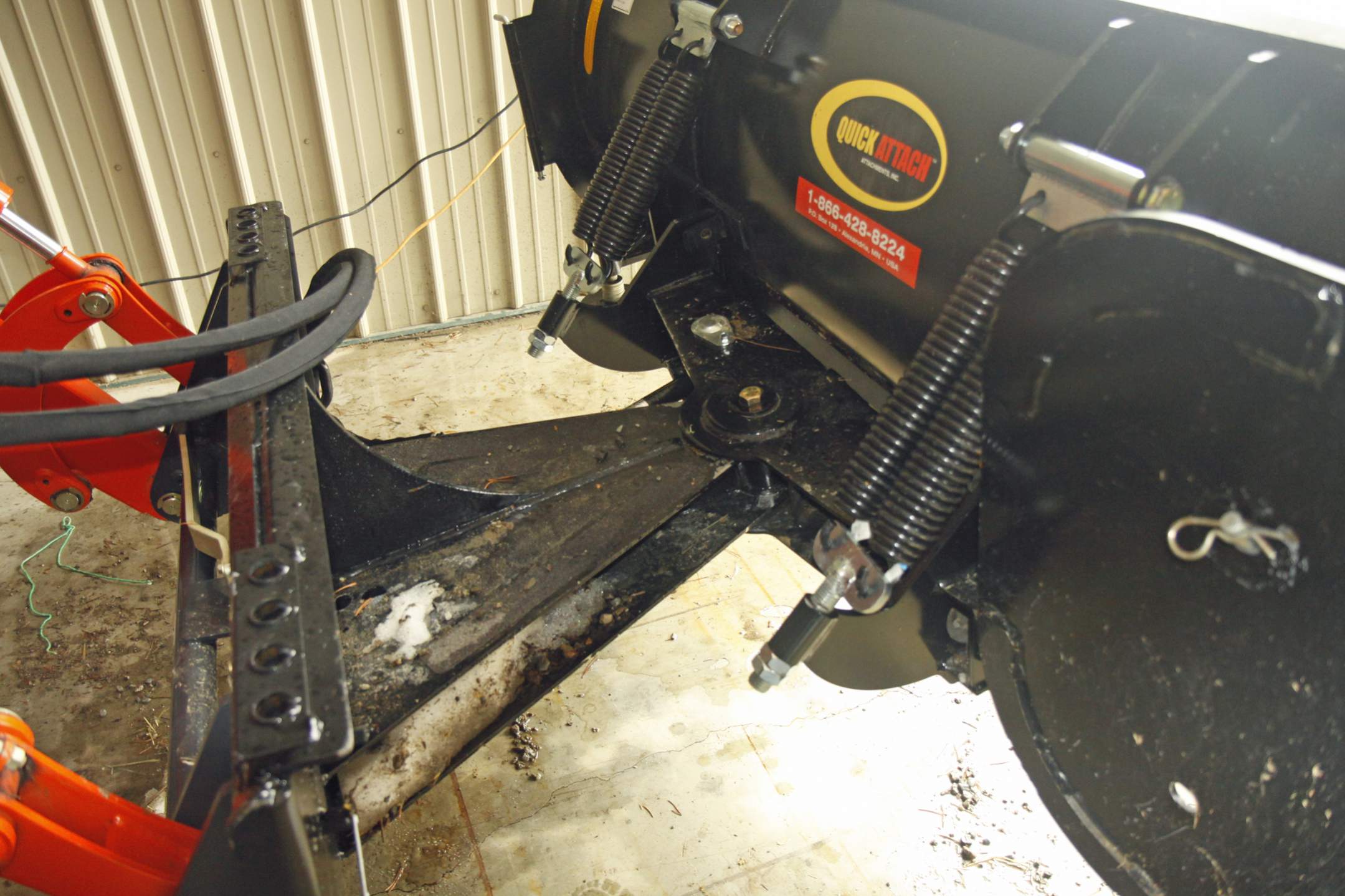

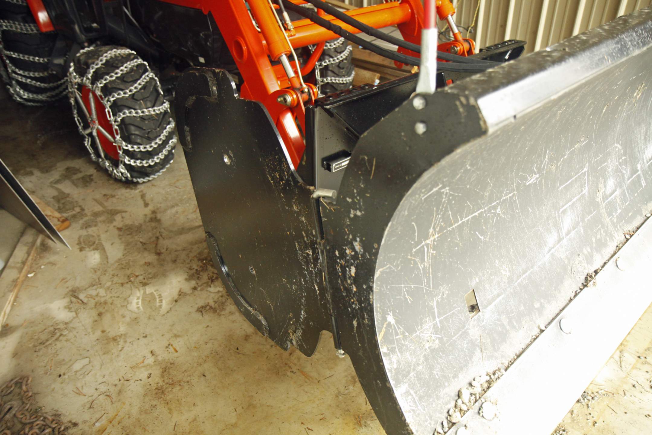

it is a "Quick Attach" brand plow. The end plates are manual. There hinged to stay on the plow and you swing and pin them in place as needed. I have them set to plow the roads in such a way as they only get set 1 time.
I start the plow to the right of center on the first pass and slope so the snow folds to my right side. On the return pass the snow folds to my right side also, but on the other side of the road. I do the same on the next 2 passes. I work from center out so i dont have to reset the gates at all. the great thing is i get no snow ridges left on the road when im done.

If you could, I would like to see more pics of the end plates, both open and closed.

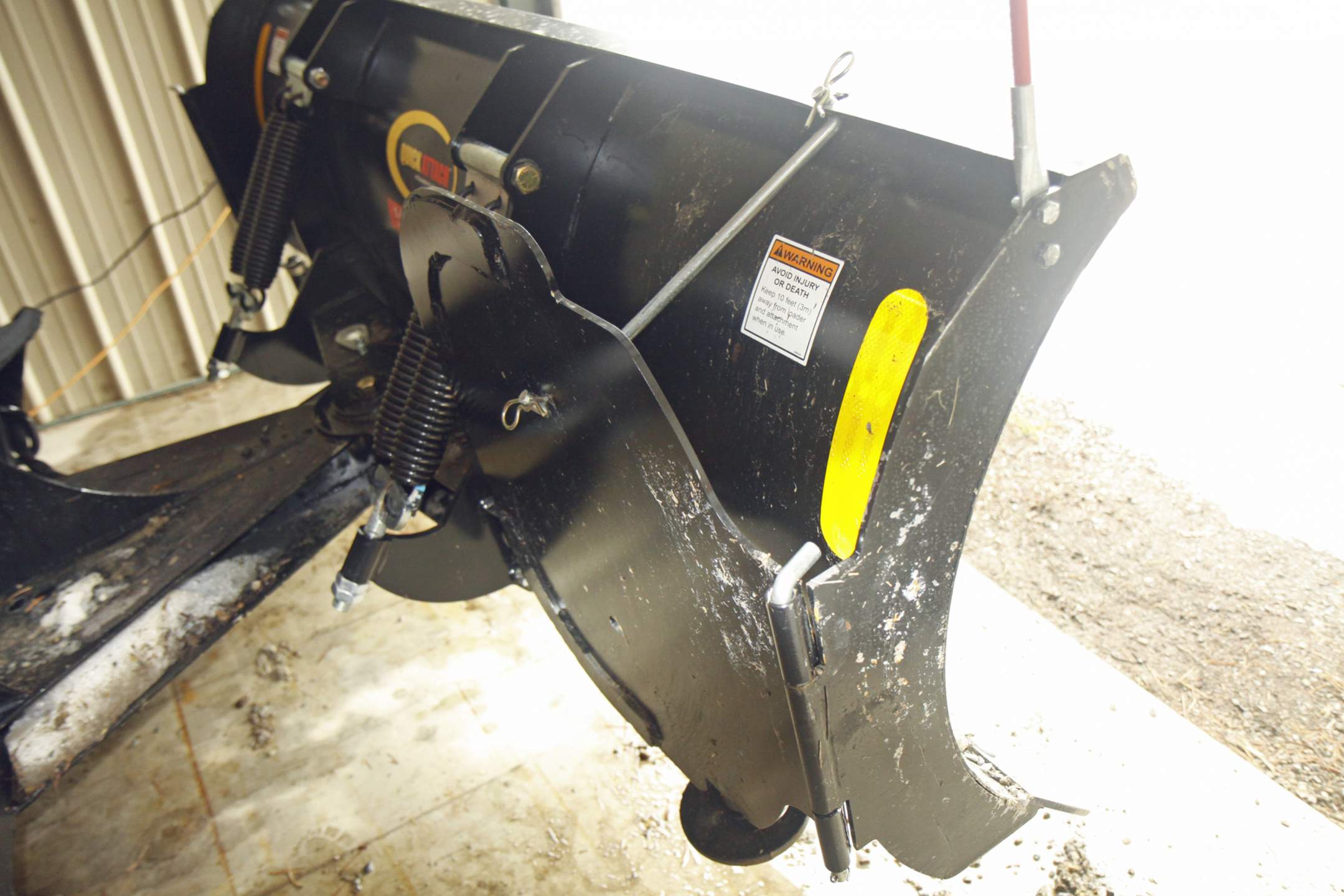

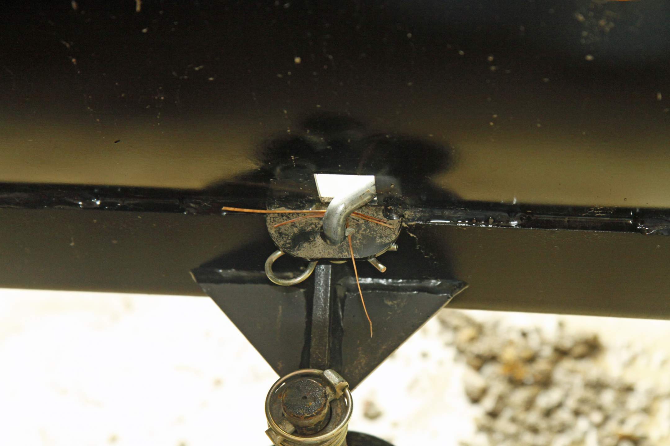

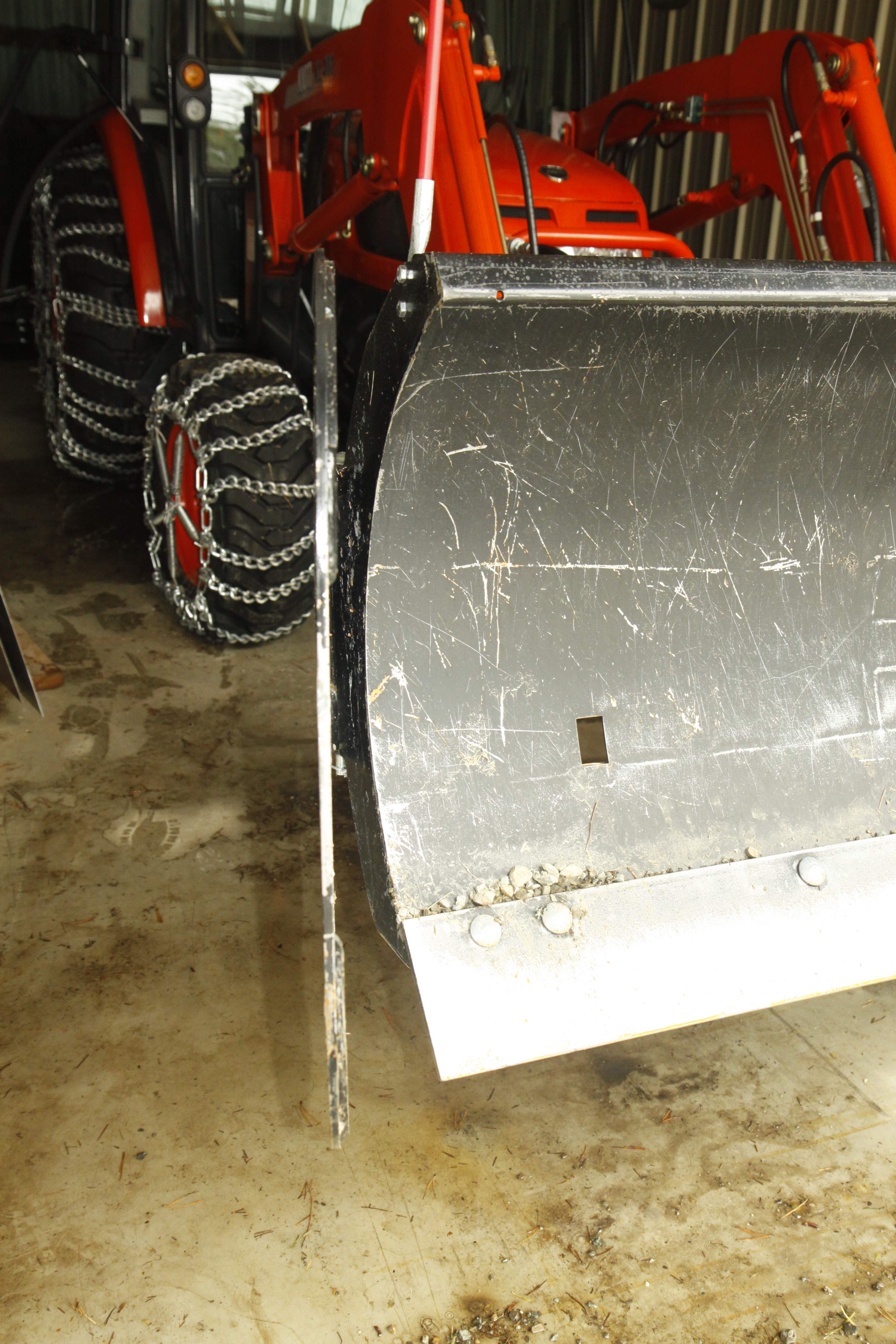

sure. i took some, hope they are what your looking for. I have pics with both rotated out to form a snow push. Both the right and left snow gates are pinned in place. Then i rotates one side open to set it as i am using when i plow. I leave 1 gate closed to prevent snow from flowing out over the edge back onto the road,

very nice setup!!! I have a 2008 kioti DK45 Cab with manual trans and have plans for the same set up, plow for quick work and loader mounted blower when we get big storms. my question/thought is to mount heavy caster wheels on the plow and blower for the early/late storms. i just plowed today and the plow rips up the gravel even with shoes, which digs ruts. any thoughts on this? thanks, keep the pics coming

i meant to ask another question, does the plow have a hydraulic relief valve mounted on it like so many on here have talked about? thank

yes, uses hyd relief valve so theres no need for shear bolts. Casters would be nice..i may fab some up for the same reasons for next season.
