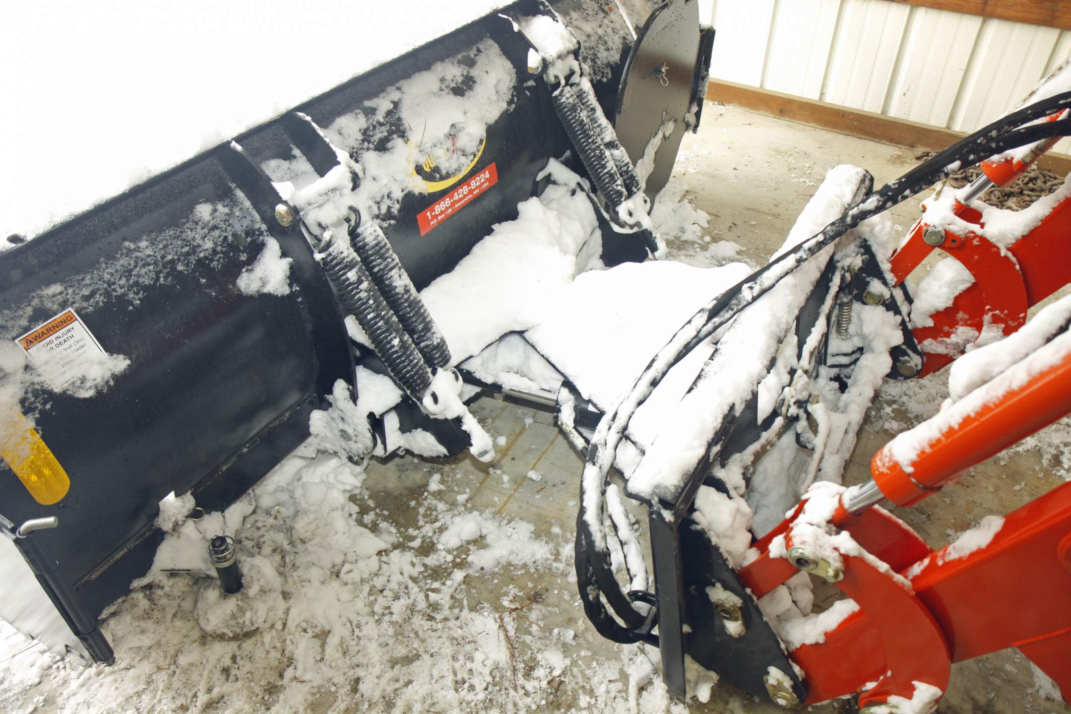

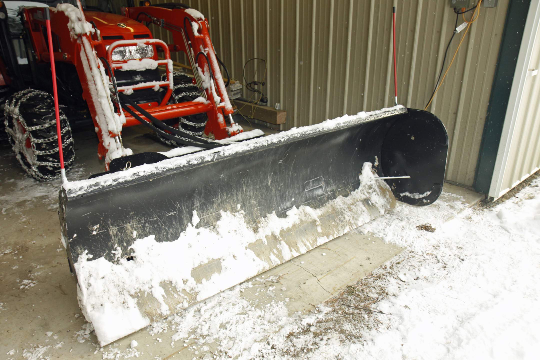

i dont remember if i posted any pics of my snow blade..oh well i do so again. I went out and took a couple of pics afte i used it.....the poor thing looks so cold.
The plates on both side are swinging side gates to keep snow from falling over the side, or for changing blade into a snow pusher.

Ok. Details! What brand of plow is that? How are the end plates operated? It looks like they are manual and pinned in place.

it is a "Quick Attach" brand plow. The end plates are manual. There hinged to stay on the plow and you swing and pin them in place as needed. I have them set to plow the roads in such a way as they only get set 1 time.
I start the plow to the right of center on the first pass and slope so the snow folds to my right side. On the return pass the snow folds to my right side also, but on the other side of the road. I do the same on the next 2 passes. I work from center out so i dont have to reset the gates at all. the great thing is i get no snow ridges left on the road when im done.
Heres a link to site
Snow and Light Material Blade : Quick Attach Attachments, Inc.
theres a pdf link there that shows more detail of it.

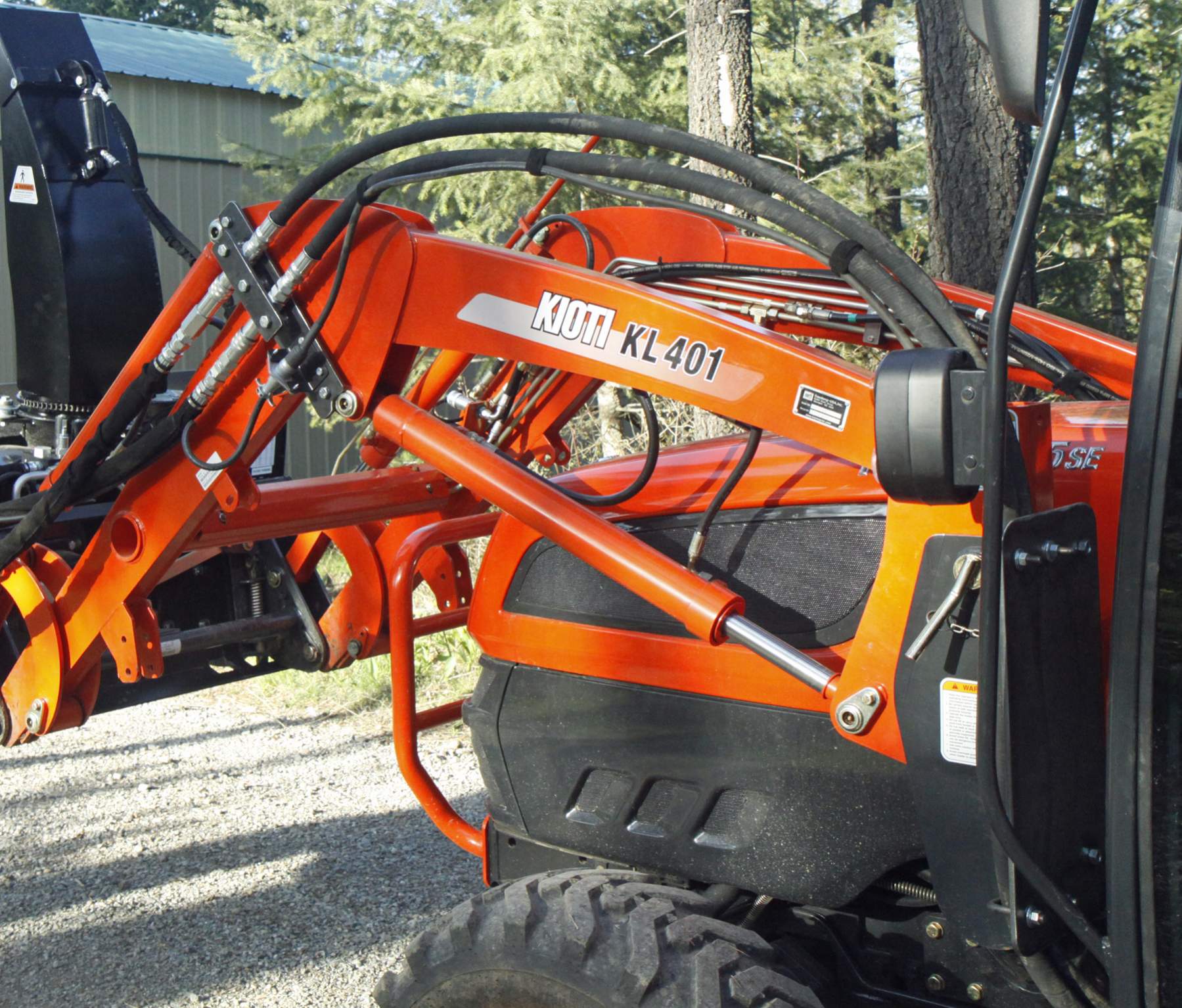

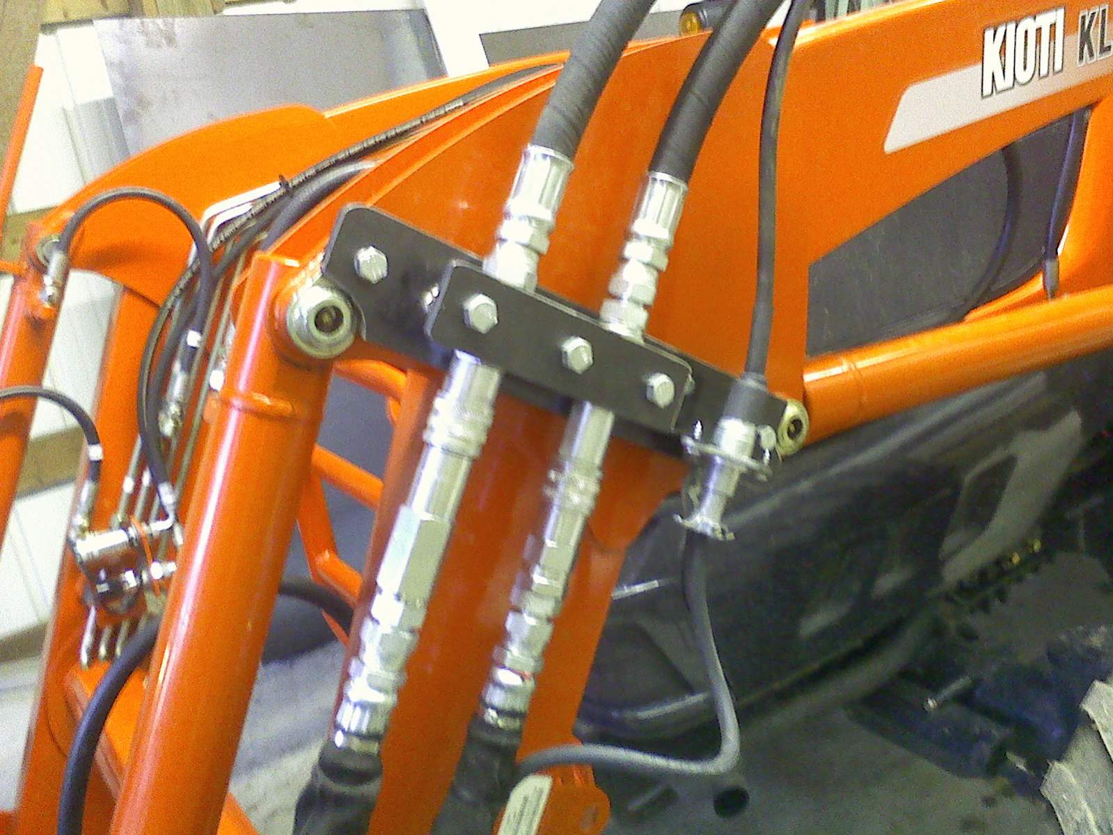

it takes about 2 minutes is all. They are both quick hitch units, and the plow plugs into my 3rd function valves installed by the dealer (though there actually just a set of hoses piped to my rear remotes). The blower plugs into the hydraulic lines that i piped over for winter use from the power pack and an electrical plug for hydraulic controls.
It takes me about 2-3 hours to install the powerpack and route hoses before the winter, then only seconds to attach or disconnect. Come spring ill remove the hoses and powerpack.
the 500# plus powerpack ads nice counterbalance to the blade also.
