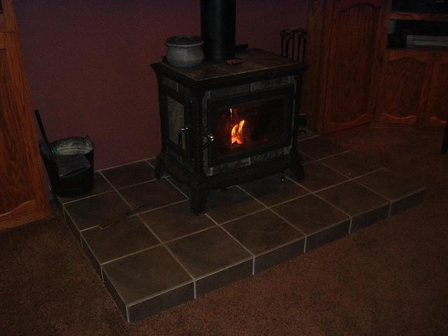

I had a pretty toasty fire going last night. Around 5:30 I threw in some crumpled papers and piled up the few pieces of charred wood that was left from the night before on top of the papers. I put a 6" log on each side of that about two inches apart and placed a 3rd log on top of that. I lit it up and it started O.K. but kept going out before the logs lit up. I just kept shoving paper in there and the coals would light them up. After about the 3rd sheet of crumpled paper, it stayed lit and burned all night. I leave the door open just a crack while I start it and for about 10 minutes until it starts making that roaring sound. Then I closed the door and left he air control all the way open. There is a small air vent at the bottom center of the stove that blows air away from the door and right down the center of the stove. That works well to blow air onto the fire between the bottom logs. The manual says not to leave the air control full open for more than 30 minutes and I can see why. The flames were intense! :D I closed the air control all the way down and then opened it two notches. The logs burned pretty nice for 3 hours. By then, the top log had collapsed in between the bottom logs and made a nice bed of coals. Just before 9:00 I stuck two more logs on top and started counting. A bit of water bubbled out of the ends, so I know they are not dry enough yet. But after 120 seconds, poof! They burst into flames. When I went to bed at midnight the house was a comfortable 74 degrees in the dining and living rooms and the two kids rooms. Our room, directly over the stove and with the exposed pipe that has not been enclosed in a chase yet was toasty. The floor was warm to walk on. We slept under a light quilt. It went down into the high 30s last night. The house was 72 when we woke up and the fire was out except for a few coals. I think this will work out well. :D

Nice stove, Moss. That looks very similar to the Quadrafire, although I didn't check to see the technology on the inside.
Blower: It was painful for me to spend the $250 on the blower, but I'm glad I did it. With our old stove, we just had a fan we pointed at it. While the fan did pretty good, it was always getting in the way. Also, on the warmer nights, we just let the fire go out in the night. The fan would keep blowing, but the blower has a thermostat on it, and it turns on/off automatically. The nicest thing about the blower, though, is that it really circulates the air through the baffles in the back and across the top of the stove, making the transfer efficiency better. Oh, and the blower is really quiet -- you can hardly hear it.
Kindling: When I'm limbing the tree, on the bigger branches, I'll start about 32" (or more) out, and cut the limbs into 16" pieces while they are still attached to the trunk. These get stacked mixed in with the regular firewood, and I always have kindling ready and easily accessible without having a separate storage place for it.
Fire starting: While I can make a fire with just paper and kindling, with my branches for kindling, it can be hit and miss. Rather than messing around with that, I buy the little wax fire starter cubes for around $3 per box. My kindling can be up to 1.5" in diameter and start light with no problem. Paying $0.10 to light a fire with no hassle is worth it to me. Two boxes will last me all winter -- once it gets really cold, the only time the fire goes out is when we go on vacation or clean out the ashes. My father in law will use the easy starting charcoal at times, but it can be messy, and once that stuff gets old, it doesn't light as well.
Firewood Storage: I have enough room next to my stove to store 1/2 a cord of wood (2x4x8). I used to store the wood there, but I noticed a huge increase in the number of spiders in the house. When I found termite evidence in the attic around the chimney, that was enough to convince me to stop storing it in the house, especially after the exterminator bill. Now only an armful gets carried into the house at one time, and the one or two pieces that won't fit in the stove go into the storage area.

Great stove Moss. the gentleman who compared it to Quadrafire is right on. All those stoves that have a secondary top air inlet to burn gases are about the same in their construction. I can get an extra 3 months of burn from the same amount of wood that would only last 4 months with my old Timberline. You have a great firewood making technique with just about the best wood you can get for burning. I'd kill to have a locust stand such as you desribe. If the wood splitter was one of the best inventions to come along, when is someone going to invent the "wood stacker" where you just throw the wood into a hopper or something and the machine stacks it 4' high.
