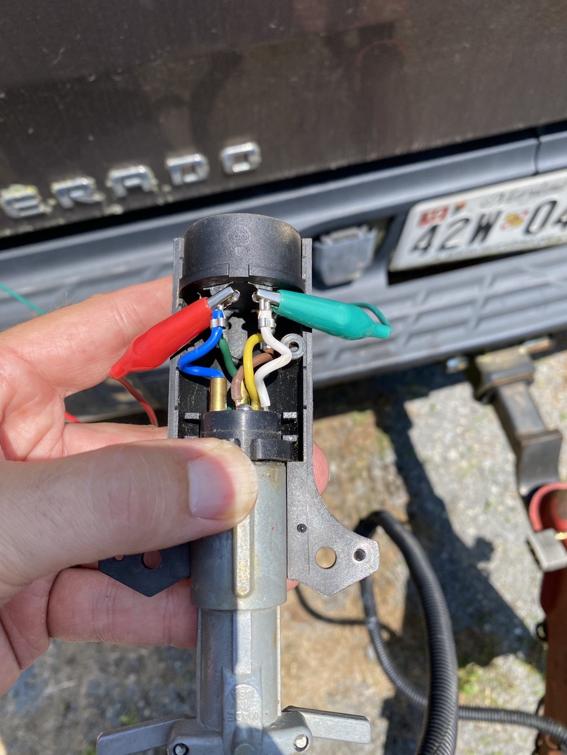

I just checked my trailer, my ground is good. It has welded on stud, I took wire off and wire brushed and reinstalled. I just checked and I’m getting variable voltage from my brake controller. I removed 7 to 6 pin cover to access brake and gnd wires. View attachment 809558Tires still not braking. I only have brakes on back axle on 7k trailer, but normally don’t haul much over 2k.

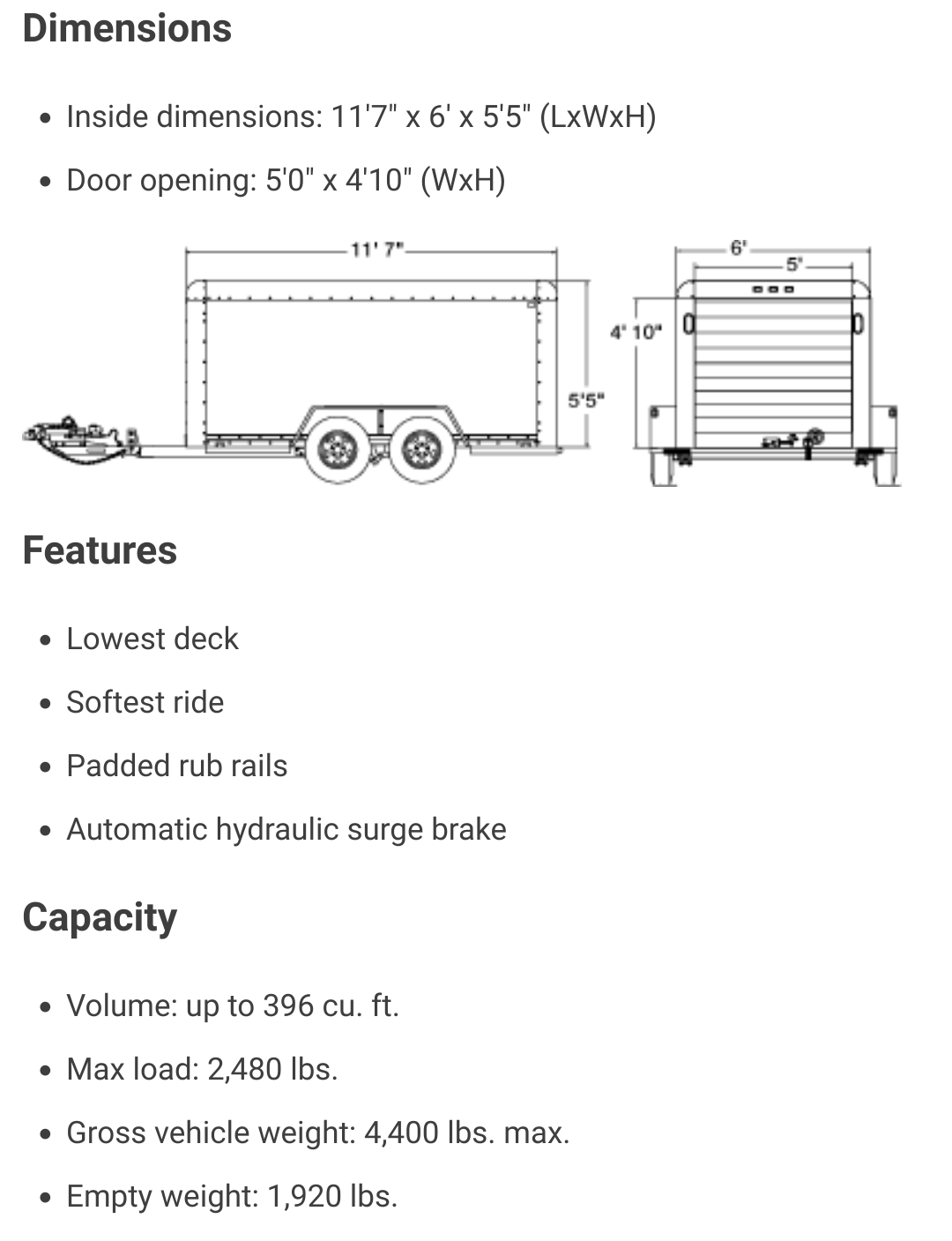

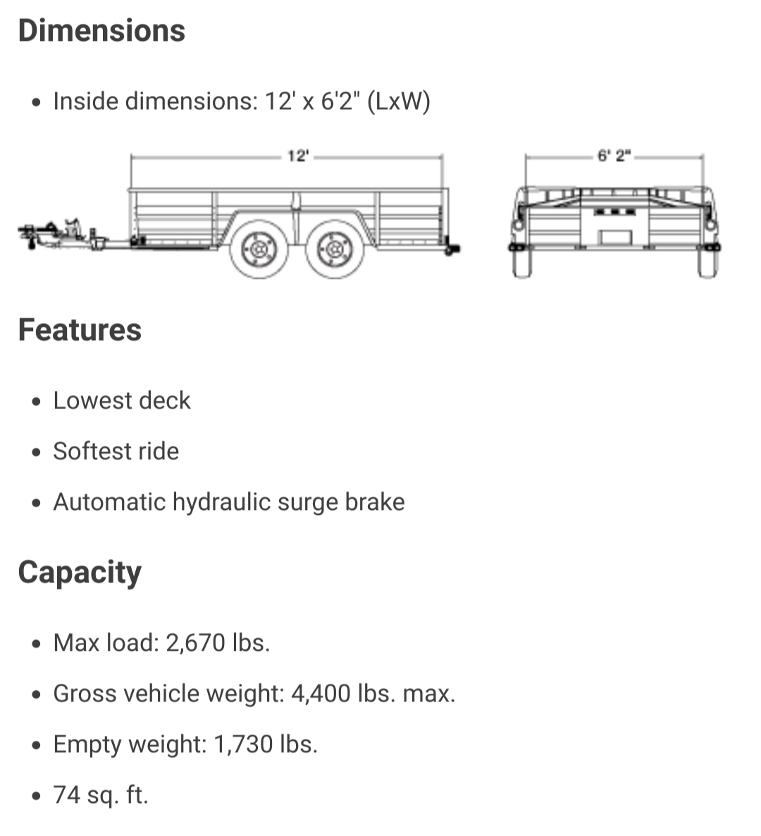

The U-haul 6x12 trailer has a 2,000lb payload. Exceeding that with a household move is pretty easy.
2000#? U-Haul says 2480-3710#:
I know a mattress doesn't really weigh much but, dishes, books, etc. really add up fast.
Most of the passenger vehicles that pull them do not have a tow rating, brakes, or tires to support the weight of the loaded trailer. So that, combined with low driver skills with a trailer, generally ends up in disaster.

The ground connection should be in the plug on ANY OEM or aftermarket trailer plug, as I said before, if you are relying on your hitch and ball to provide a ground for your trailer no matter if you have a 4, 5, 6 or 7 pin trailer plug you're doing wrong
99.9% of the time if there's a problem with the OEM wiring on the tow vehicle 6/7 pin connector it is an older one where Chevy used a different pin out than everybody else for a while.
I have several co-workers with vehicles that have built-in brake controllers, they all say that the built-in brake controllers are significantly better than the aftermarket ones and they did not have to do anything to their OEM trailer wiring to make it work (aside from some manufacturers or you still have to put in a fuse), otherwise it's just plug in the trailer and go.
