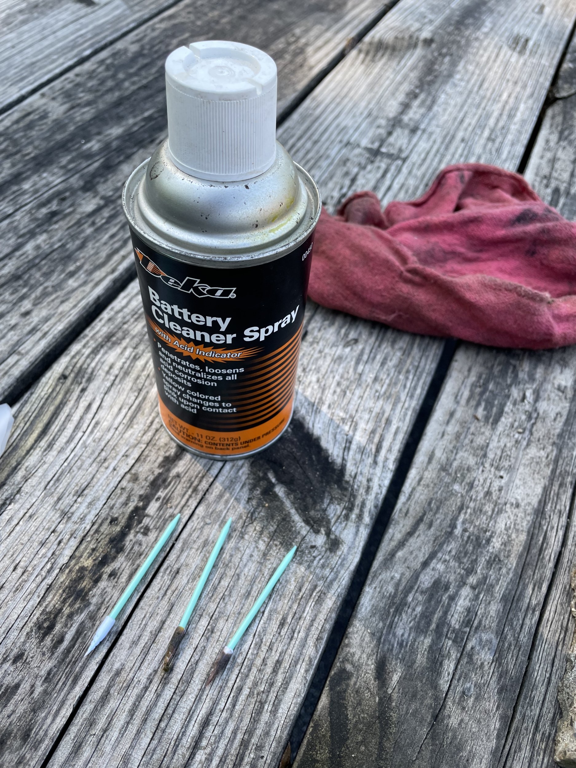

I’m not trying to hijack this thread but maybe will help. I fixed mine today, probably. When I used it a few days ago I noticed the trailer side plug in looked a little funky. I cleaned it today and the truck side with a battery terminal cleaner and this detailing sticks which are just fancy Q Tips. I bought a variety pack of those detailing sticks several months ago, kind of designed for cleaning nooks and crannies. The picture is what I used to clean the plug, two of the Q tips next to a clean one.
I jacked up each side of the trailer and had the wife manually hit the trailer brakes with the controller turned up on high and the brakes grabbed well. I say probably fixed it because I drove it empty and it seemed better and would lock up the brakes on gravel. I looked in the owners manual that came with my trailer which has Dexter axles. It said the brakes are auto adjusting being driven both forward and backwards. Sounds like all Dexter axles have been this way since about 1996.
