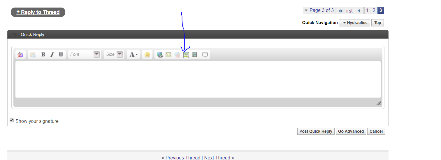

/ Weak Ford Backhoe #29
Not sure from an I phone. And dont know if you are using mobile site or app.
From a desktop (or on my android but not viewing as mobile version) click the picture icon at the top of the reply box. Then find the pic on your phone and upload it.
/ Weak Ford Backhoe #30
How do I attach a picture from an iPhone?
My phone won’t let me post a screenshot otherwise I’d offer a coloured on screenshot. The icon is at the bottom of the page not top.
