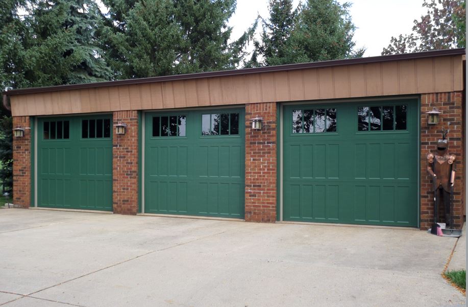

I bought these sectional doors by Amarr through Costco's discount partner program. They are fully insulated with double glass. Good seam seals between panels and the floor and sides. The main benefit to me has been reduction of the intense heat buildup in the garage from the direct sun load. It's no longer an issue. Well sealed, no cracks or spaces for light to come through. They are about 3 inches thick. Nothing froze this year in the garage despite the very harsh wind and cold temperature. I hate burst frozen beer cans spewing suds all over. What remains tastes awful.
What we did was to take a picture of the old garage openings and superimposed several new door, window and color type options until we liked the look. What we got was exactly what we wanted. I was surprized to see that the style and windows I thought I wanted looked bad when compared to the rest of the house and garage style. So getting the right 'Look' was important for us. Its even better than imagined.
You can minimise the opener intrusion with the new types which mount a rollup drum just above the door.
