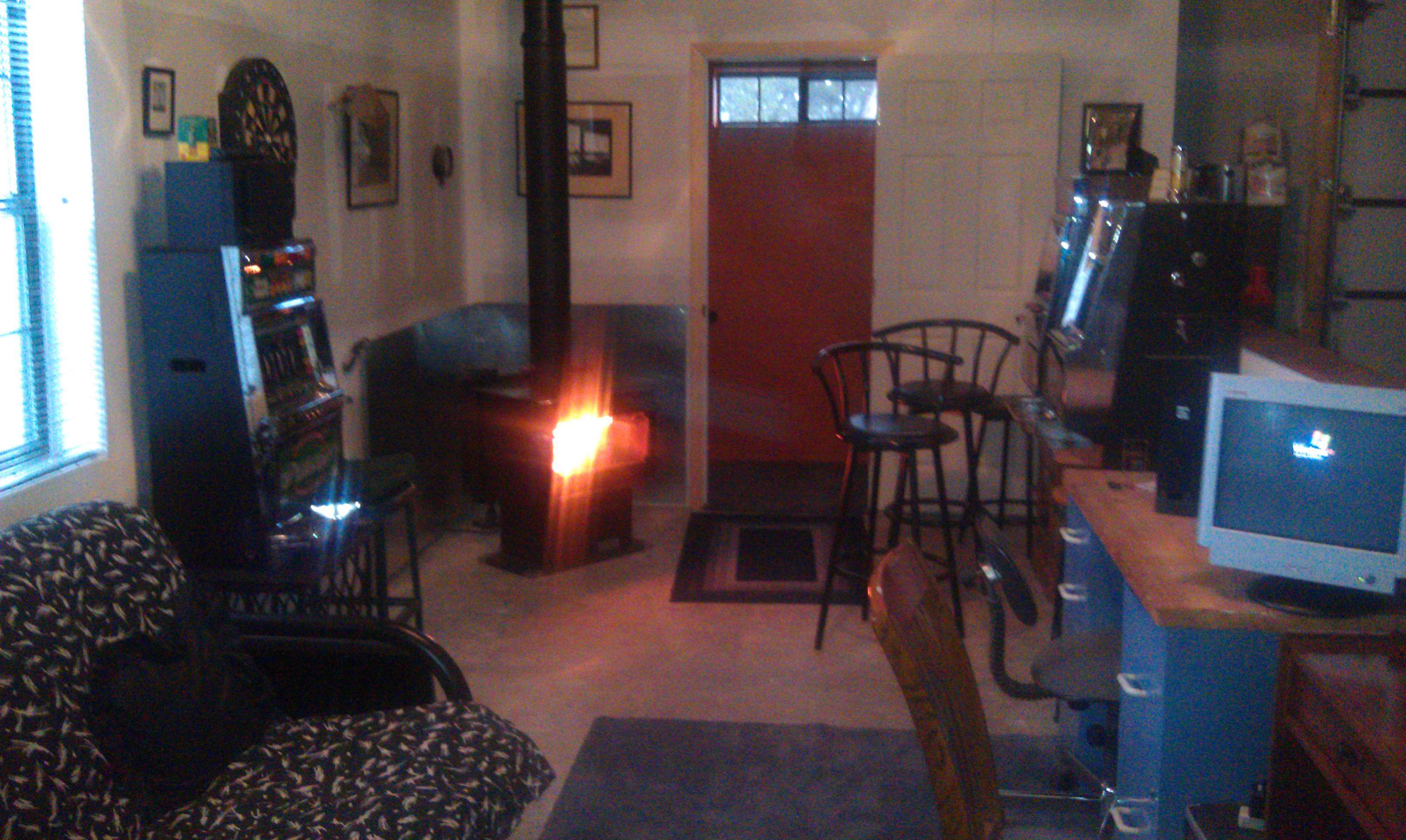

I have an office and game room elevated 2' above and to the side of the shop area. I use a wood burning stove for heat. My shop hasn't gone below 40 degrees even without the stove going.
