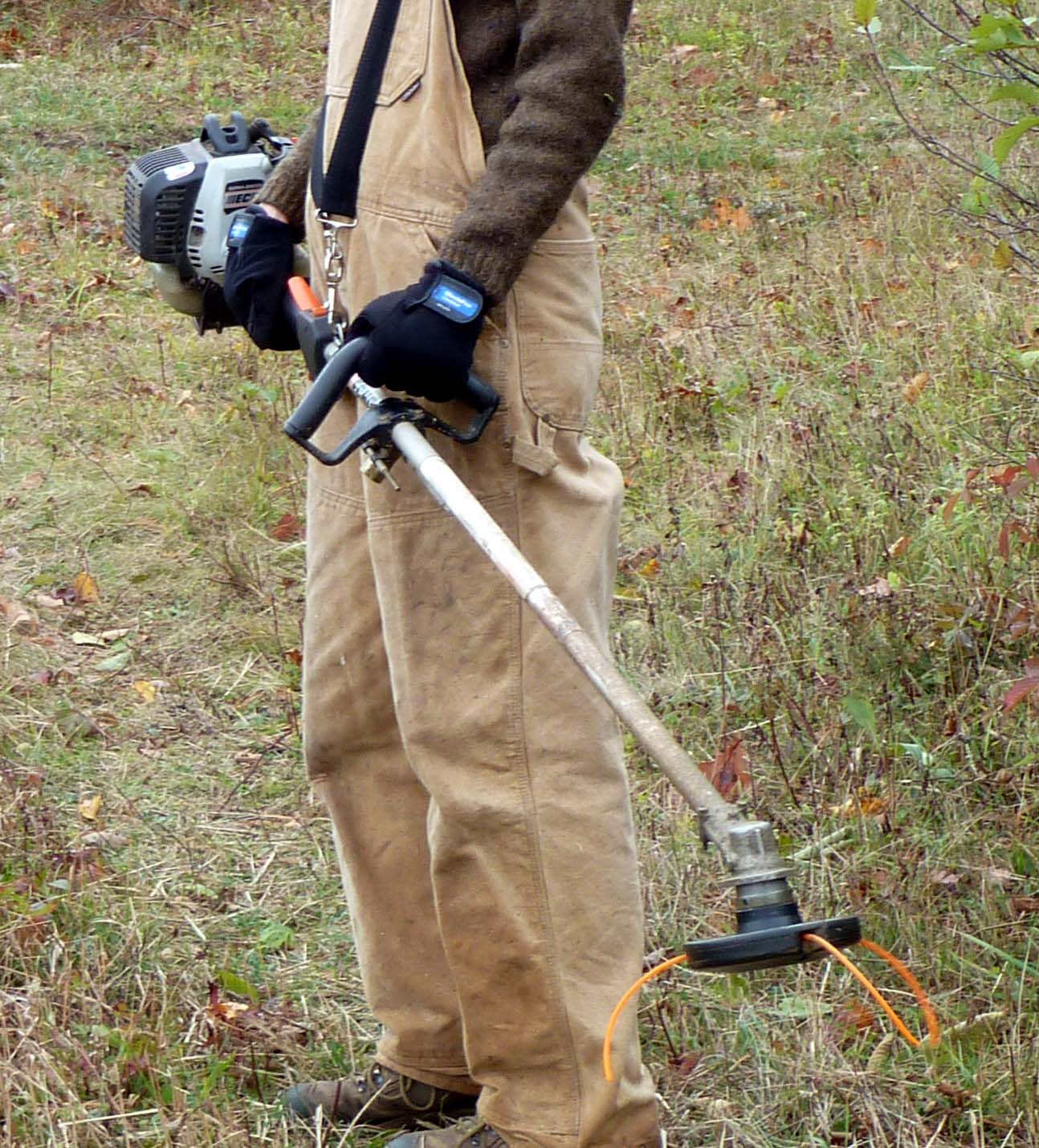

We use Echo's and Honda trimmers. I personally don't like the Honda's because of there increased weight and when in the field, we like to bring just one type of fuel with use. (I have had people along and confused about the difference) Our Echo's are the power unit types so ends can readily be switched out. For head styles, we bring several types along so we can handle whatever type of weeds or brush we encounter. Most of the time the heads we use hold three .155 strings and are made by Oregon. These hold strings via cam locks and we've had very good luck with them. We have about 5 of these in use today. I'll attach a photo on one. We also bring steel cutting heads that work well for small brush and trees. Sorry but I can't find a photo of these. We also bring chain saw type heads along.

Same as you, we found the steel cutters have a much smaller cutting radius which really increases our work time. Plus, everywhere we work, the ground is strewn with rocks and steel blades are sparking off like the 4th of July. This forces us to cut everything taller while using the steel blades. This is the reason we love the Oregon heads with the 155 strings. We run them right against the ground, rocks or not, makes no difference. And there cutting radius is much larger, plus we can train someone to switch out there strings in 60 seconds. We still need to steel blade for the pen sized shoots (and larger) but the strings are used 90% of the time for the reasons mentioned above.
