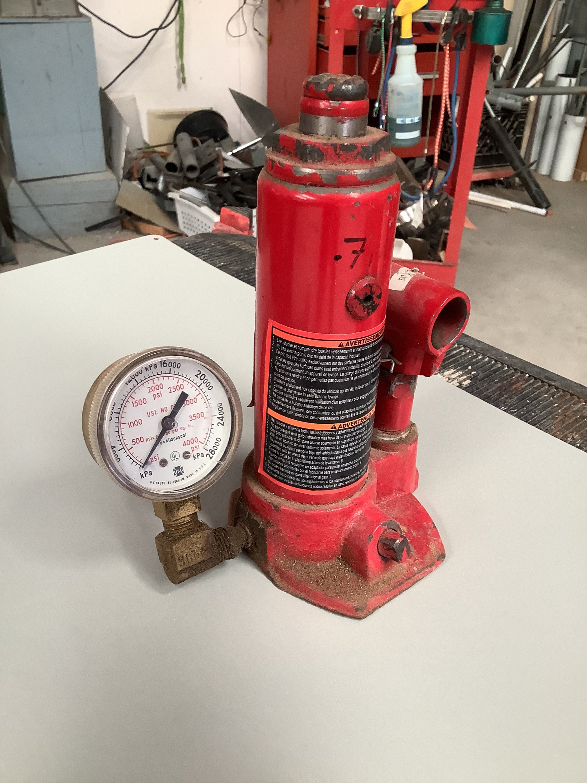

Or for a few bucks you can build your own tongue (or other item) scale. Buy the cheapest 2 ton jack you can find. Drill a hole at the base of the cylinder. Most have a flat spot that is perfect. Thread it and install a pressure gauge. On mine I measured the ram size and calculated that I needed to multiply the gauge reading by .7 to get the actual weight.

orezok, good idea but what if that ram has a larger piston inside?
   / Weighing tongue weight at home. #17
All you would have to do is put a known weight on it to get the correction factor.
Bruce
You measure the size of the ram bore and calculate the square inches. Dia. x Dia. x.7854 gives you area. In my case that was .7 in so I multiply the gauge pressure by .7 to get actual load. PSI x area
