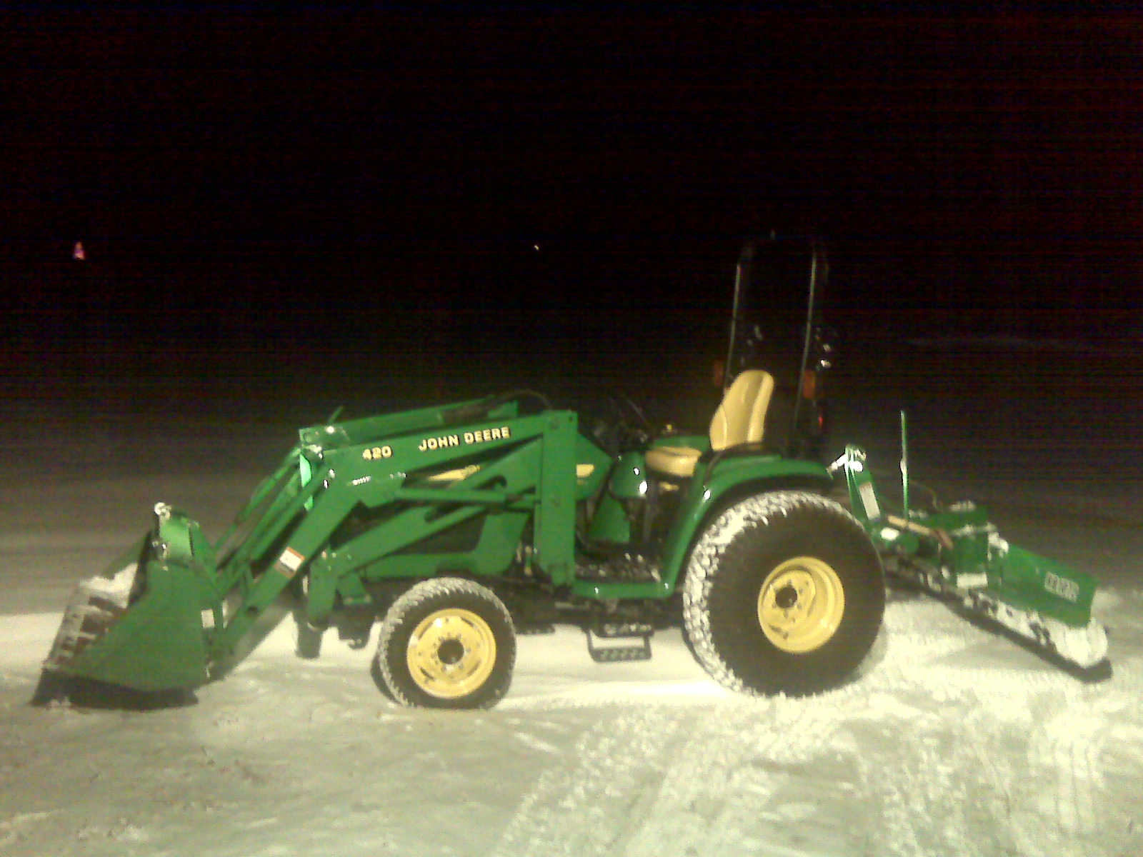

I have a 4210 with the factory FEL and a 72 inch Frontier RB, tractor has FWD but no tire loading, turfs, I never use chains. Concrete weighs about 120 pounds per cubic foot, not sure how big your weight box is or how full though. My RB weighs about 280 pounds, hangs off the 3 point a lot further than a weight box would. I use the RB for about 80 percent of the snow removal I do. our 700 foot driveway and five of my neighbors driveways, prefer to push snow off at an angle rather than scoop and dump with the FEL.
A weight box is useless for moving snow except as a traction assist, the blade will be a much bigger aid than just weight in the back. Hope this helps.

Should have included this pic with my reply, sorry...
