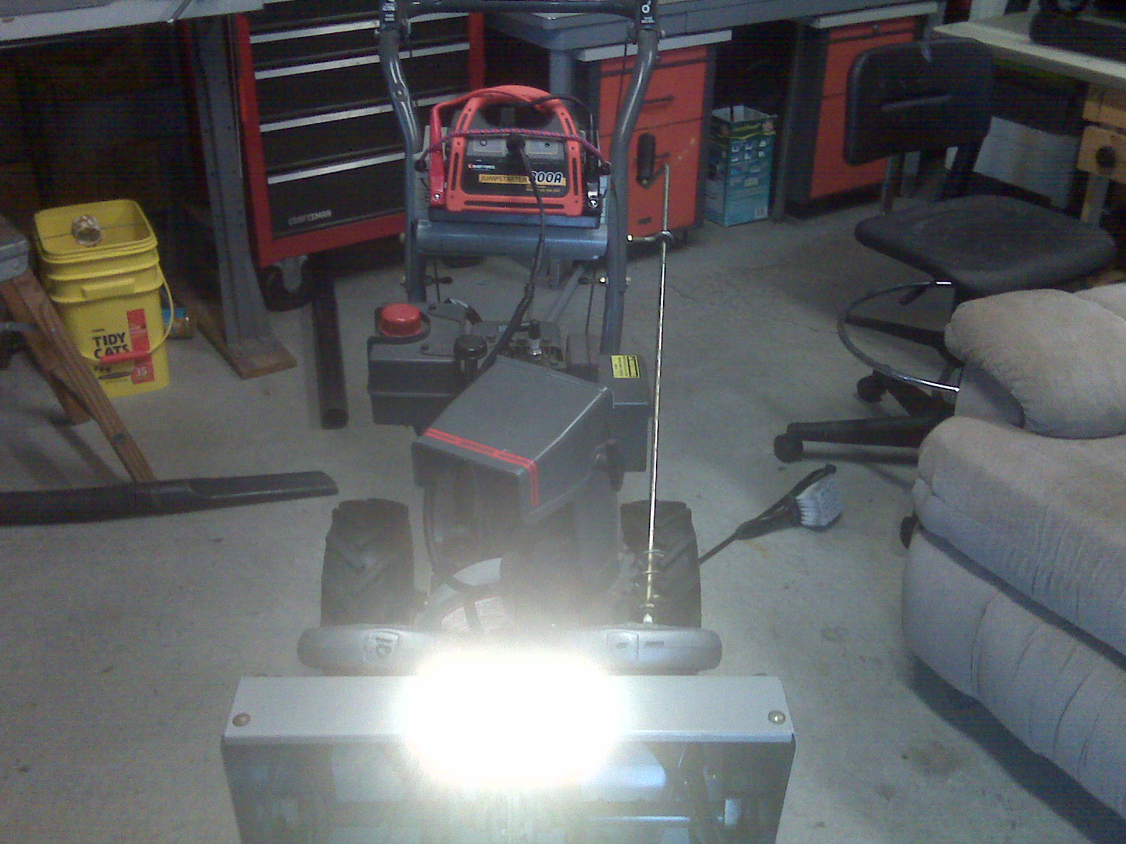

Here is a pic of the pair of barbell weights mounted on the auger housing of my snowblower...they help keep the front end from climbing hard pack snow.

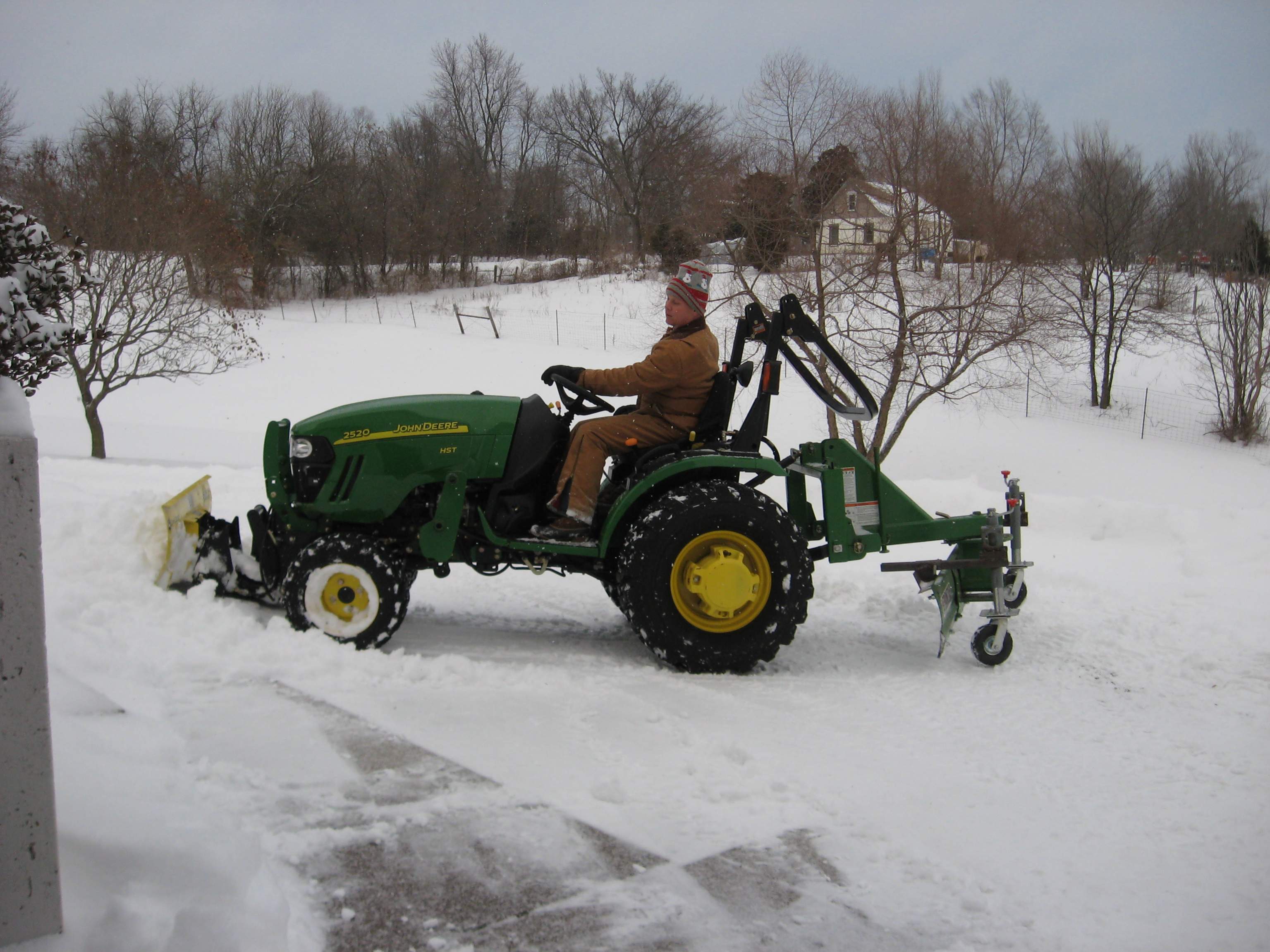

60 inch rear blade (plus 360 lbs of wheel weights) wasn't enough weight for my 2520 pushing 12 inches of snow. Weight box with 800+ lbs solved the problem.

I have never seen a rear blade, or any other type of 3 point attachment fitted with a pair of trailer tongue jacks and wheels...would you please tell us the purpose of those? Thanks.
   / Weight box or rear blade? #18
"I have never seen a rear blade, or any other type of 3 point attachment fitted with a pair of trailer tongue jacks and wheels...would you please tell us the purpose of those? Thanks. "
They are gauge wheels used to hold the blade off the gravel so it doesn't dig in when plowing snow. Also good for grading dirt/gravel when you want to keep a constant level without digging in.
If you search "gauge wheels" on this site, you'll find lots of people have built them for rear blades, rakes and box blades.

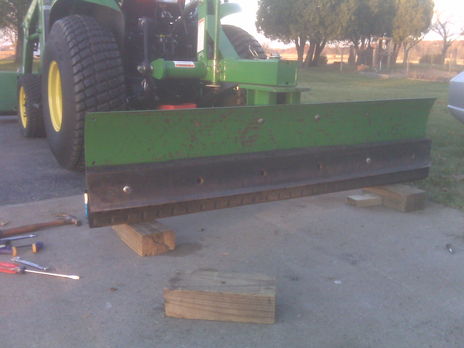

Thanks...I use my RB on a lot of gravel driveways but I installed a length of truck tire recap the width of the blade to prevent gouging or digging in, it was really cheap compared to the first class assemblies you installed. The road gator was free, the six bolts to install it were $3.

I like that work with the recap. I've always wondered how well a guy could use some flat rubber belting on a blade. I saw a tread on the side of the road the other day and almost stopped to retrieve it. I might have to go back that way again and look for that cap.
Was it difficult to take the curl out of the tread to get it bolted on the blade? How well does it wear?
