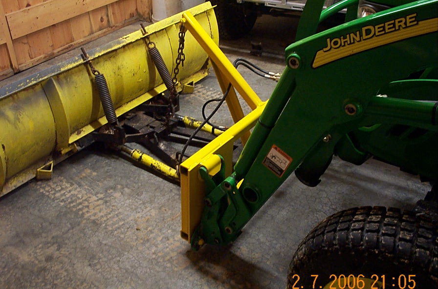

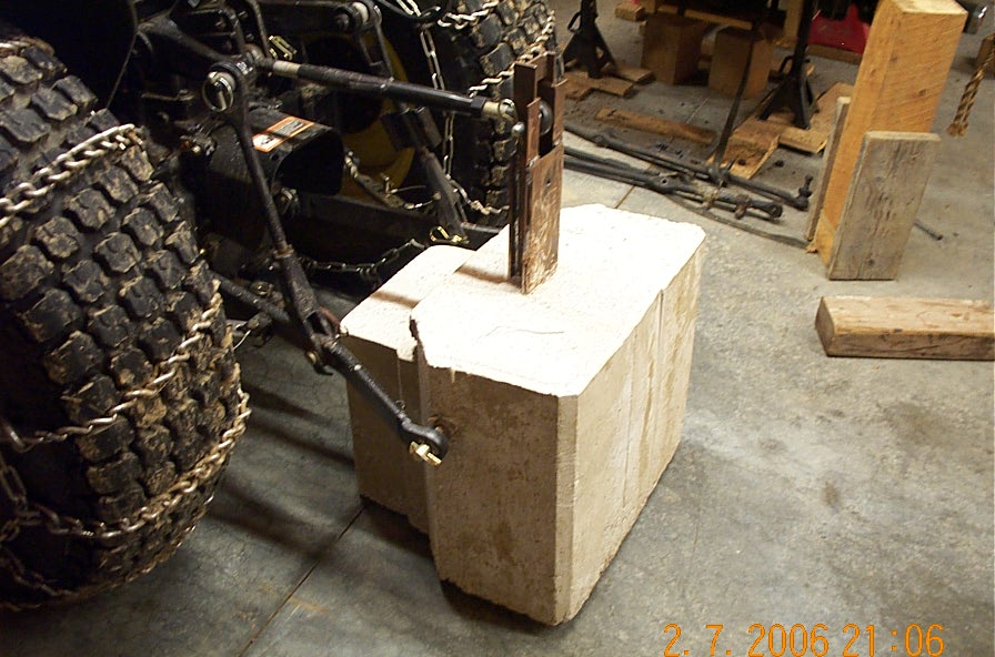

My two cents- my 3320 with 300CX has Turfs, rear chains, oil filled tires and concrete weight block that I made-figure its in the 500/600 pd range. OH- and I made a quick change front mt that hasan old 6.5 ft Meyers with a power angler. Personal opinion but I would take the added weight of the ballast block vs a back blade. To pull snow away from doors I simply back blade with the plow in the straight position.
PS- 22" No'easter forecast for tomorrow night into Monday- will get a workout!
