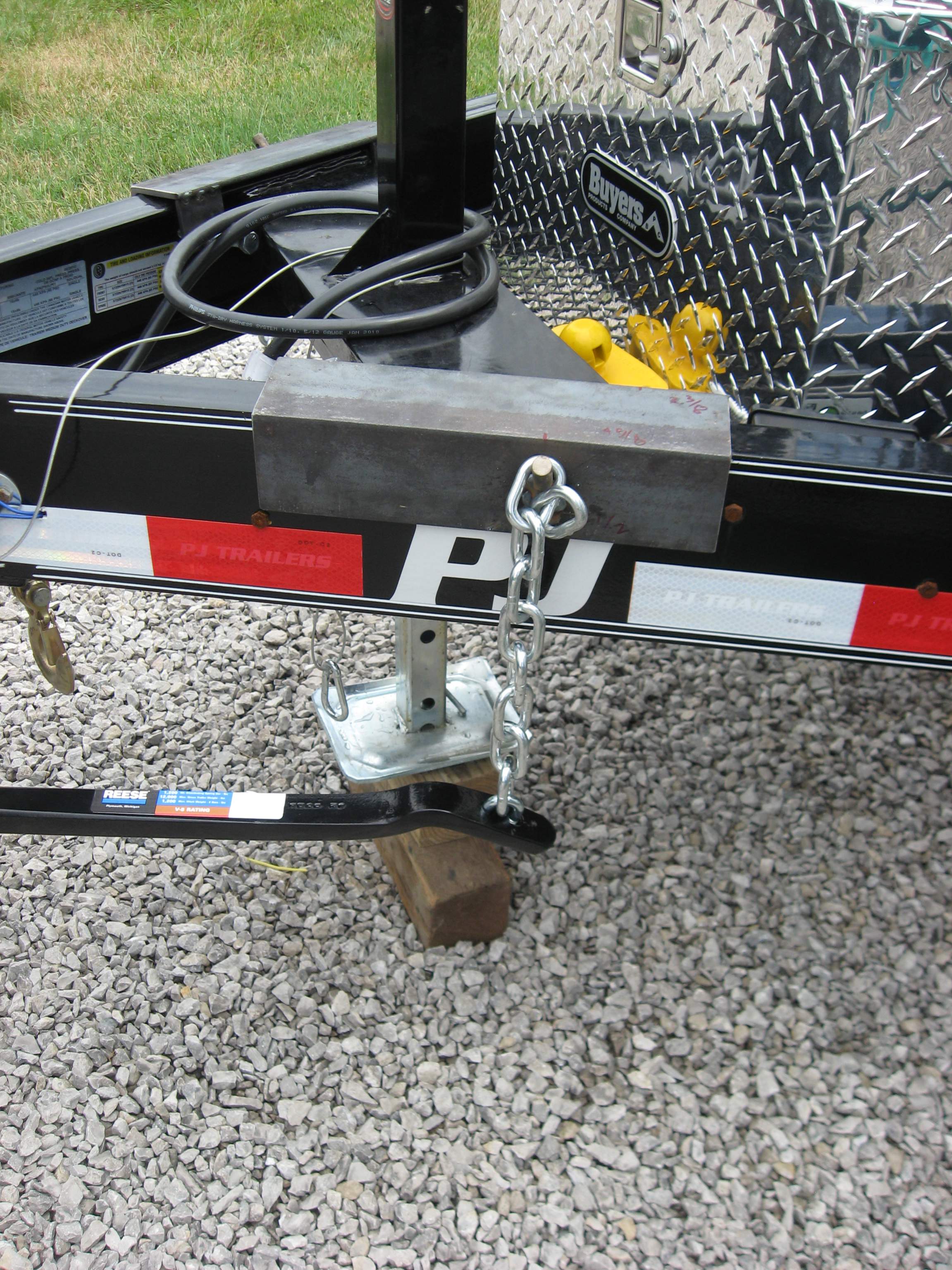

/ Weight Distribution Hitch Question #24
Yes. My PJ car hauler has a dovetail and slide in ramps and they work great.

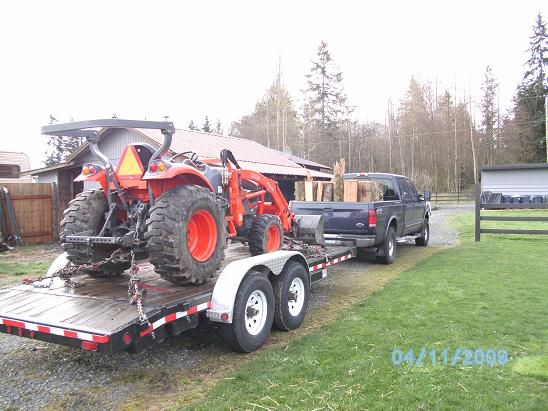

Sonewtrailerpics004[1].jpgnewtrailerpics003.jpgme photos of my 20 foot with 2 foot dove tail and slide in ramps. Also like the heavy duty tongue jack with spring loaded foot that raises/lowers by pulling a pin to allow the foot to drop to ground level rather than cranking it all the way up or down. Without the dove tail, it would make it have to load my backhoe with the short ramps that came with it as the angle is steep enough that the hoe drags the ground a bit when loading on driveway or level ground. Another foot would help but as long as I have a bit of slope, it works fine and I have loaded tractor and FEL without the ramps just use the FEL to tip the trailer and drive it on just like a tilt bed(trailer not hooked to truck)
