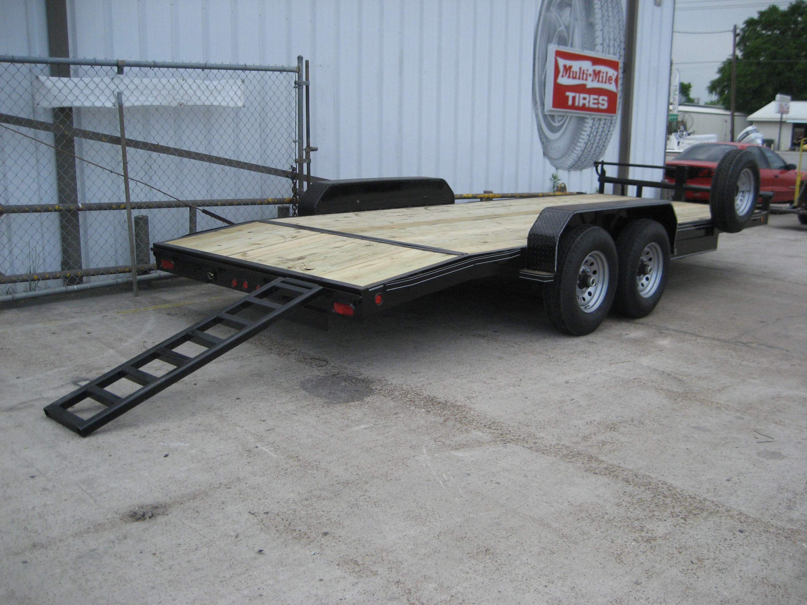

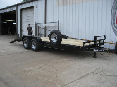

Yes, they slide in from the side.
Aaron Z
Depends on the length of the trailer. My 20 foot with dovetail slides in from the rear.
