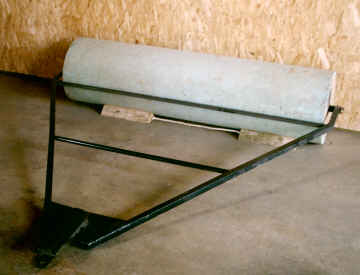

I built a 7' x 24" roller using 7/8" wall pvc pipe the city left laying around after a sewer project. The pipe alone weighs about 400#. It was in a friends field for 1 year after the project so he and I felt it was free for the taking. Its filled with 26 bags, I believe, of concrete. I know the thing is heavy. I built it with one side on and it standing up next to a tree. Had to carry all the concrete up a ladder in 5 gallon buckets. Its got 3/4" plywood sides and I used pipe for the spindle. I put grease fittings in it so I can give it a shot before use. I made the rest out of pipe and a old bed frame I had laying around. Total cost was about $60.
Chris
Yikes! I have one half that size and it weighs 1500#!
I believe it is 3,600# if I remember right. For the guys wondering about gravel it works great. It will actually crack some of the rocks. I also used it on my road after they patched the pot holes and it did a great job along with the August sun.
Chris
   / Weight Roller #18
Chris
How does yours pull Chris? 3600# is too much to lift even for my 68HP tractor.
